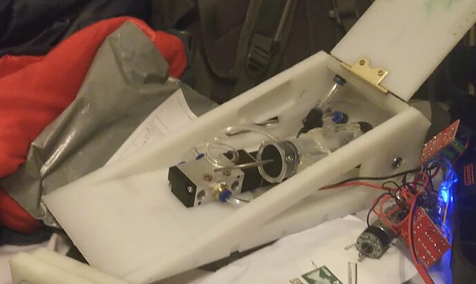

With the gas cylinder sorted, it was time to think about compressed air storage, and I would need A LOT. The downside of that large cylinder area and going for double-acting is that each flip would cost about 160ml of air. I spent forever trying to find some way of fitting a bottle inside the chassis without making the whole thing too big to ever make weight. Then another moment of inspiration. Bottles are light. So light that I could have more than one, and put them on the outside of the robot, using redundancy instead of armour.
A trip to the local bike shop furnished me with as many dead inner-tubes as I could carry. From these I salvaged the valves, which I fitted to the bases of some pop bottles liberated from the recycling and voila, I had my air storage.
The final pneumatic component was a 3/2 solenoid valve to control the gas cylinder. Surprisingly this only cost £10 on Amazon, bringing the total cost of my super-buget pneumatics system to maybe £40, including failed experiments.

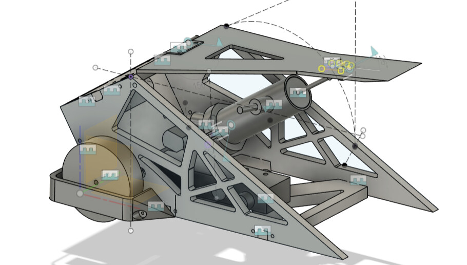

Finally, the chassis. Since I was optimising for yeet I wanted the maximum possible flipper arc to try to transfer the force from the gas cylinder over the biggest possible distance. This meant designing a very long wedge.
Being aware that this was getting large, I tried to make the bot as narrow as possible to keep the weight down. The result was this monstrosity.
Several hours of CAD later, I ordered some 10mm HDPE and booked a CNC induction at Exeter Fablab.
After much overthinking, and several pages of questionable trigonometry, I decided to go with a straightforward pivot-linkage between the cylinder and the flipper.
Time for a test-flip!
And there I was, I had a robot that could drive, flip and, to my delight and relief, self-right. Just a few tweaks and I would be ready to roll…
