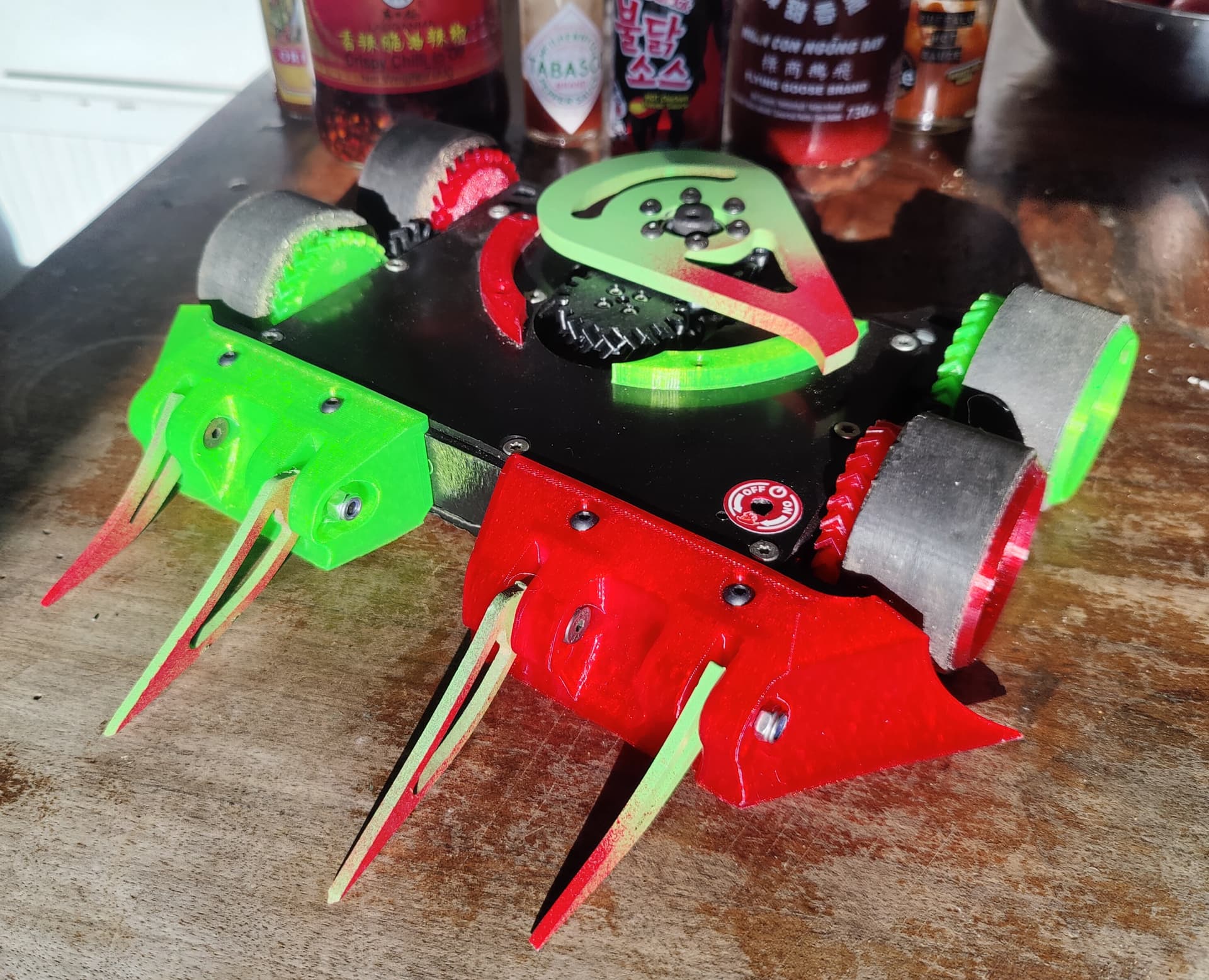

This first version of The Chilli Daddy. veered away from the initial sketch in a couple of ways. It became a cantilever design rather than a mid-cutter - I realised with my idea of getting under people prior to hitting them - that this would ensure more consistent hitting ability.
And the weapon and drive became gear driven rather than belt driven - couple of reasons for this. Firstly the most common teething issue I see for spinners is belt related so this side steps that. Secondly not many people seem to do it here in the UK on weapons at least(which is always a great reason to try things imho). And finally I really like gears - look how many I have on this robot ! :stuck_out_tongue:

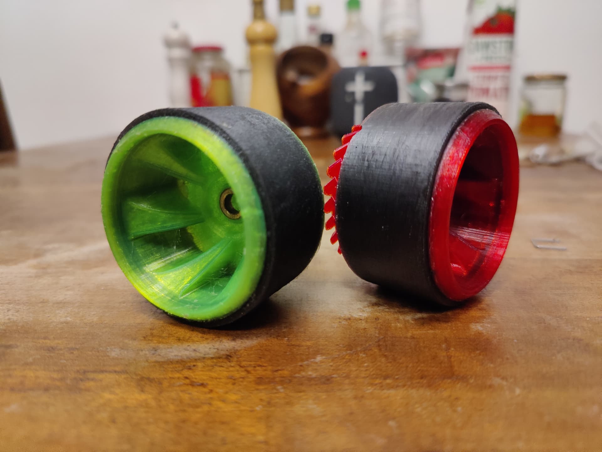

For my drive I’m running one 1806 diy rotalink conversion on each side. To the output I’m attaching a pololu mounting hub and bolting a printed gear to that.
Each wheel is a TPU printed hub with integrated double helical gears and cast PU tires running on oilite bushings on shoulder bolts.

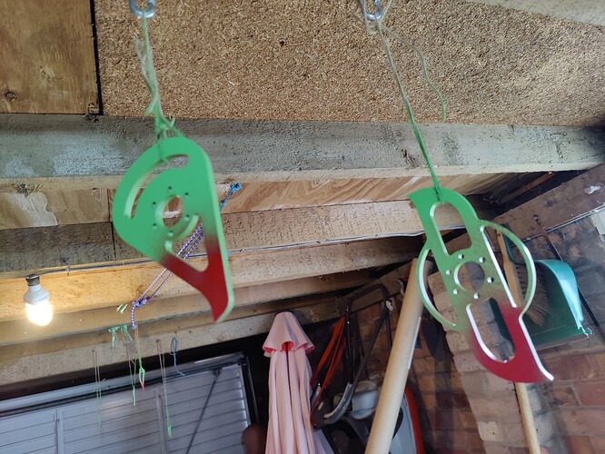

The Chilli Daddy uses a 6mm hardox weapon with an effective diameter of 165mm. Ive got a few options cut that range in mass from 220g to around 290g.
However to get into the US weight limit of 3lbs/1360g requires running the lightest of these, so the others will have to be reserved for UK outings post NHRL.
The weapon bolts through a printed double helical gear gear with six m4 bolts that then thread into an aluminum locking. It spins on the 8mm shoulder bolt shaft on two sets of skateboard bearings. The upper set sit snugly within the weapon it’s self while the lower set are recessed tightly into the lockring and gear.
I decided I didn’t want to risk simply running the shaft straight through the hdpe chassis. Concerned that the impacts might easily deform the soft HDPE on big hits. To reinforce it I’ve added aluminium top hat shaped inserts to each side. These then bolt together through the chassis with four m3 bolts. The m6/8mm shoulder bolt threads through the lower insert and finally a nut is added to lock the whole assembly.

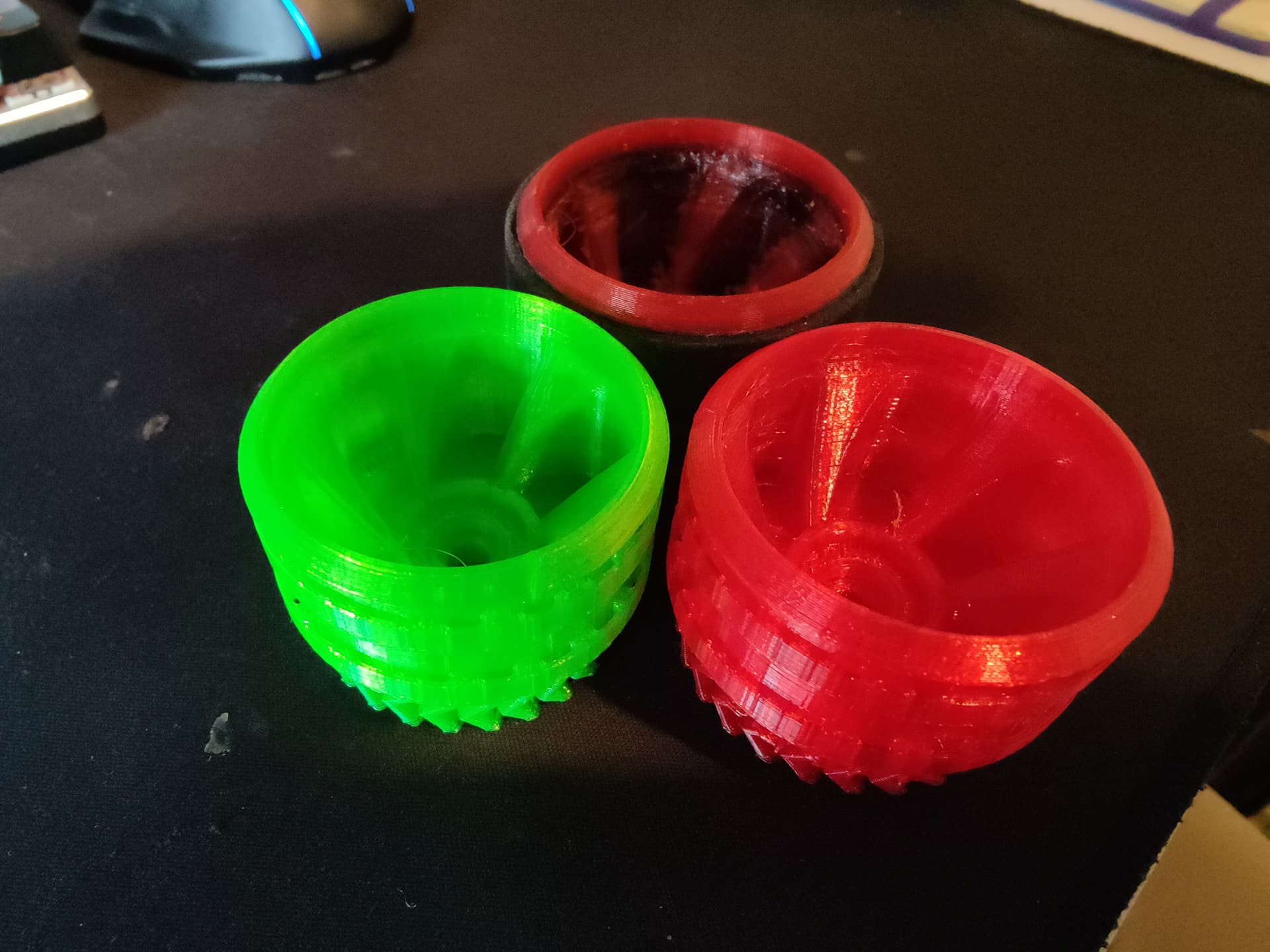

The gears I ran at brawl show no signs of wear after my two whiteboard fights, which was a big relief as that was certainly one of the bigger question marks going into this design. I didn’t experience any real weapon on weapon hits, so we’ll see how they fair with those kinda forces in the long run…
They’re fairly chunky - nearly 10mm thick with 2mm mod and double helical with a fairly extreme helix angle (which as I’m sure you know - puts more material across each tooth in the direction of load than a spur and spreads loads across multiple teeth). If I was starting again I’d probably consider going up further on the mod size for peace of mind - but not an easy thing to change at this point
They were printed in taulman bridge nylon for the motor gear and overture pa12 nylon for the weapon gear.
I do expect these to be fairly consumable however and do have spares.
Prior to brawl, I did attempt a test spin with some pla-st prototypes, which went comically badly resulting in very melty gears :joy:

So naturally this is where my attention has been focused recently and I’ve redesigned my weapon stack.
The nylon gear is no longer structural and instead just keys around a stack of 2d metal profiles. Aluminium spacers to hold the bearings and the middle retaining flange now being 3mm hardox.
Hopefully will be less inclined to fly off now :joy:

So I’ve updated my TPU fork mounts to now sandwich the TPU between the chassis and a Ali plate that runs between the mounting bolts to try and prevent the tpu pulling through:
For the forks I now have a shorter more aggressive option that are tailored specifically to the overhead weapon orientation (the long boi forks are usable when the bot is either way up). Old vs new comparison:

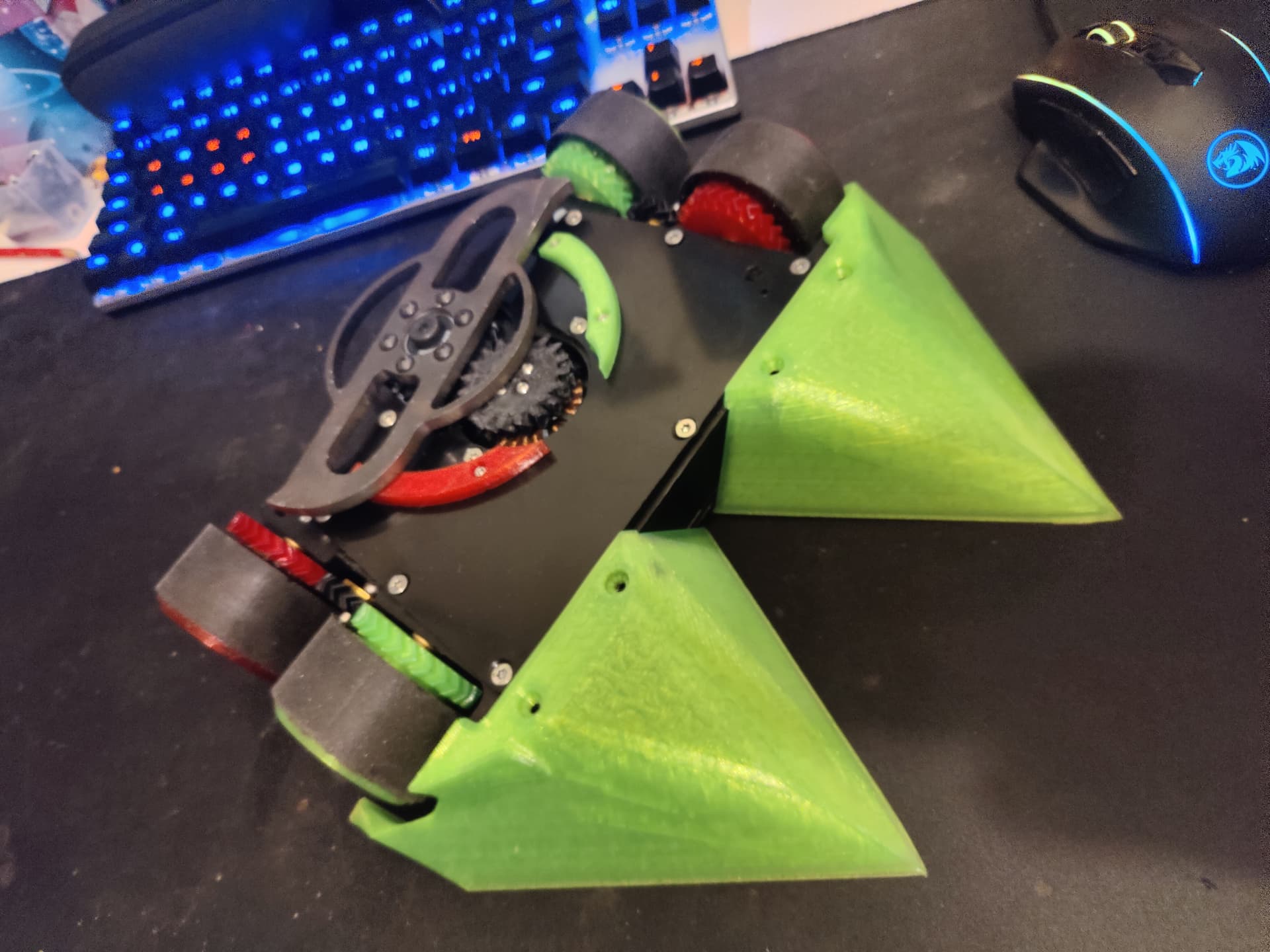

Being largely happy with how TCD works this wasn’t a huge redesign - mostly just doubling down on the idea of wheels as armour and improving the front end set up and using some of the extra weight we have to play with thanks to the 1.5kg limit (rather than being USA legal at 3lb).
I designed a set of double wide tubular wheels with a cool low profile racing tire vibe. The intention here have lots of flexible and ablative tire so they can get chewed up but still have continuous tire for driving.
Reworking the front end to add some TPU armour and using a set of Luchadors forks for the inner pair.
I also switched from my old symmetrical bar to a single tooth asymmetrical weapon. And dabbled with some paint for the first time.
The hope is that with a single tooth I might get a bit better engagement on people’s undersides/wheels
Knowing there were gonna be some hectic horizontals attending (Kult I’m looking at you :eyes: ) I started playing around with Anti-horizontal set ups. Having had good experiences with Luchador’s TPU pontoon set ups for this - I decided to try something similar and created this absurd triangle config. I didnt end getting to try it out however as I did not draw any HS’. :frowning:
