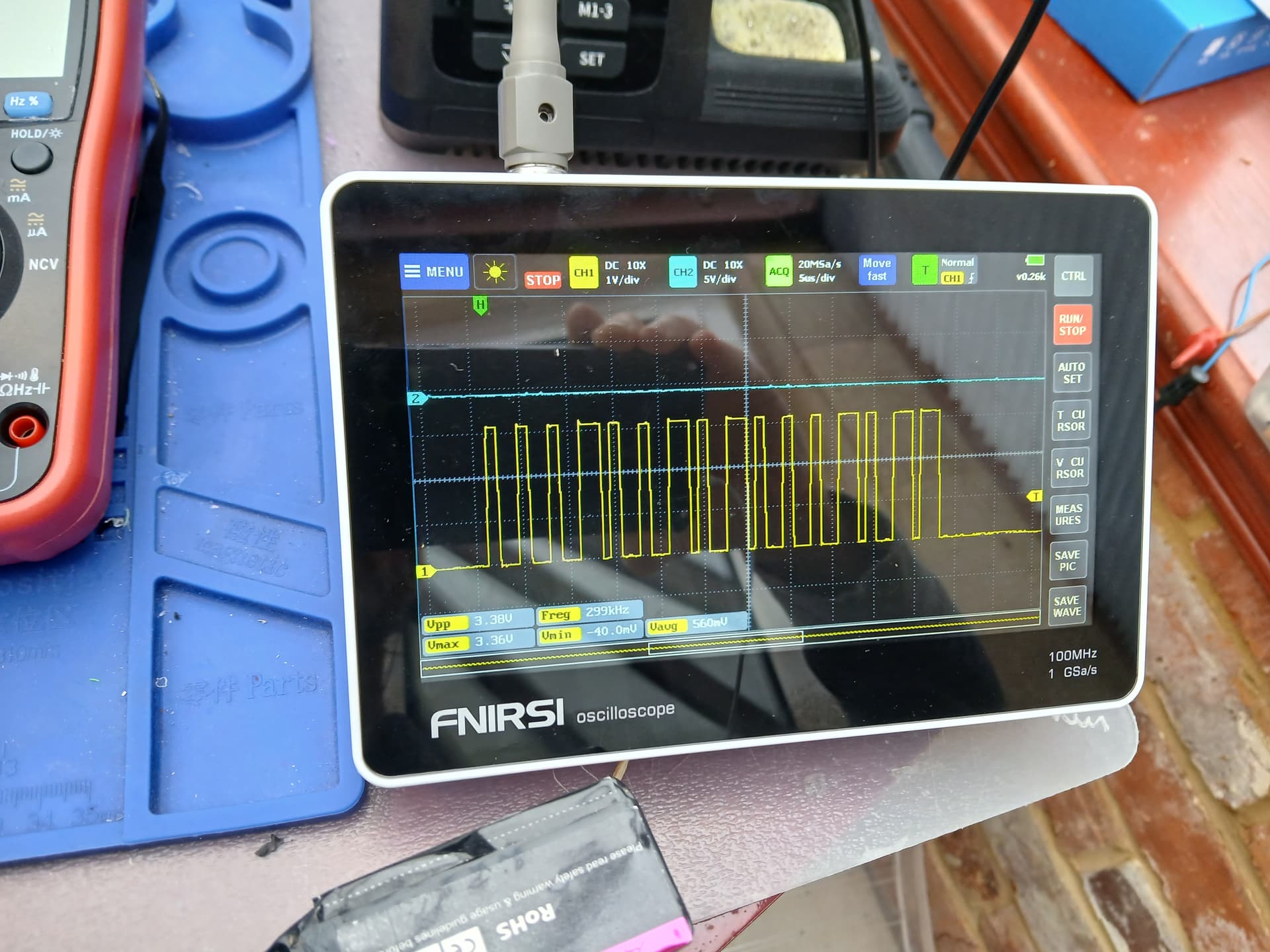

The Fnirsi 1013D is a 2-channel digital storage scope with internal battery and carrying handle.
I can honestly say, it doesn’t not work.
Pros:
- Actually measures waveforms
- Small and portable
- Internal battery means it is fully electrically isolated from the mains
- Touch screen is relatively good
- Time measurements seem accurate
- Comes with decent probes
Cons:
- Significantly exaggerated capabilities (bandwidth)
- Voltage measurement calibration seems to be all over the place
- UI in firmware is a bit janky e.g. triggering modes are not obvious
- Handle is a bit plasticy and falls off easily
- USB-C charger doesn’t do PD so a phone charger won’t work (a dumb charger is included which does work)
In general, I would recommend it if you just want to check a few waveforms. However, if you want to make proper measurements, a proper oscilloscope would be better.
