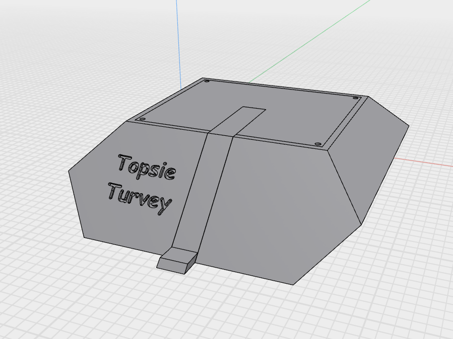

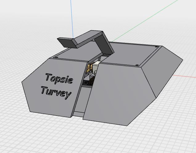

Right after several months of procrastination and the last week of banging my head on my keyboard, I present the MK3 and hopefully final design of Topsie. Changes I have Made:
  • Replaced Flipper Panel with a lifting Arm
  • Removed Ability to Invert so new lifting arm can self rite
  • Added Compartments for the receiver and lipo
  • Altered custom fitting for the Servo
  • Will be replacing Friction fitted hinge with an actual hinge for the lifting arm

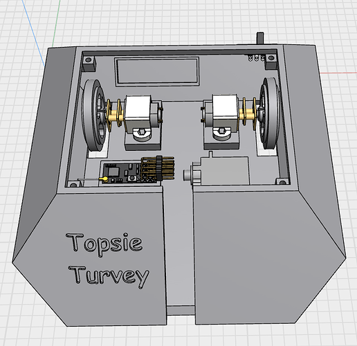

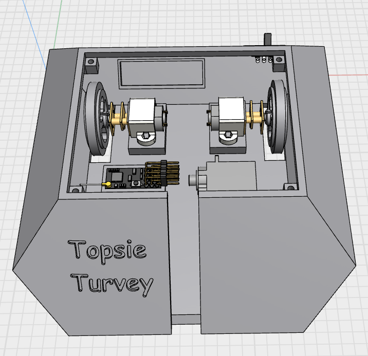

Now I’ve been staring at the Example for how to use a servo for the last 4 days and I still have no idea where to place the servo within the bot. I need it to lift high enough to self rite but I cant wrap my head around:
  • Placement of the Servo
  • Where to put ledge to attach the arm to the servo
  • How to design the mechanism itself
I’m sorry if these sound like stupid questions, but any help with how to actually get the flipper working, or at least get everything in the right place to get it working would be great.
I hope these sketches are mostly self explanatory.

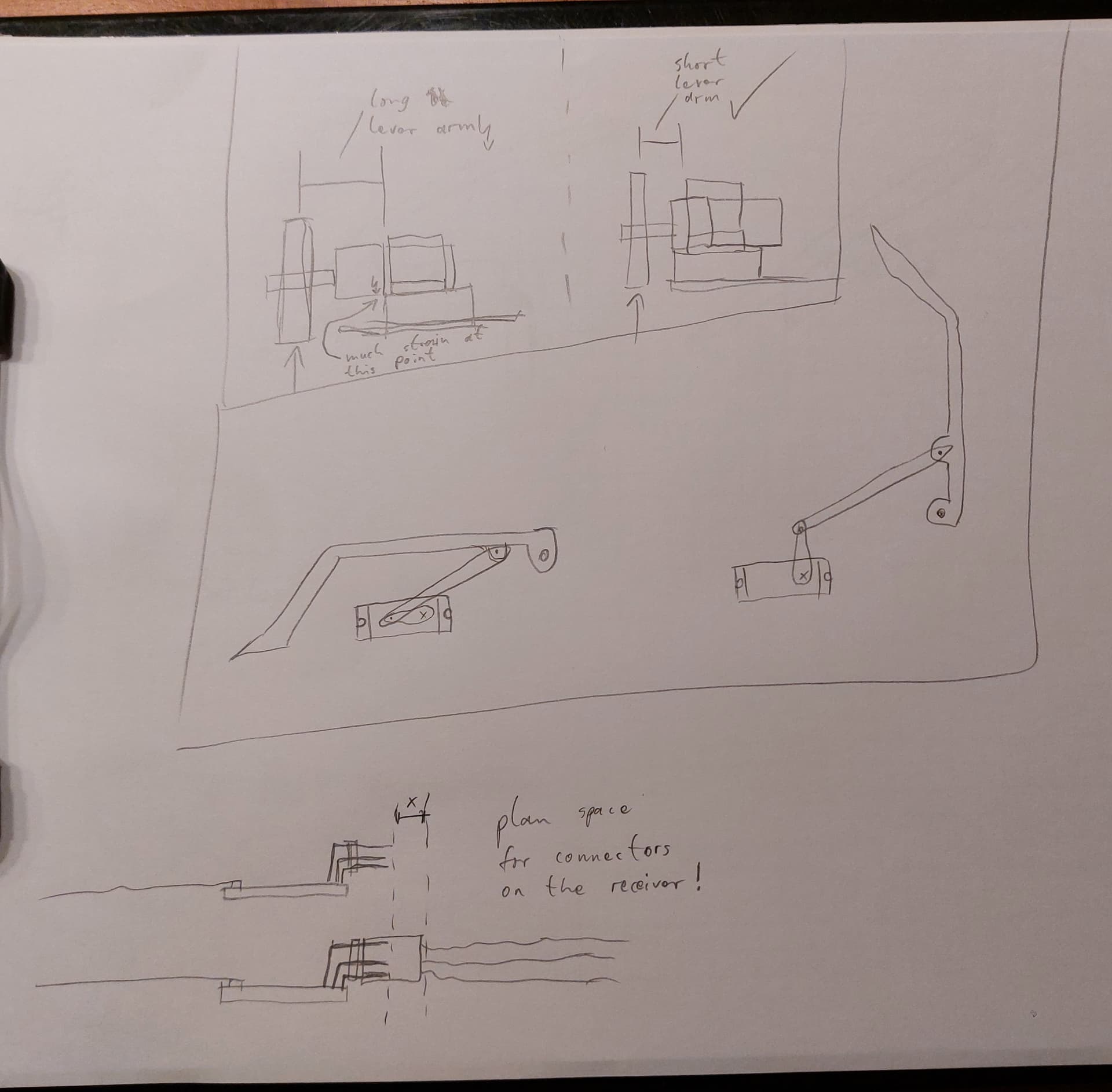

I recommend to place change the motor mounting so that the motors do not stick out of the mounts that much.
The way your receiver is placed, there is not enough space betwenn it and the servo. The connectors from the servo and the escs will beed some space.
And a rough proposal for a flipper link.
Amazing! That sketch makes all the sense I need. Thank you!

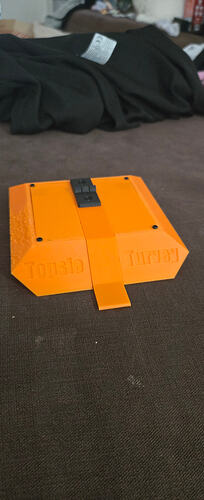

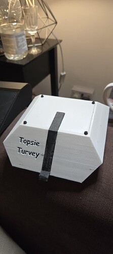

Okay so, after a long while I finally have my 3d printer and finally printed a prototype of Topsie woohoo!
However 2 massively glaring issues:
  1. The Shell/Chassis despite being within size regulation is alot larger than alot of other antweights ive seen. This leads into issue 2.
  2. For just being the shell and flipping arm its quite weighty and im pretty sure she’ll be overweight with all the electronics in.
A third issue I found is that she is quite difficult to assemble. This is probably down to the shape and the fact that the only access to the internals is that top plate. The inside is quite a large cavity so such a small access point will mean fitting every thing will be difficult.
This means im going to nees to make the following revisions:
  1. Thin the armour out
  2. Condense the Design so electronics are more snug
  3. With a smaller design, extend the base of the flipping arm
  4. Split the bot into 3 pieces. Base, Main Body, Top Plate
Well looks like I gotta get back to work. Any more feedback is welcome!

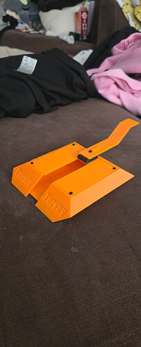

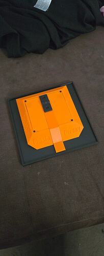

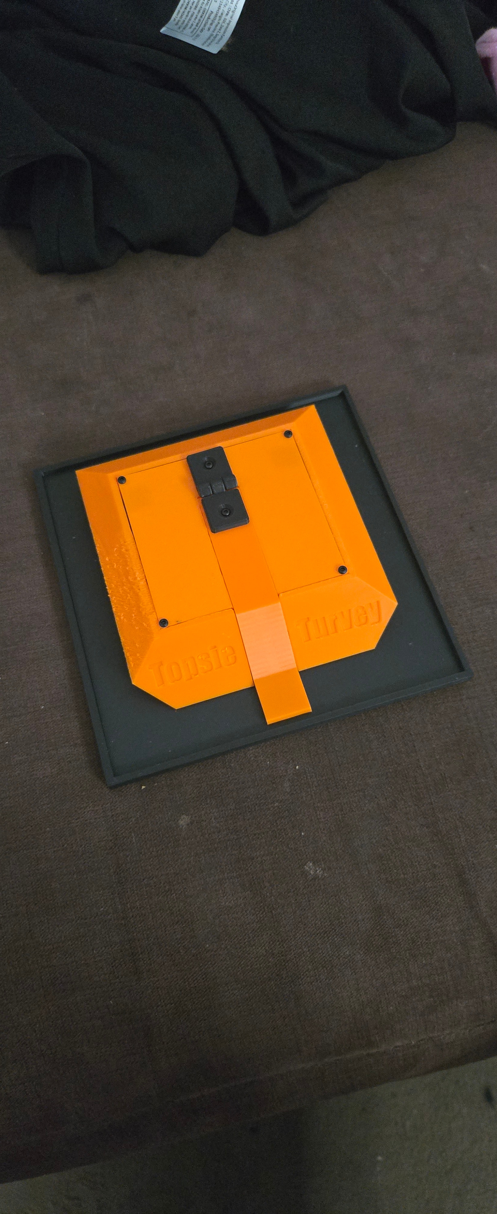

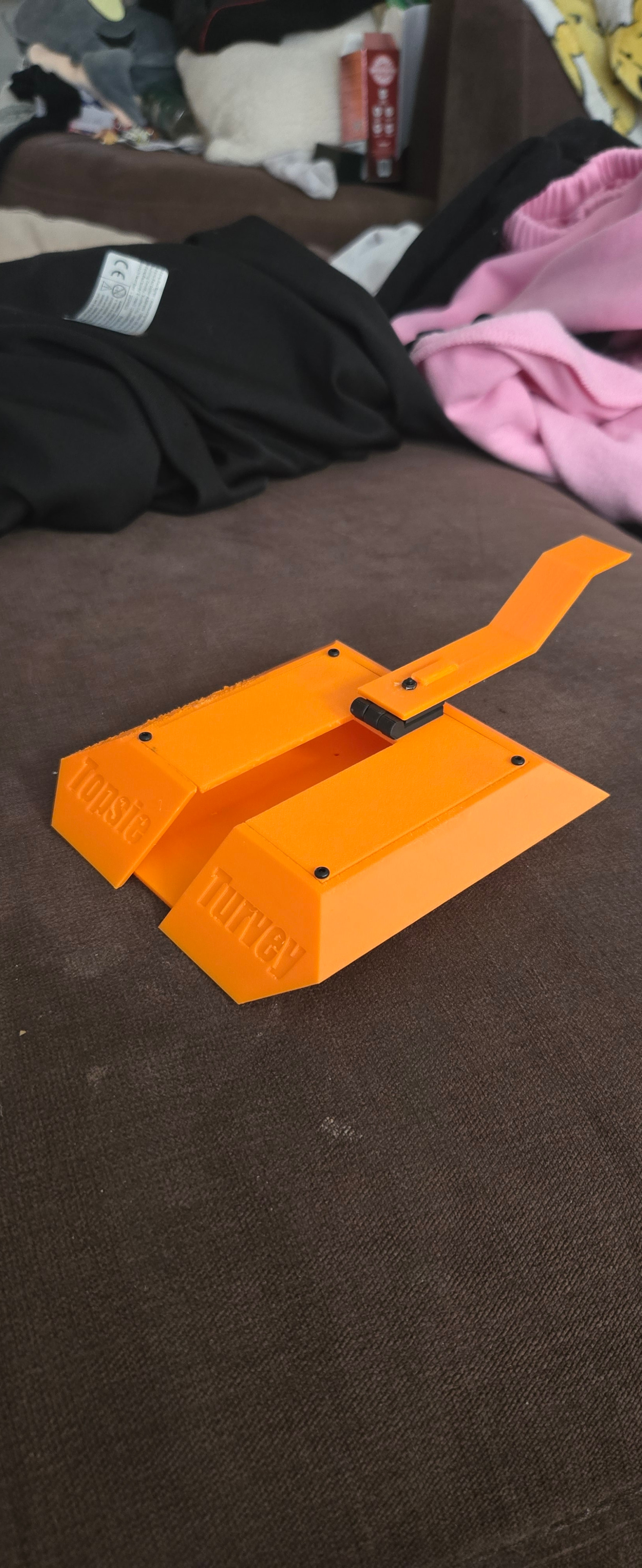

Revisions Made and Topsie is now:
  1. Smaller but large enough to hold all the electronics
  2. Thinner Armour
  3. Lighter
  4. Split into 3 different parts (so much easier to build)
  5. Wider Lifting Arm
  6. Longer plate to get under other bots on the lifting arm
  7. Moved the switch hole to the base
  8. Changed to text on front face and bottom plate
  9. Changed wheel type to the 22m wheels
There are still some small measurment adjustments i need to make but nothing overly important. Just need to get xmas out the way then Ill be buying all the electronics, print the first true Topsie and then its fighting time!
