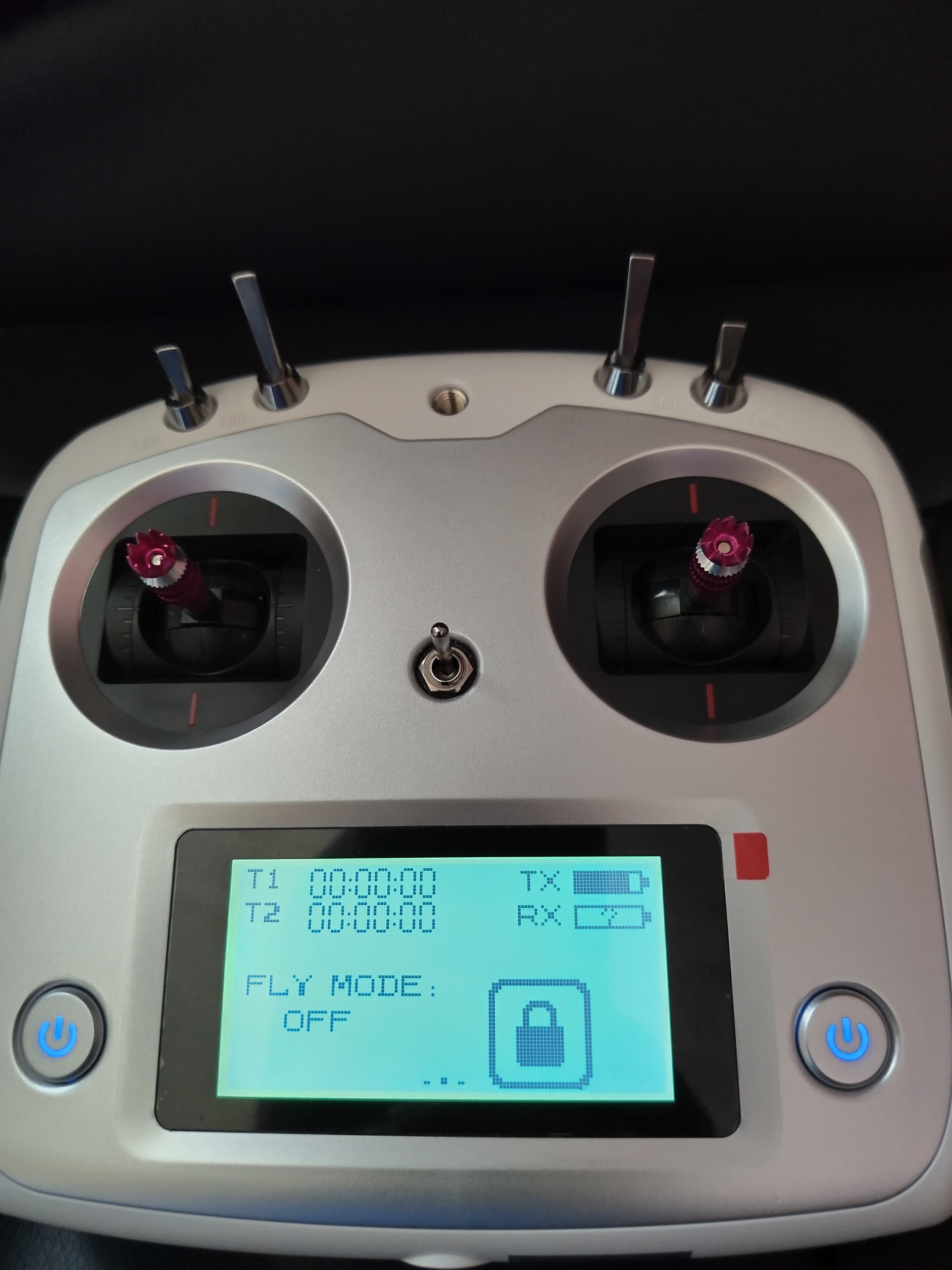

Hi all,

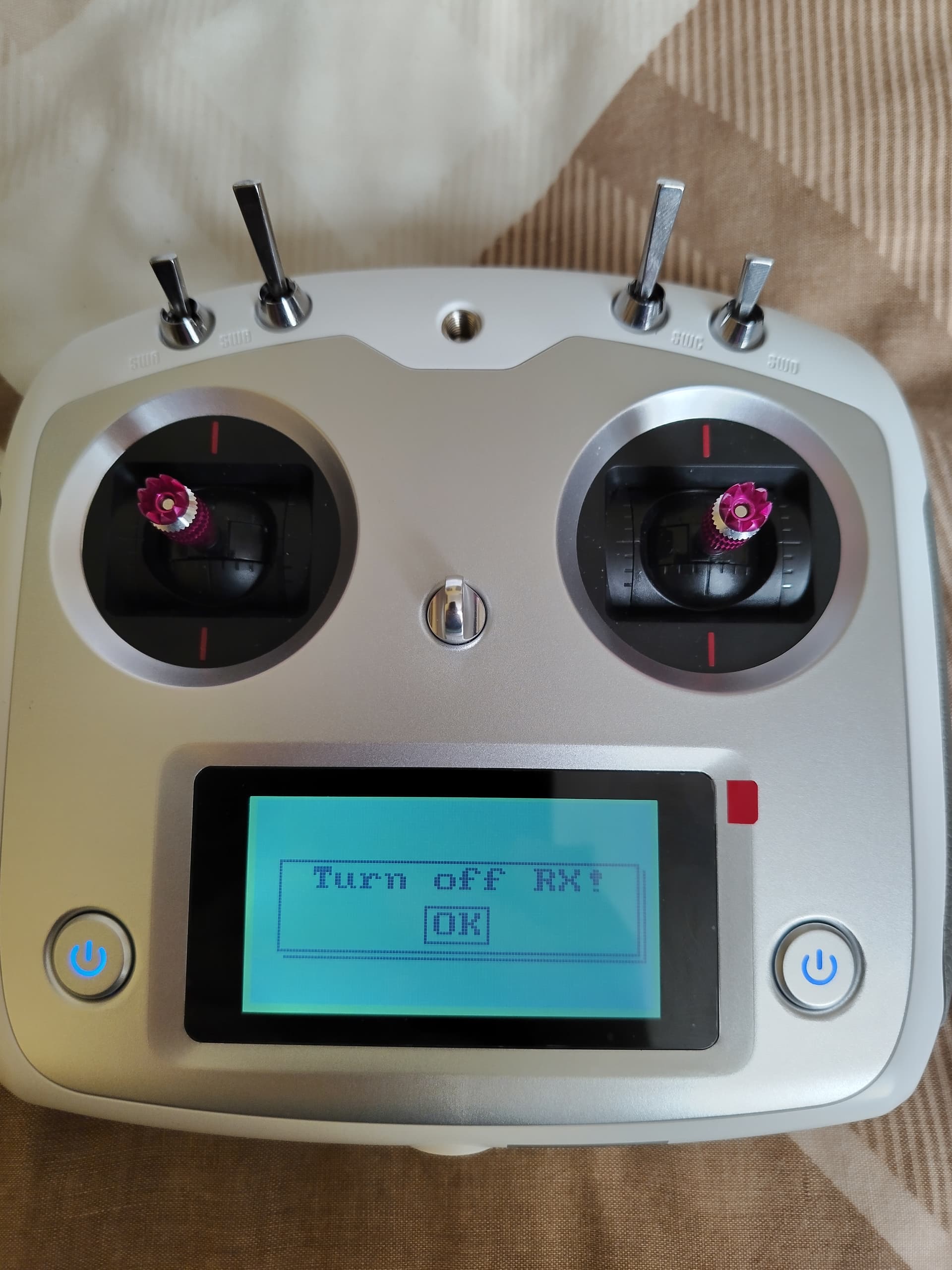

I recently purchased a new transmitter, the Flysky FS-i6S, because I wanted a transmitter with both sticks self centered, and that would work with all my Flysky receivers. However, it seems absolutely useless for failsafing, as it won’t allow you to turn off the transmitter without first turning off the receiver! An absolutely bizarre feature that you can’t turn off.
I have tested it by removing the battery and the receiver still fail-safes as it does with the FS-i6. Would it be within the rules to modify the transmitter to have an emergency off switch installed, that cuts all power like the FS-i6? I know roboteers used to build their own control gear back in the day so I figured it would be okay, but wanted to check with current EO’s and tech checkers.

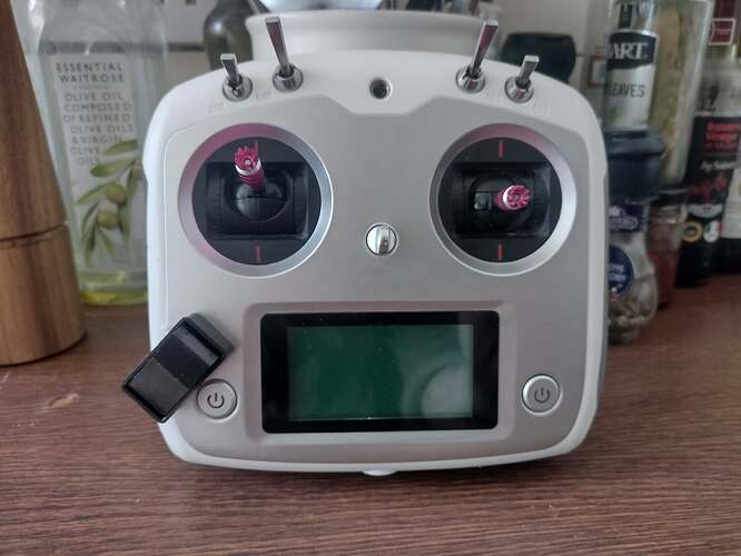

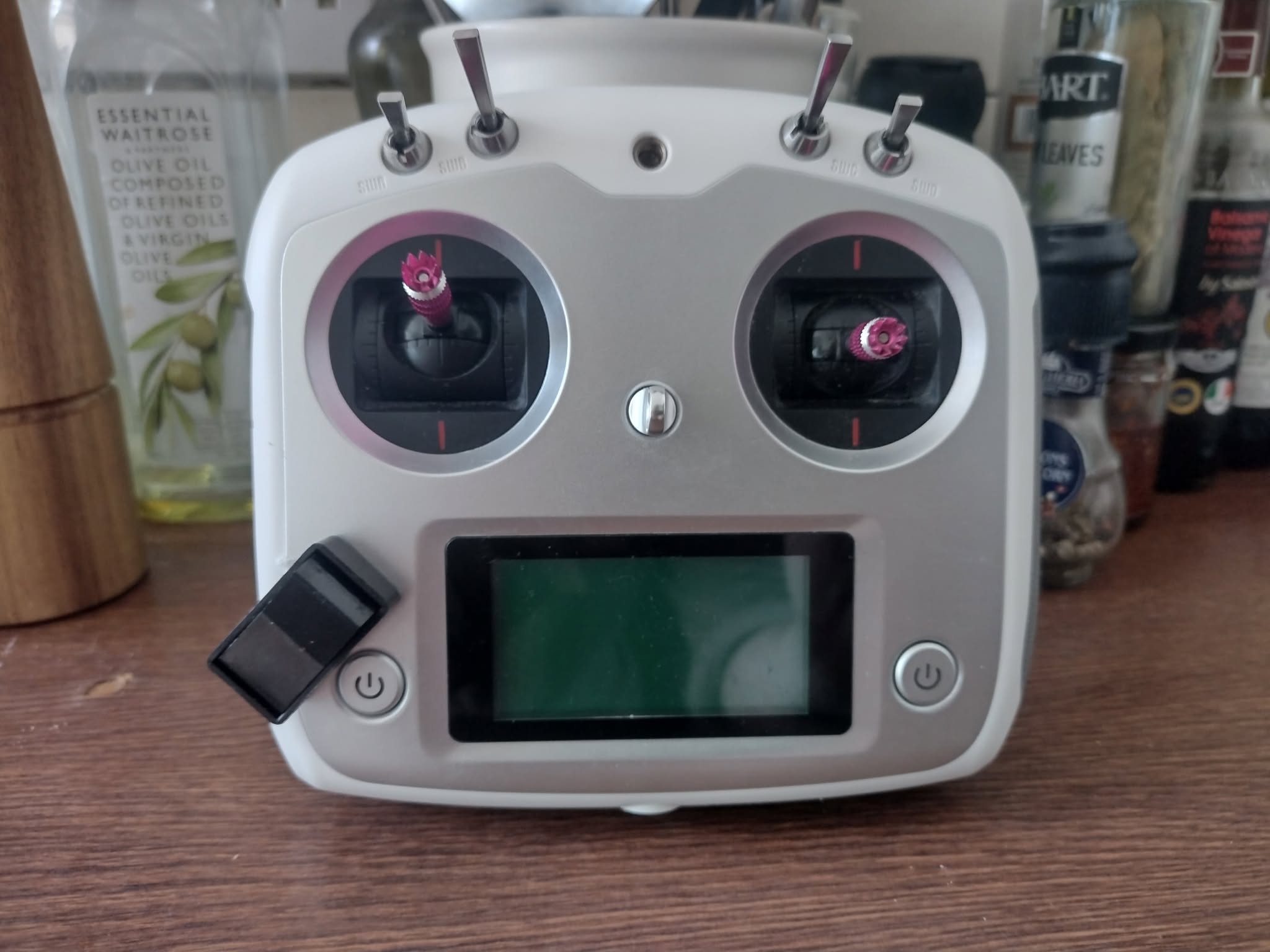

For future reference, here’s how I’ve modified it for the power switch: I’ve kept it as original as possible by fitting a switch where you’d normally clip on your lanyard, as we’re not flying drones or planes outside for ages I don’t think it’s a big loss. A couple of 3D printed washers later and I think it looks pretty neat :slight_smile:
Why didn’t I think of that…
very tidy - really nice implementation
