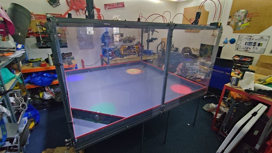

We use 4mm thick 400 grade hardox (also called AR400) for our beetle arena’s kickers - 100mm tall
We’ve done 6 events with it so far and they’re holding up great, but bear in mind the UK is a little less KE orientated than the US - but we’ve still had plenty of big horizontals smacking it etc!

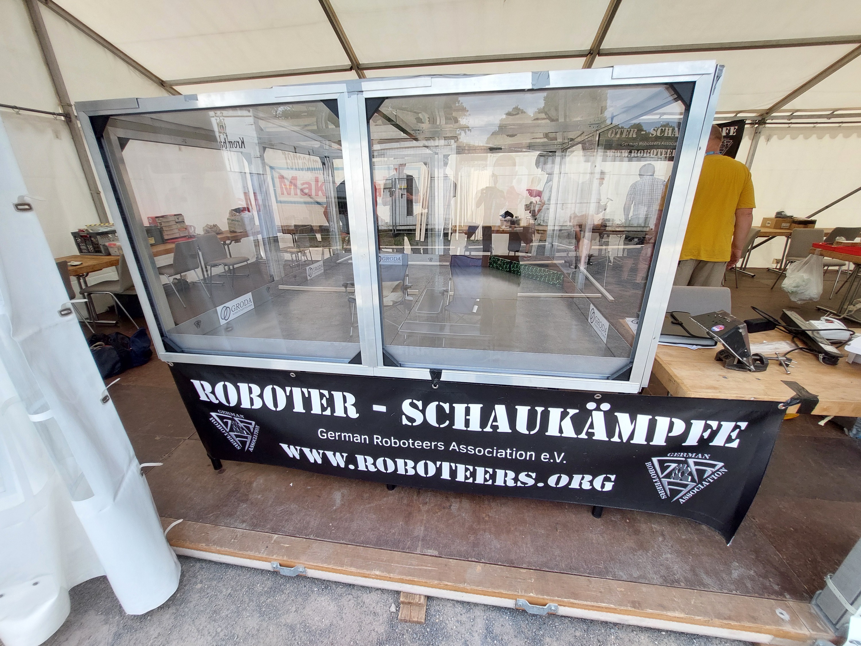

In Germany we use 3.2mm Hardox 450 about 10~15 cm high.
And we have a limit of 1kJ kinetic energy for spinners. Not only due to saftey but also maintenance costs.
