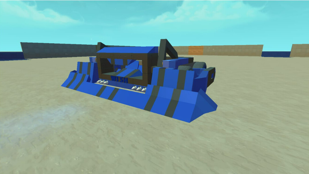

Ello Ello, With Rapture comming up, i feel i should probably introduce the bot thats comming, Wishbone!

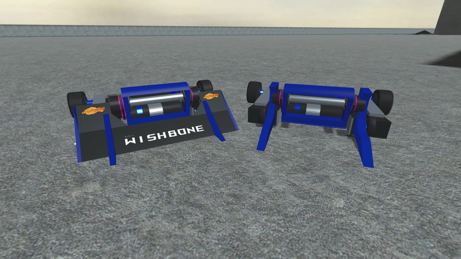

Wishbone was made first in Scrap Mechanic, where it usually did well. but later it became more famous for its Garry’s mod counterpart which competed in Bashbots! (you can see a fight of it here!)

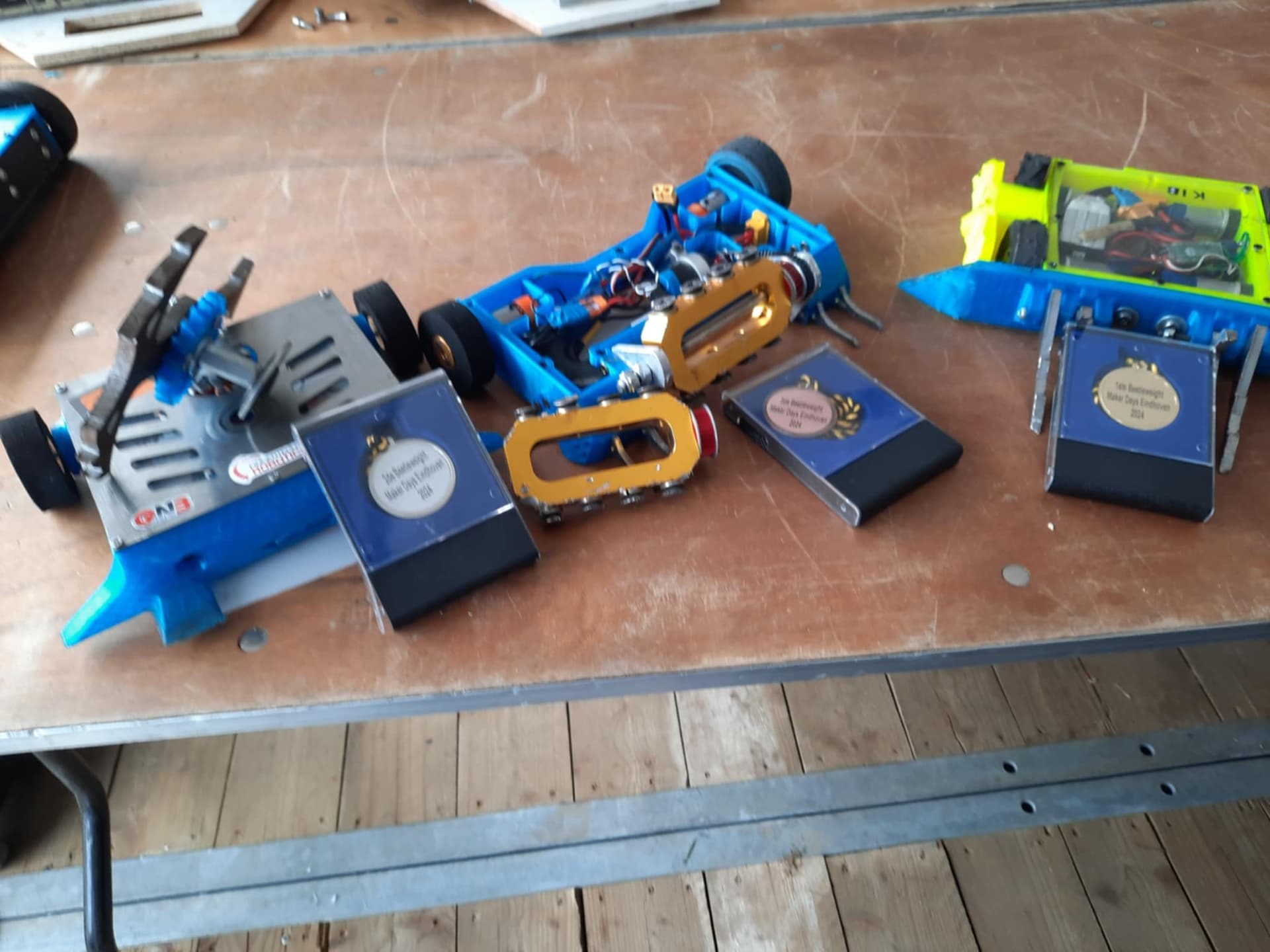

1. Designing and building this man

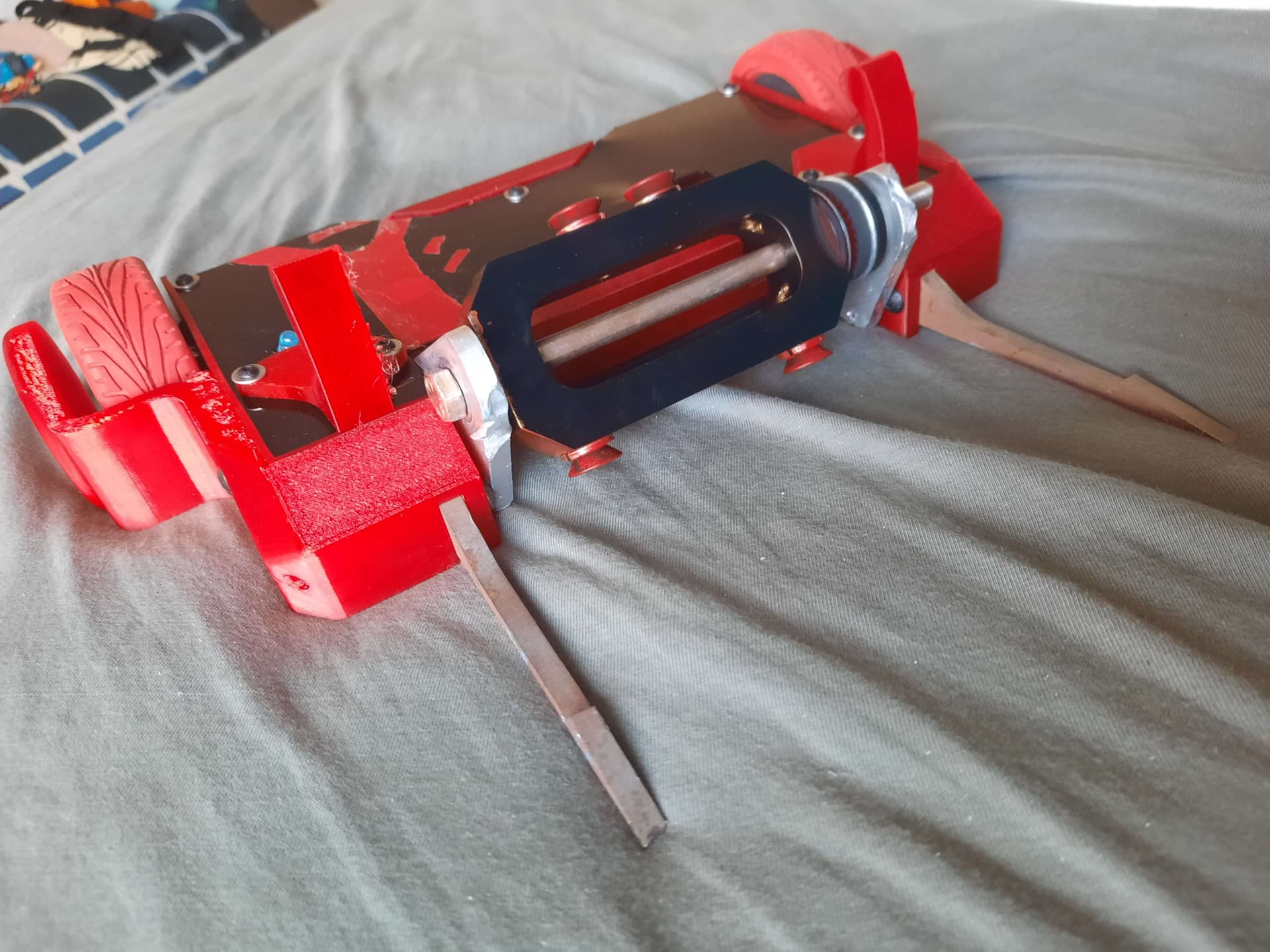

I was looking at the fingertech egg beater kit, and was like. you know, maybe wishbone can use one of these. and instead of going for the usual design of them, i wanted to go a little more unique. for drive i slapped in some Ranglebox MARS brushless motors, since they worked well in Bert (bert mentioned). the rest is my usual stuff. tpu sandwich design. 4mm HPDE on the bottom and some fancy Ti like 1.6mm on top gifted by the ever wonderful Maddox.
The main design key i kept from the game one was the chonky twin wedges at the front. these could take an hs or feed robots nicely into the weapon for the chonky hit. also made some small fork setup to really get all the weapon into the opponent.

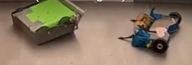

Fight 1: Wishbone VS It Is WEDGEDAY my DUDES
Wedgeday is a box with an alu wedge. its a brick, but also a nice first gentle fight for Wishbone to bite into
Nibble
Match starts, i go in, i do a lil nom, then a way bigger nom, sadly didnt hit the roof
, but was a small oh damn moment. then i got a nice bite and flipped it over. did ask if he wanted to keep going, but he has 0 top armour basically so was scared for the lipo to go poof.

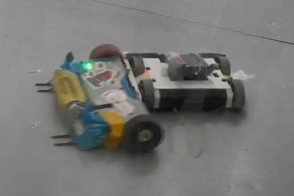

After getting bodied by ernie, it was still running, but without any weaponry. so again a nice box to kick, only issue being, this one wouldnt die!! and after a little while, the teeth started to back out, since i hadnt tightend them after each fight.
Damn wouldve loved to have discovered Loctite sooner
then it became a pushing match, which ofcourse, 2x Mars’ will do well (not sponsored (but wouldnt mind it wink wink))
Who knew ernie and wishbone could do the same pushing
In the end, i won the judges, but it was concerning.

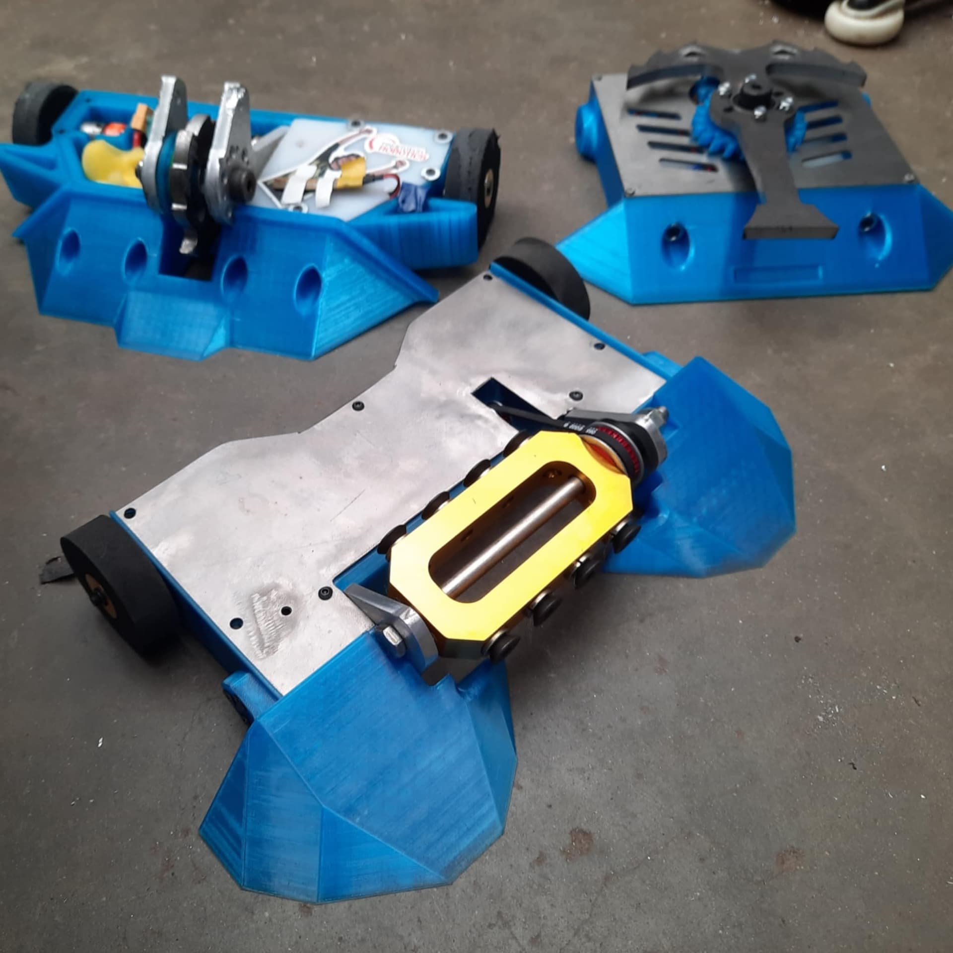

Ofcourse, i again brought too much for eindhoven, so i had much to work on and with.

After this fight, i put it aside, since i didnt wanna look at it. and the next day we got there nice and early, and i totally rebuild wishbone again from the ground up, tightend everything, new beater, new rubber wheels to help with grip. and just a whole lookover.

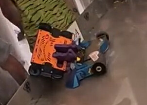

this poor man got day 1 destroyed by ernie, and now had to fight Wishbone. he did get the chance to cast some new wheels, sadly, i had a big wheel remover on the front and took one of them. then he flipped over and was dead.
WHEEEEEELS!!!
sometimes you just have a fight that captures the essence of your bot, what you want it to do. and this is one of em. simple rush, wheels, hitting, big knocks. i love it. this, this is wishbone to the core.

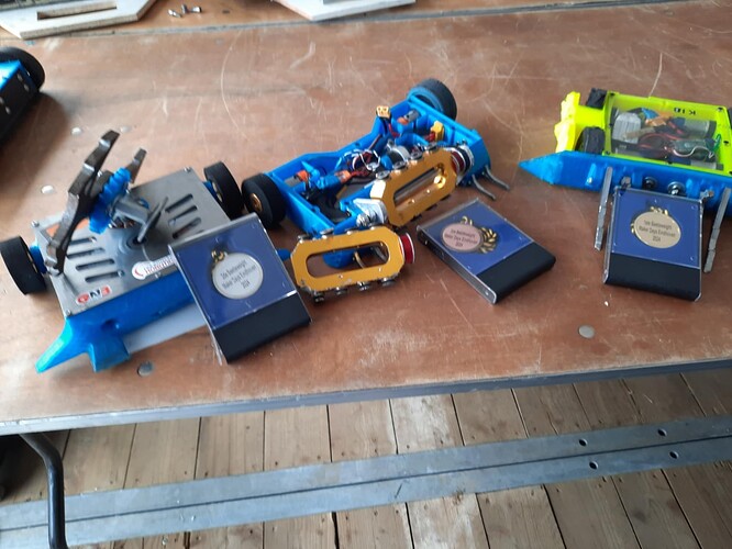

Here at Migraine Robotics, we reuse pics

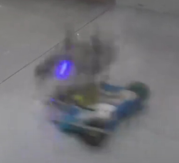

Fight 4: Wishbone VS Trouble Double
again, this is what its meant to do, attack, attack, attack. be all over the opponent and pop it up. he had a very exposed link on top, which after a bit i sniped.
Blur moment
Over here we LOVE sparks!!!
Other fights went also good, except fight 1 and fight 5. fight 1 my magnets were touching the floor, so it went boom… and fight 5, the only non loctite bolt came out, which held in the weapon motor, but still won the jd!
