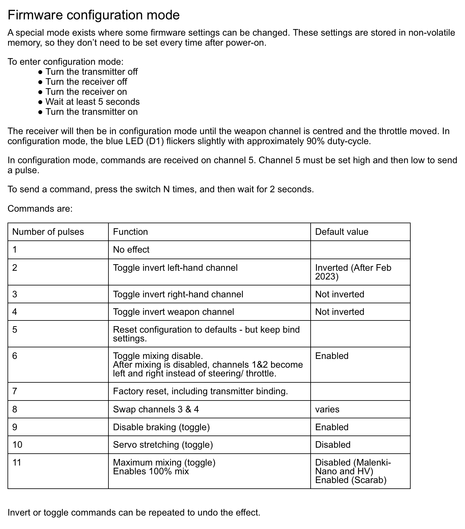

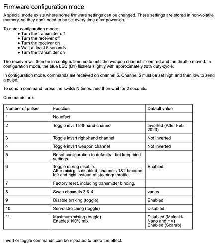

I believe the Malenki Nano is set up to do 50% mix on the steering by default, have you tried setting it to the maximum 100% (number 11 on the list)
I hadn’t, I’d only turned it off (6). Don’t know how I didn’t see that one, worth a go

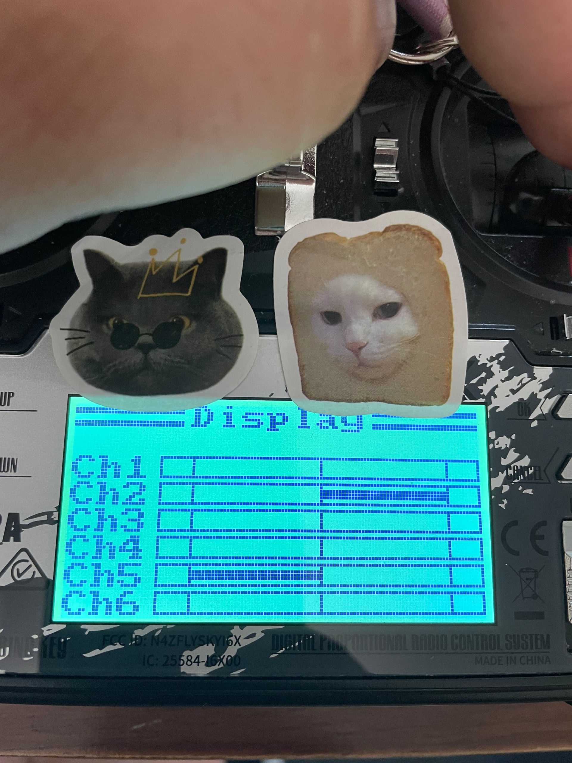

What does it show in full reverse? Do you have a couple of servos you can plug into a receiver on channels 1 and 2?
Full reverse looks like so.

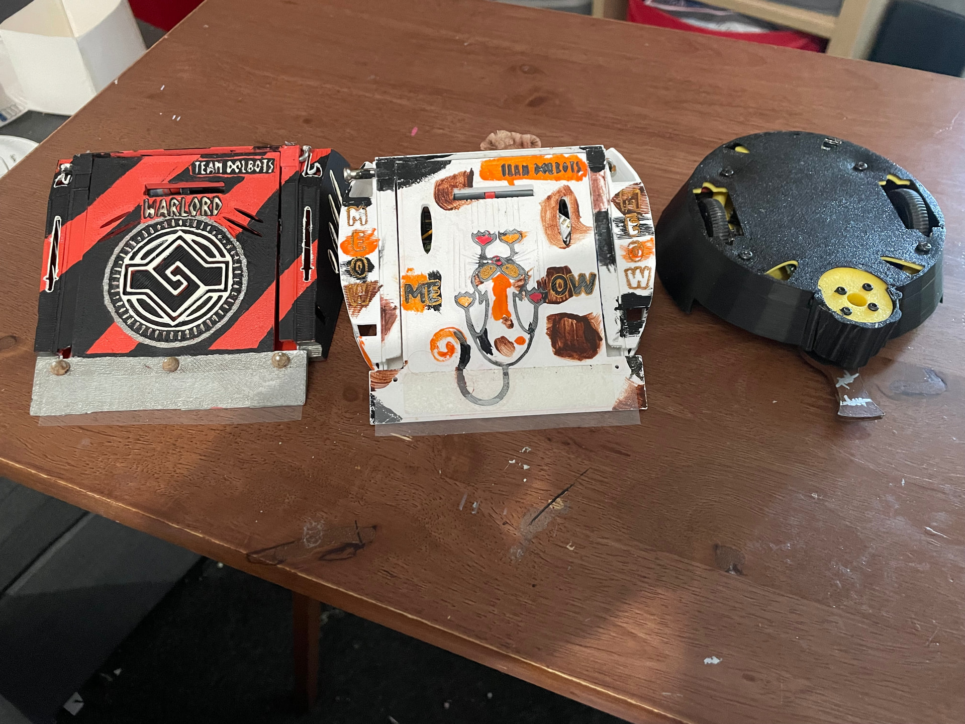

Ok, I’m going to lay out data for anyone who fancies reading this, in hoping that the scientific method helps. Three robots, how they drive, and the components they have/have had. I’ll also list two other robots.
Worth noticing that the robots with steering problems have had these problems with any of the components they have used.
________
Warlord:
Forward: Right motor kicks in first. Incredibly slight right pull to drive.
Reverse: Right motor kicks in first. Reverses to the left.
Using parts:
Flysky fs-i6x (a)
Malenki nano
N10 600rpm motors (from BBB)
PTK 9497 servo
Giant power 120mah lipo
22mm wheels
Has used:
BBB ESC
Flysky 4 channel receiver
Giant power 250 and 200 mah lipos
25mm wheels
_______
MEOW:
Forward: Right motor kicks in first. Light right pull to drive.
Reverse: Right motor kicks in first. Reverses to the left. Will end up in a full spin if held.
Using parts:
Flysky fs-i6x (b)
Malenki nano
PTK 9497 servo
25mm wheels
Has used:
N20 1000rpm motors
BBB ESC
Giant power 250mAh lipo
22mm wheels
______
Cactus Whack:
Forward: Right motor kicks in slightly first. Drives acceptably straight
Reverse: Right motor kicks in first. Drives acceptably straight.
Using parts:
Flysky Fs-i6x (a)
Malenki nano
BBB brushless esc
N10 100rpm motors
Flash hobby brushless motor
Giant power 200mah battery
34mm wheels
_______
Not pictured:
Shellraiser:
Same symptoms and parts as MEOW, but was never upgraded to a Malenki Nano
Wedge Antilles:
Same as Shellraiser
