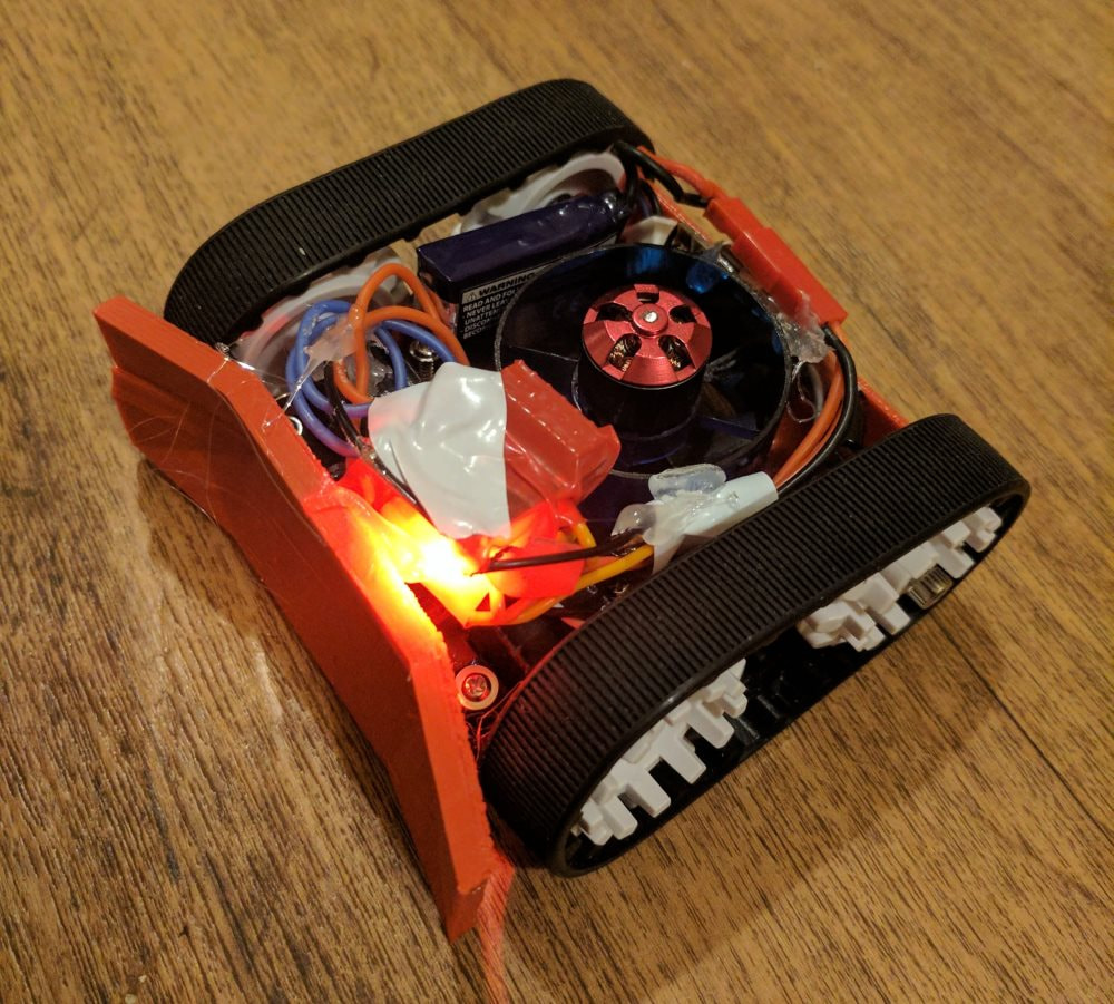

People have been using EDF fans for downforce forever in antweights. I’ve tried it personally (back in 2017)
The issue I had with off the shelf fans are quite fragile so if they suck up arena detritus they can shatter quite easily.

Stolen Of Approval :frowning:
How did you cram all that in there!?
