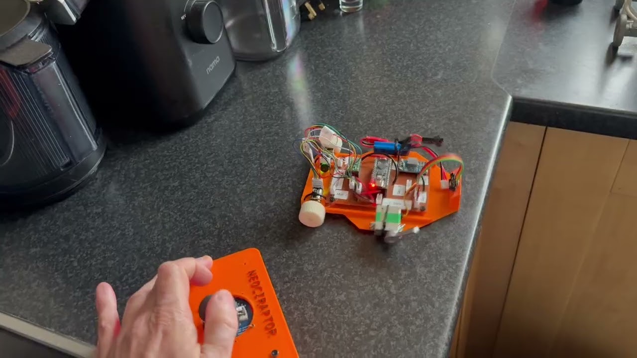

I have a quick question to the community before I spend more time on this idea. From what I understand autonomous pit avoidance globally feels like grey area, but regardless of the rules, what is your opinion about a bot that could sense the pit and automatically stop so you don’t accidentally drive into one? Playing fair makes this hobby much more interesting so I would really appreciate everyone’s opinion.
Just for context, someone asked about autonomous battle bots couple of weeks ago and I mentioned I was thinking about pit sensing, now I actually tried and it worked a lot better than I expected. For now it only works for the front side but it’s really hard to make it fall and looks very promising:
I’m currently just taking part in PLANTS (and will never use this robot there) but slowly thinking of moving into the individual, less restricted category. The robot you see is just my prototype and mainly based on my poorly CNC’d PCB but I’m trying to experiment with a lot of ideas. Happy to write more about it if anyone’s interested but for now just wanted to know your opinion about the sensors.

Thank you, it will be definitely me driving, the software will just not let me go forward anymore.
Thanks, it has still a lot of problems to solve (for example if someone flips me it will just keep going back because the sensor is now pointed at the ceiling), but for the pushing oponent it might actually work great. The magnets on both motors give them position so in theory it could also do ‘tracktion control’ trying to push back. One problem at the time though :).
Thank you. I definitely want to have a way to override it and disable - there’s a lot of scenarios I can think of where it will cause trouble and probably even more I can’t really predict. Part of the reason I’m building my custom board is to have more inputs and outputs so it should be no problem.

Autonomouse was originally designed to be entirely autonomous. But I found that if it went full speed it would overrun its sensors and by the time it had detected the pit its momentum would carry it in. Well done to Andrzej for overcomming that. When it went slowly enough to avoid that problem it was’t competative. So I adopted a different approach. It drives autonomously at all times but if it’s heading for the pit I can trigger a sub program that backs it away and rotates it. So it’s not properly autonomous now but Semi-Autonomouse isn’t as good a name so I’m sticking with Autonomouse.

Thank you, good point about reversing actually. ‘Gentleman’s agreement’ was the phrase I was looking for - that’s the whole reason for the post. I will definitely be releasing all the plans and electronic schematics as an open source once it gets to ‘presentable’ stage (hoping for it to be one PCB in near future) and would be very happy what people will do with it. There’s a lot of I/O to play with and enough processing power for countless number of sensors (not to mention code possibilities) which I think easily could be used to create a sparring partner.
For now I’m very positively surprised how it’s coming together although as you’ve mentioned - time spent to make it work is much more than I thought but luckily it’s just a hobby, no deadlines or stress involved. I’m hoping to start documenting the build here and eventually test the final version in one of the whiteboards.
Thanks John, is your bot antweight? I was relatively lucky (relatively as I’ve used those sensors before) because I chose ToF sensors and also positioned them facing forward. In my mind there will be couple more in the final version (they use I2C so you don’t waste IO) but they’re definitely quick enough and given what happens in the arena best choice in my opinion.
To be honest the more I play with it I think your solution is the most optimal (semi automatic). There’s a lot of things that can go wrong when the robot gets hit or pieces are missing so the ability to switch the logic off is crucial. Hope to see your robot in action one day on one of the events.
