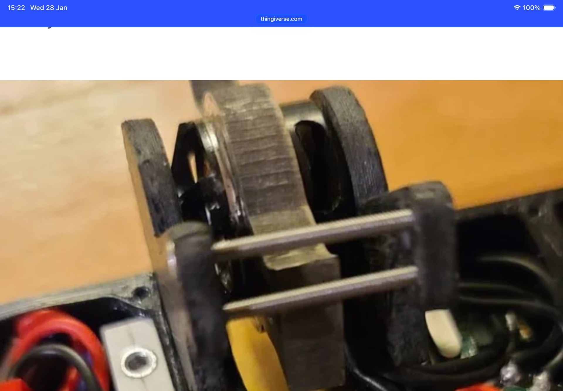

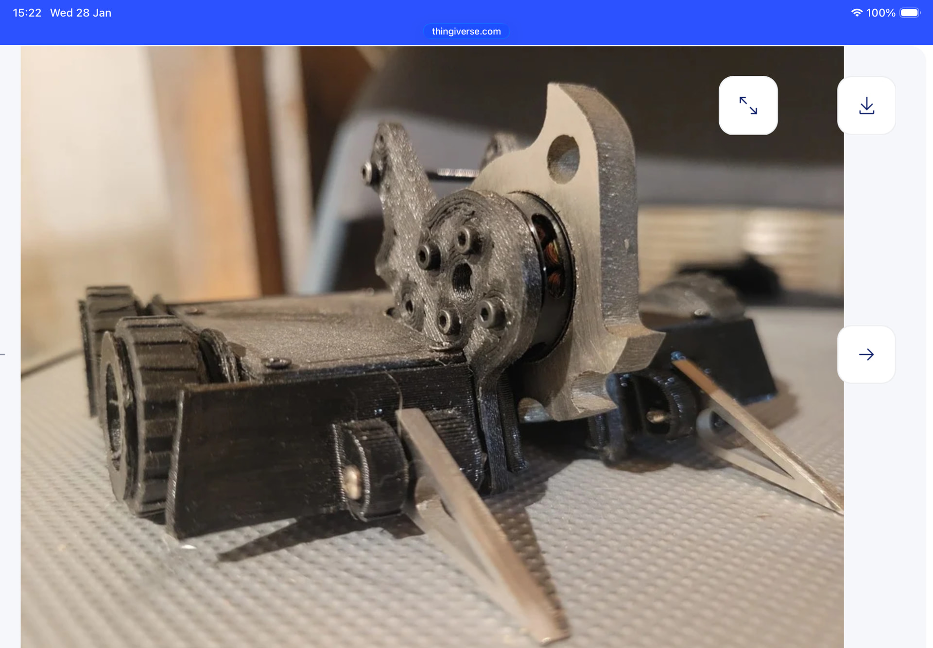

I don’t know if this helps but, because of the design the disc fits onto the top circle bit of the motor (sry I’ve never built a spinner before so I won’t be using the most technical terms).
Here is a picture of the robot I’m building:
So yeah, I think the weapon blade has to be quite chunky to actually stay on the motor?

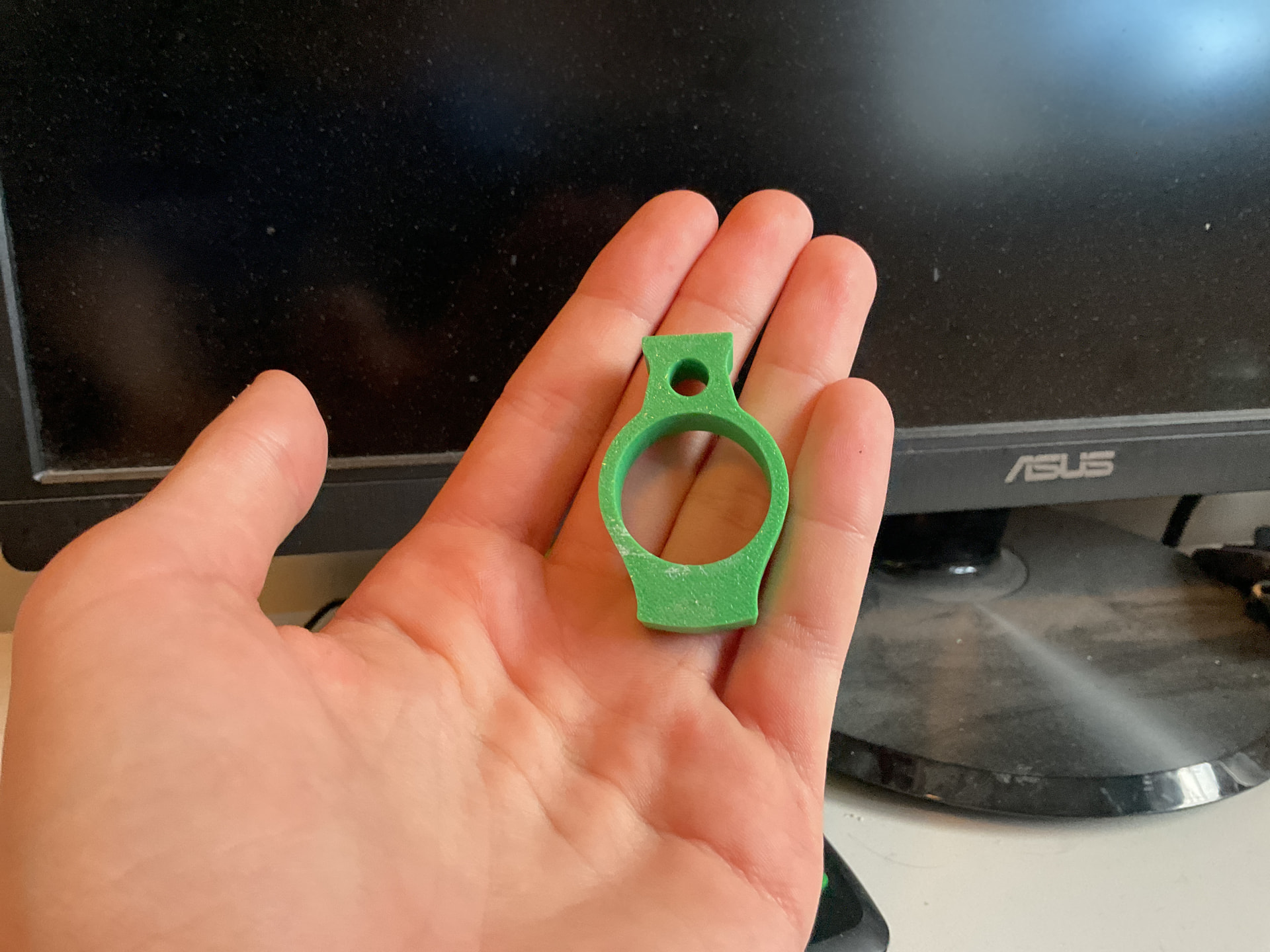

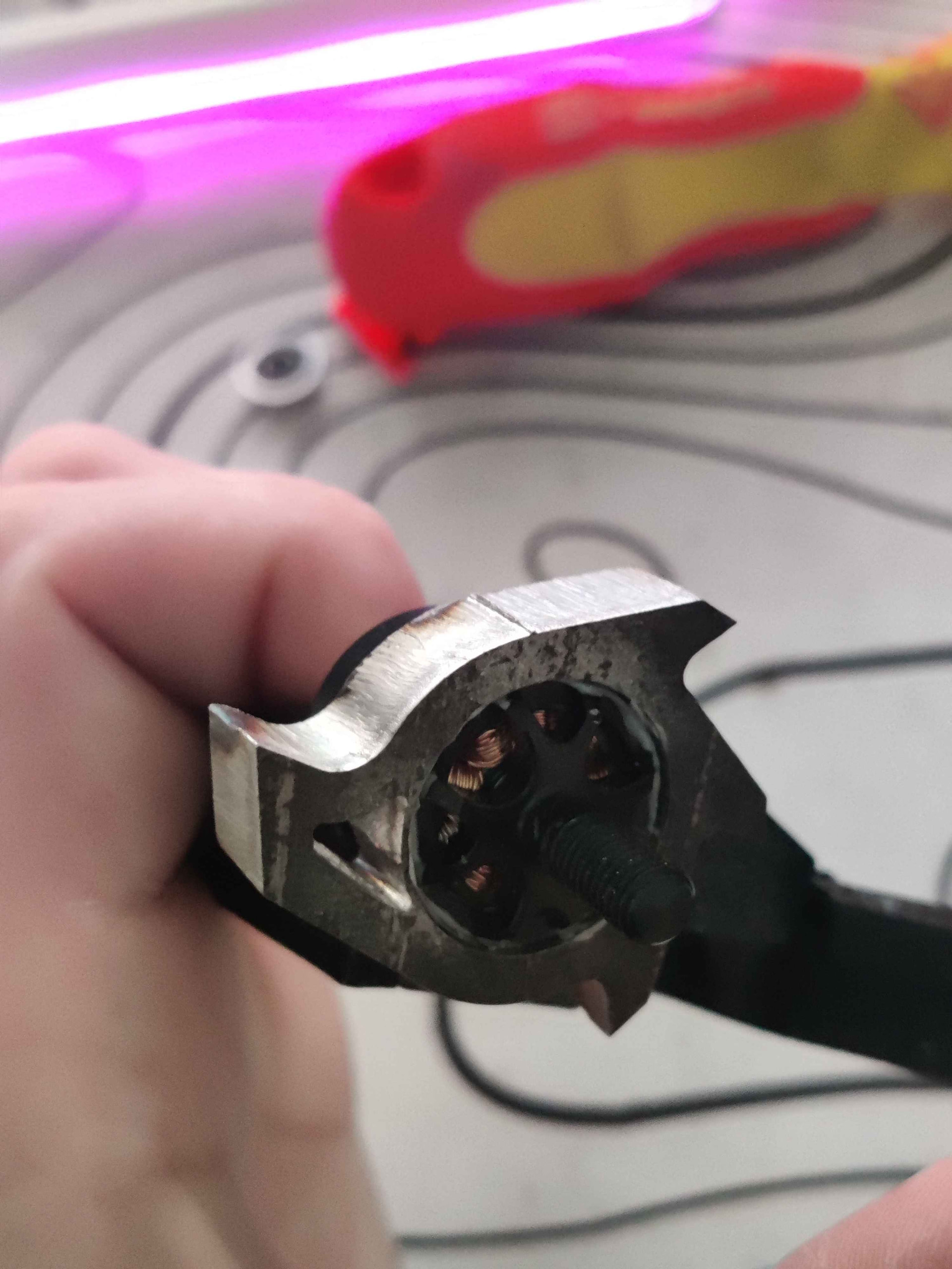

Here is a picture of the disc 3d printed:
It’s pretty smol

Ok so I put on a 100% infill overture super pla+ disc and…
it’s actually okay.

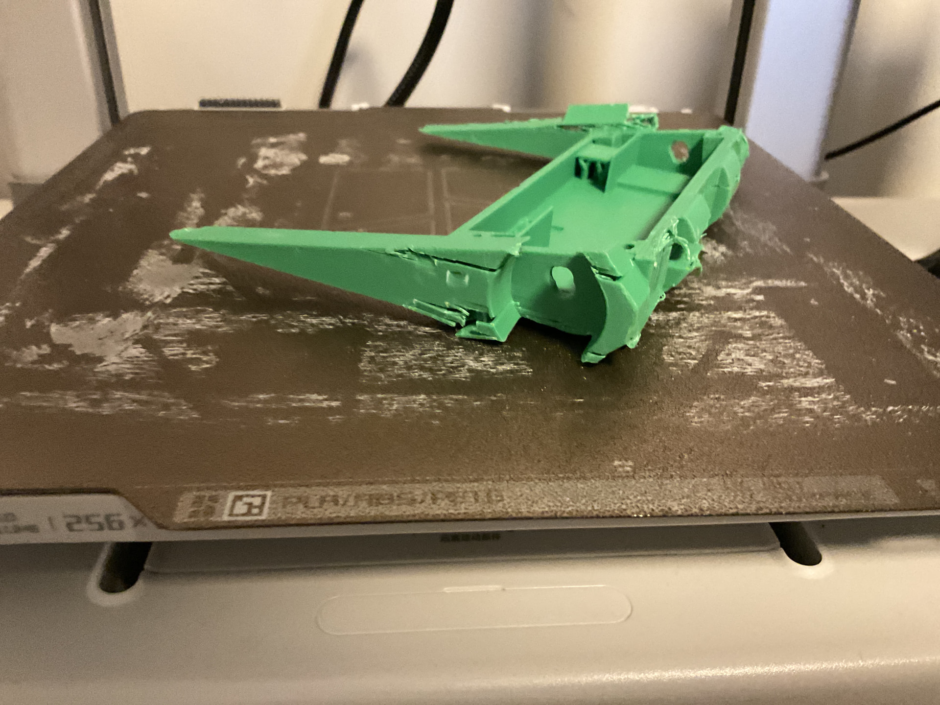

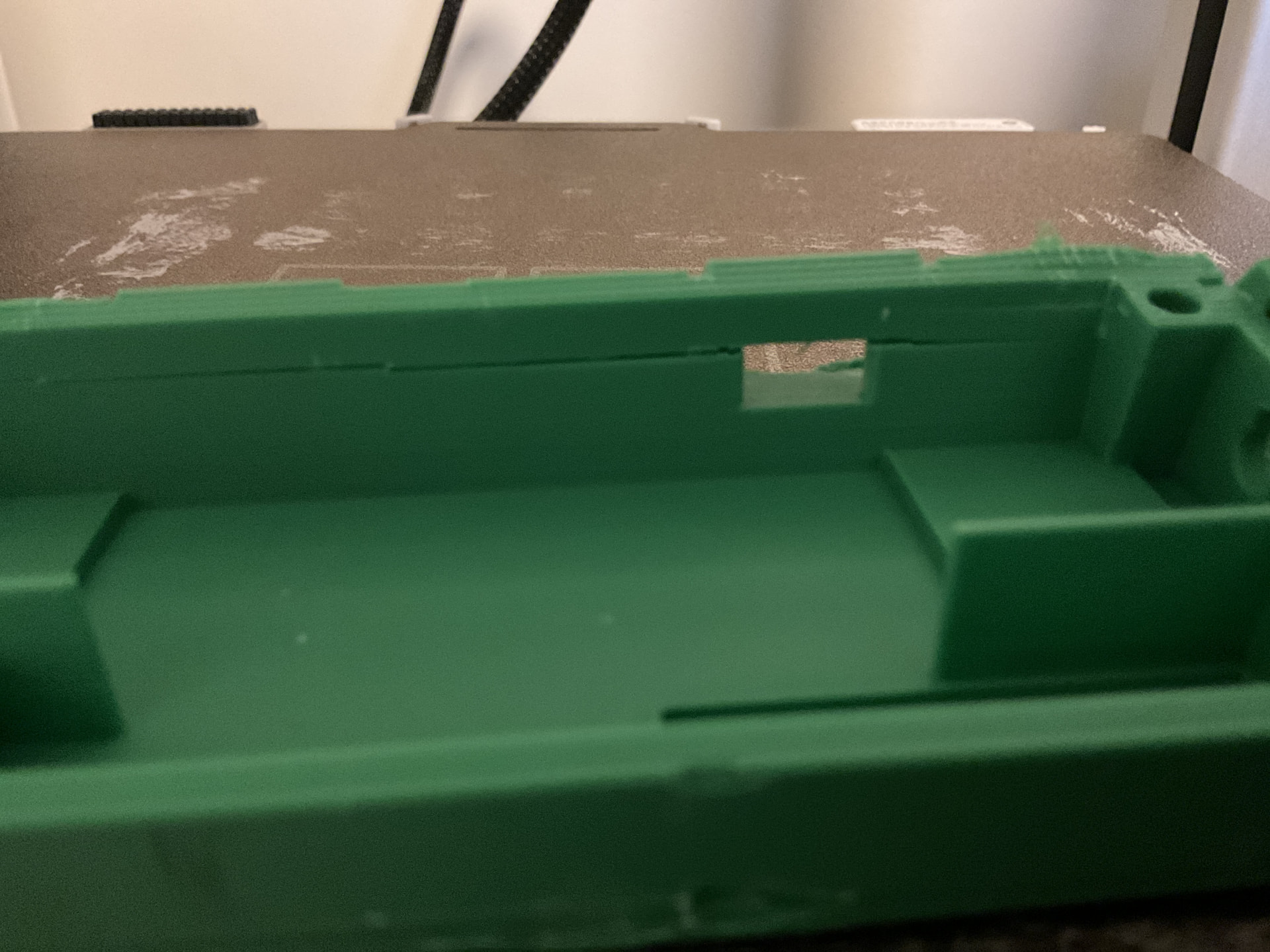

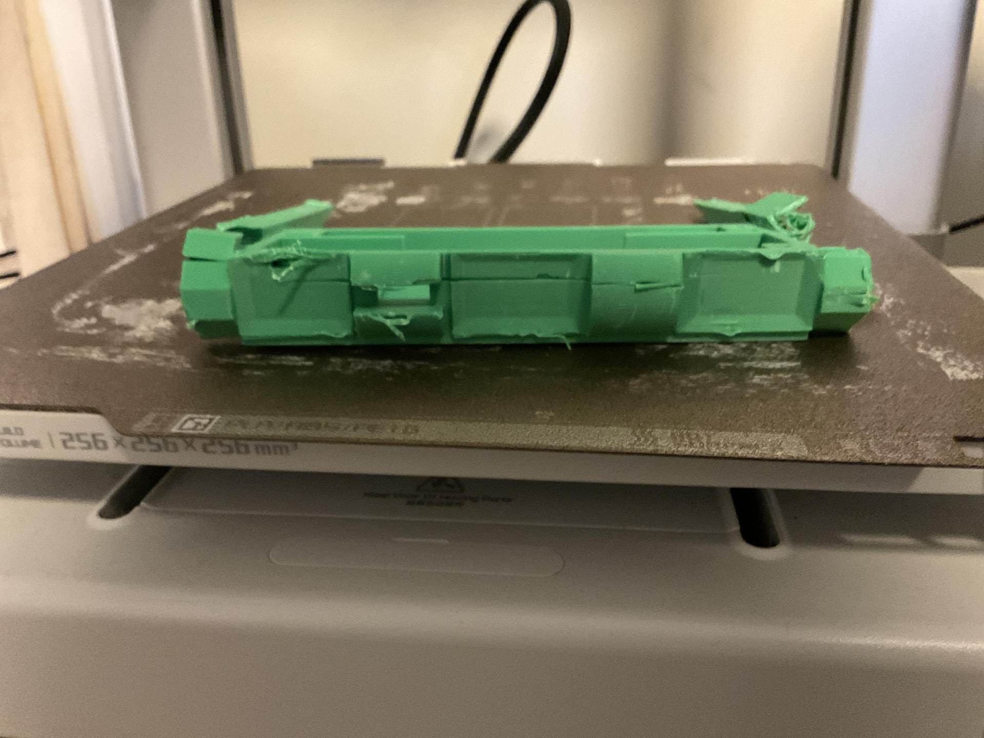

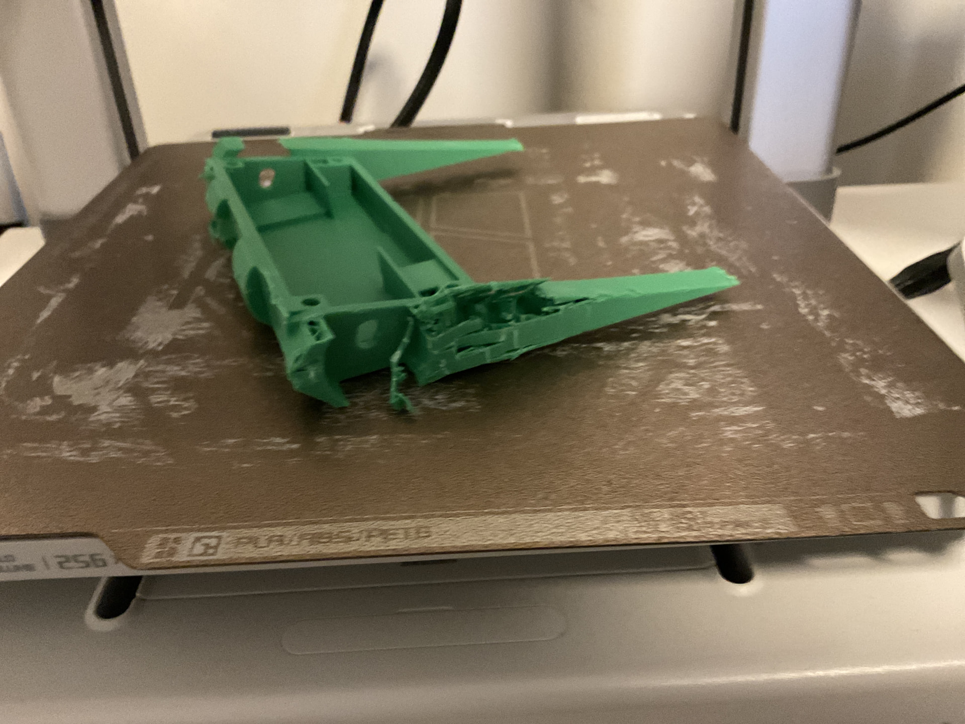

It did this to an old chassis (also overture super pla plus but only 15% infill) in about 5 to 10 minutes:
So, I’m beginning to wonder, is a metal disc actually worth it?
Glad you had good results with super PLA+
Worth mentioning as pointed out in Mark’s post on super PLA+ and also something that’s used in beetles for TPU - number of walls / perimeters is what matters for armour rather than infill:
But surely if I’m using 100% infill then it wouldn’t matter because the disc is solid plastic anyway?
(sry if I’m talking nonsense, as you may have found out already I’m not that great at printing)
100% can be a bit tricky, because if you are over extruding even slightly, there can be nowhere for all the material to go, and larger volumes get warped and messy with the extra plastic. You can probably mitigate that by going for a high number like 75%. But as I said before, infill is basically nonstructural.

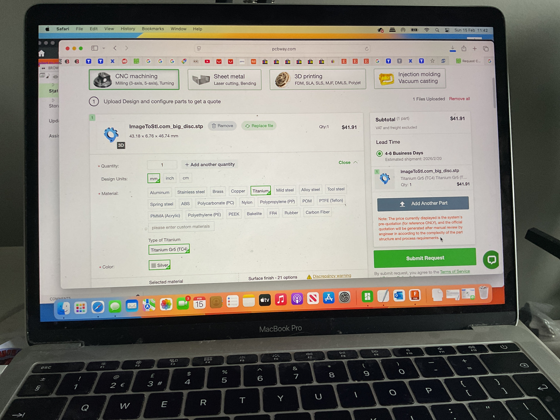

After some thought, I’ve decided I would quite like a metal disc. I’m planning on it being grade 5 titanium. I’ve managed to get an instant quote from pcb way but haven’t submitted request yet…
With the tolerance what do you reccomend that I do? What should the middle hole on the designs dimensions be and is there anything I need to specify in the order.

I recently bought some SLM (3D printed via laser sintering) titanium parts from JLC3DP. I would recommend going that route versus machining as it’s a much cheaper process - my weapon discs were about $9 each before postage, fees etc. The parts didn’t get much of a workout at ORCS but they survived some weapon to weapon hits with only a few minor dings and dents.
As for dimensions and tolerances, I’m afraid the answer is “depends”. How are you aiming to attach the weapon to the motor, it looks like it’s meant to slide over the motor can and be glued in place? Looking at the tolerances on my parts everything came out bang on as specified, so you’re probably best off making your central hole match the motor can diameter, with the caveat that there might be some lumpy bits on the inside that need post-processing - a strip of sandpaper taped to a stick and run in a drill works well for taking off tiny amounts of interior material. Remember, you can always take material away but you can’t put it back so easily!

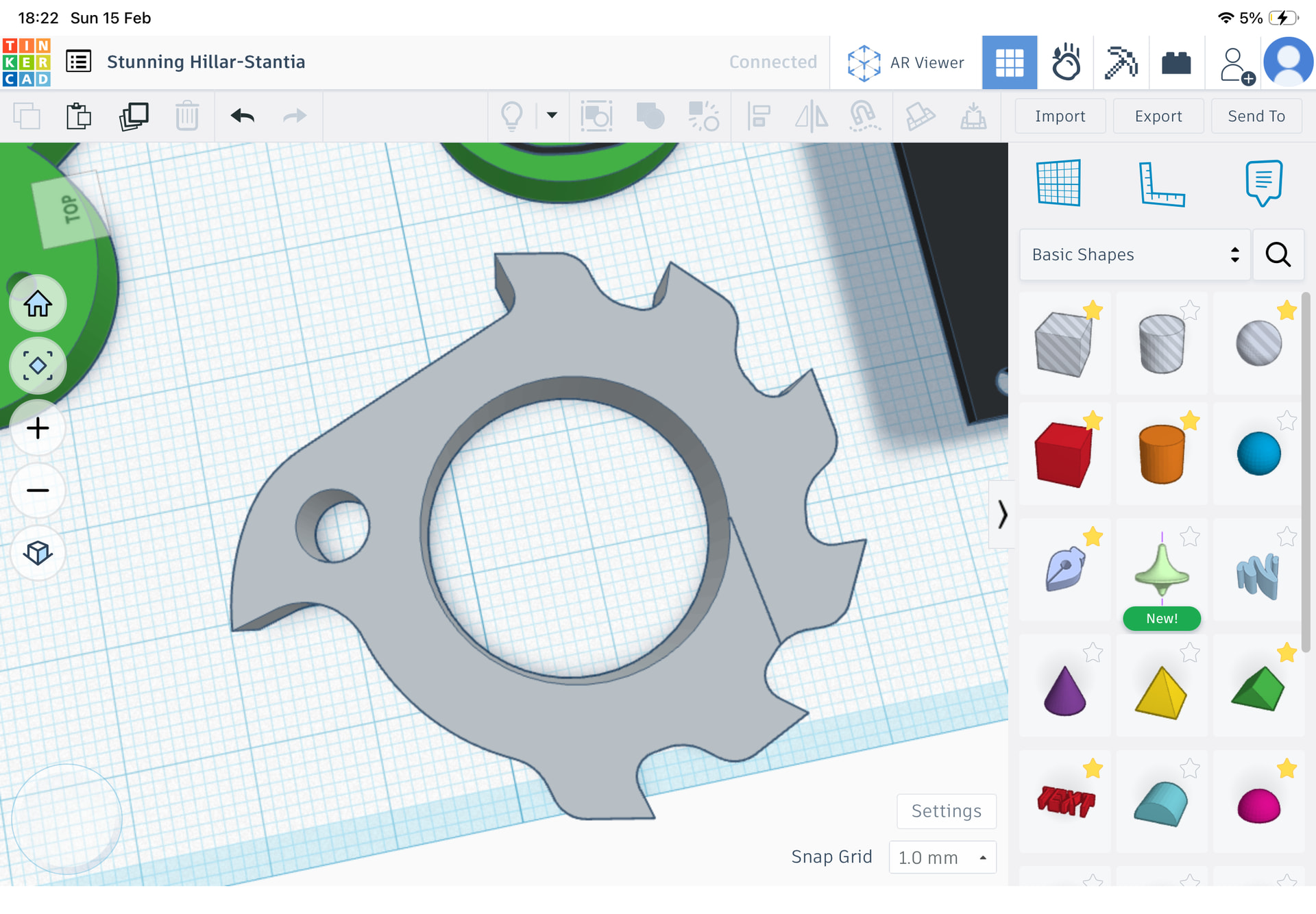

Did the disc with a 23mm hole in the middle:
Ready to send to (most likely) JLC3DP?
No point making it smaller than the can so you might as well aim for 23.02mm! If you’re otherwise happy with it you should be able to upload it for quote.
