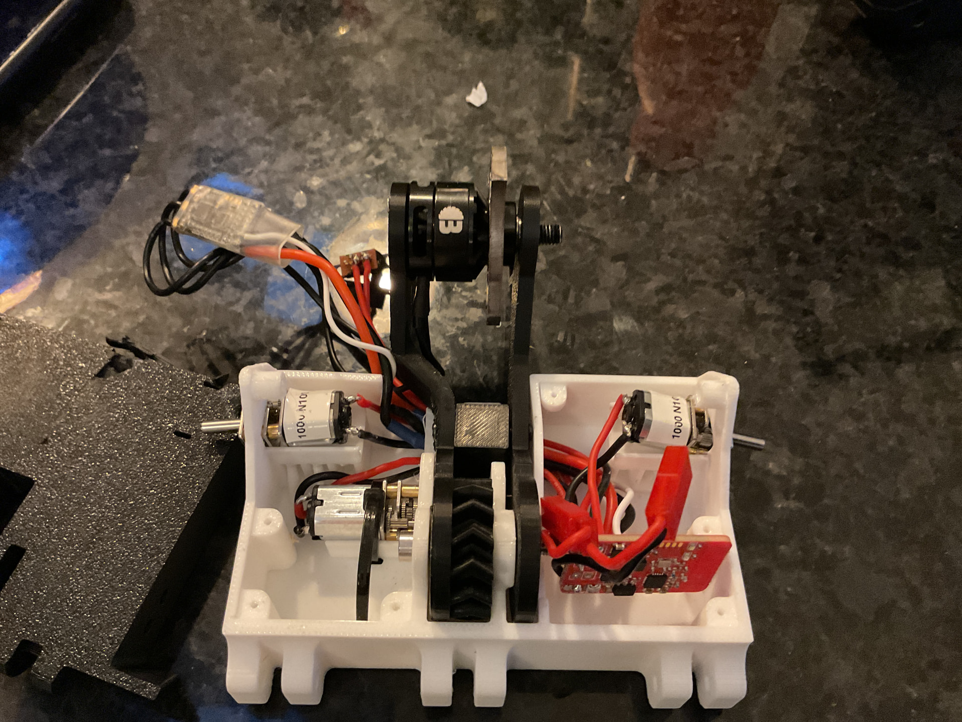

I’m Swapping to the 1806 for more torque for the bigger disc, and because the only bigger disc I have has the hole pattern for the 1806.
I’m running n10 1000rpm for the drive and 600rpm n10 for the arm. Was having some issues at GRoCS with the mechanism but will have it sorted for ORCS.

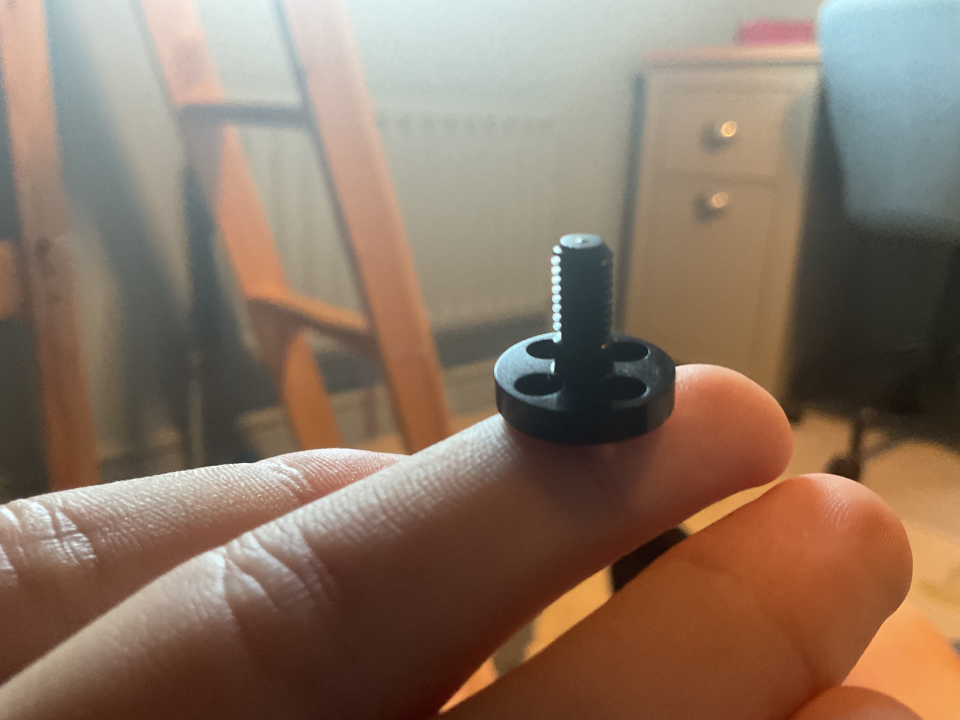

Right so I think I’m going to use the bearings you suggested on eclipses topic, but I’m not sure what size to get as the screw thing that attaches to the motor is about a m4.8 lol.

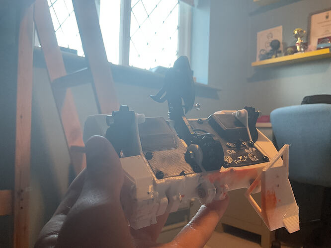

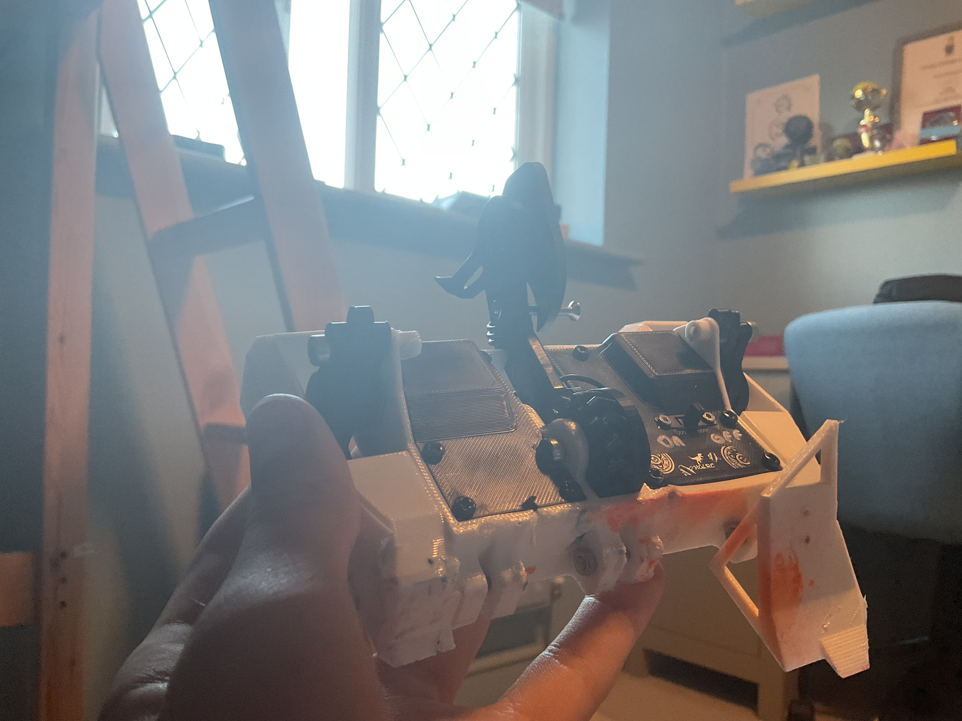

Thought I’d also attach a pic of the current robot as I got the pictures working. (After it getting beat up at GRoCS.
M4.8 is unusual, does an m5 bolt thread into it? If so just the 5mm id 8mm OD ones should do you fine. Hammersaw weapons dont tend to need heaps of torque as you tend to only really swing when you have a pin, and if you cant spin up to speed and strike in 10 seconds that’s a greater issue than motor power. Looking decently well together after GROCS, I presume I only really ripped the wedgelets off, as i couldnt get much bite due to my poor traction, which will be fixed shortly.
A quick look up suggests that a 4.8mm thread could be a #10 imperial thread.
If it measures 4.8mm across the crest of the threads it’s almost certainly M5.
In practice threads are rounded over at the crests for clearance, since in the real worth everything is rubber (even metals) and it’s not practical to make things to perfect tolerances.

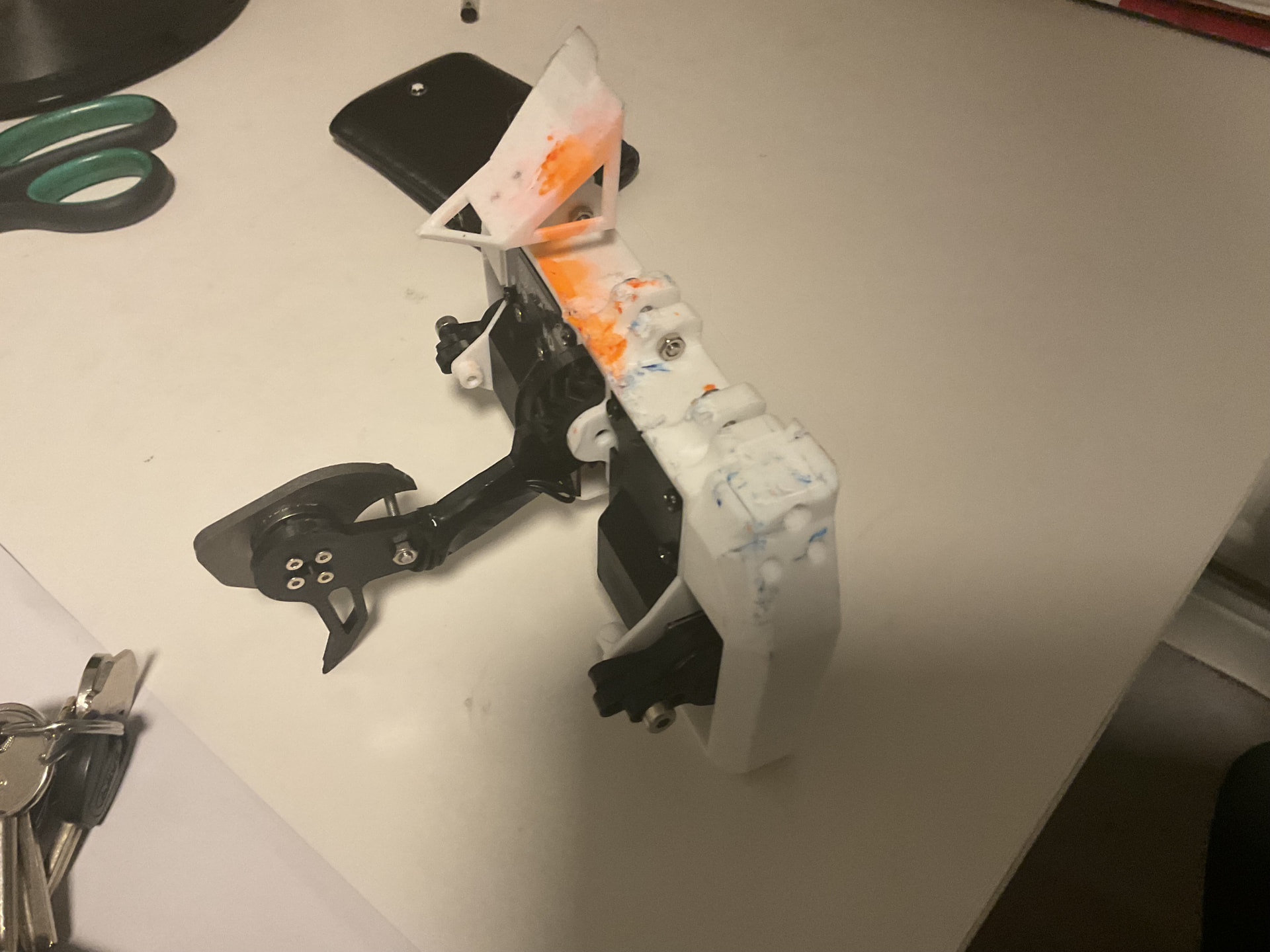

Ok, finished weapon assembly:

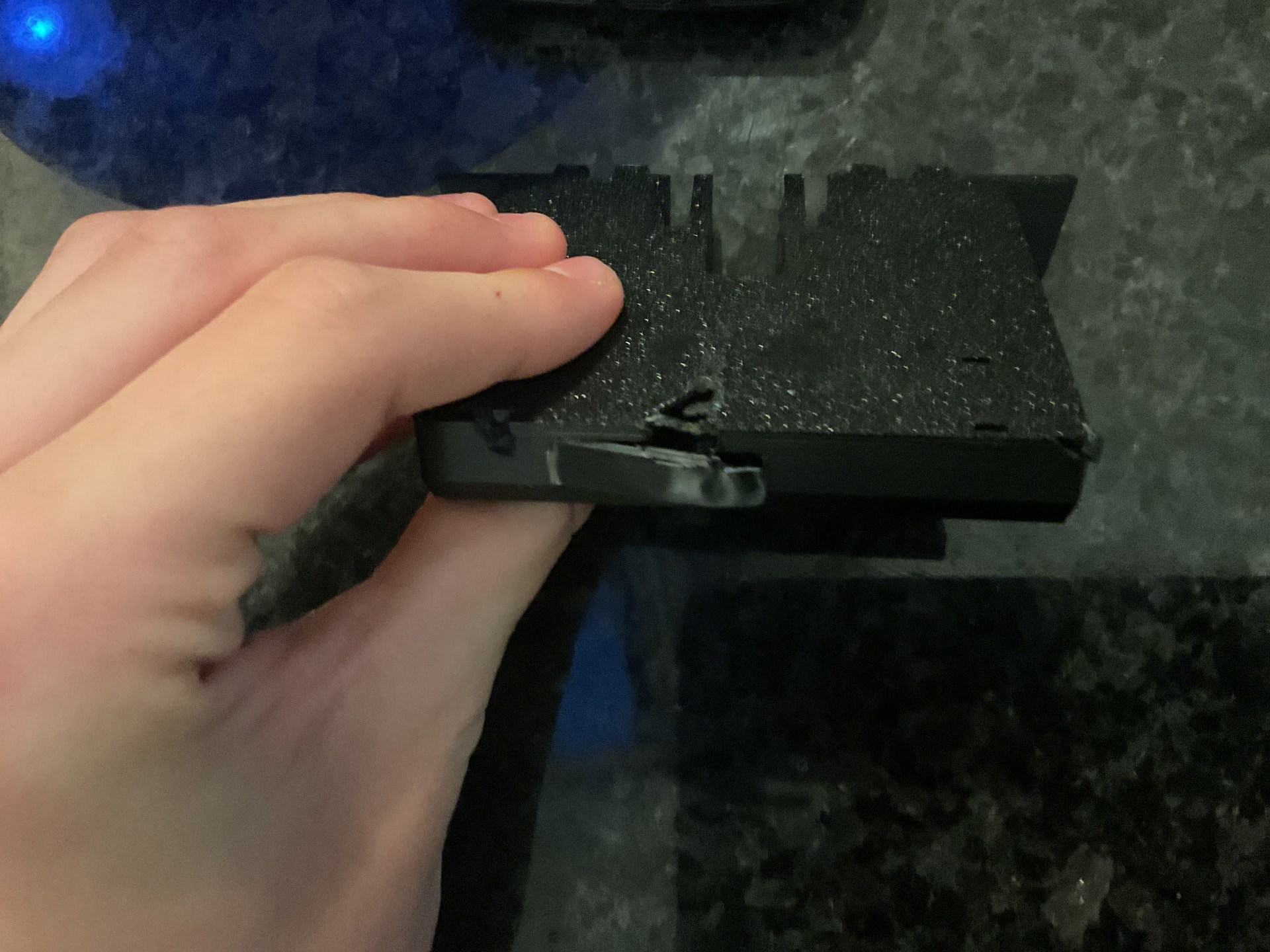

It did this to a chassis with a pretty badly set up hit:

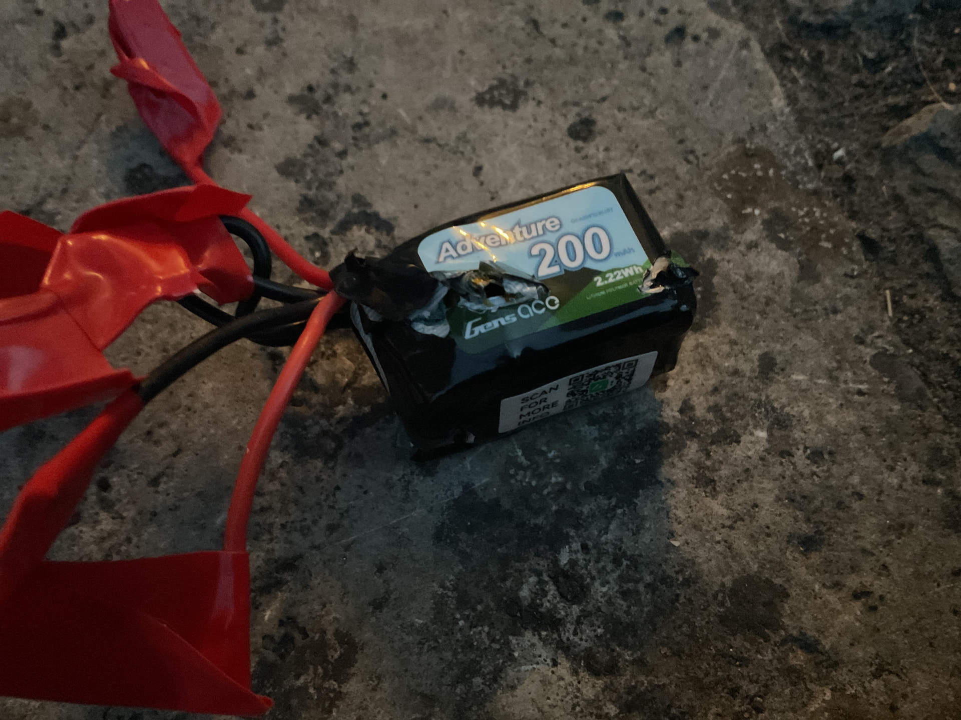

But, here’s the really bad thing, it did this to its own lipo as I didn’t put the lids on yet, but moving the arm moved it around quite a bit:
Big panic!!! :warning::warning::warning::warning:
Have covered all wires in elec tape and will leave in LiPo bag until further notice, or we figure out what to do. It was probably a whisker away from a LiPo fire…
Update: it’s in a LiPo bag in the part of my garden furthest away from any wood fences/ my house
Update 2: it’s now in a LiPo bag, in a big metal tin with the lid slightly open in the same spot in my garden
Seems like only the casing got chewed up, but I think you should order a new one as the cells could be FUBAR (and I don’t mean the featherweight).
I have 1 spare, so I just have to hope that one Dosent fail me at ORCS tomorrow. the lipo was pretty puffy as well…
Make sure you are being safe. ANY damage to a lipo is dangerous, and thats clearly not just the shrink wrap over the top torn there.
Hollis you’ve done the right thing getting it contained. Get it safely dealt with and do not use again :slightly_smiling_face:
