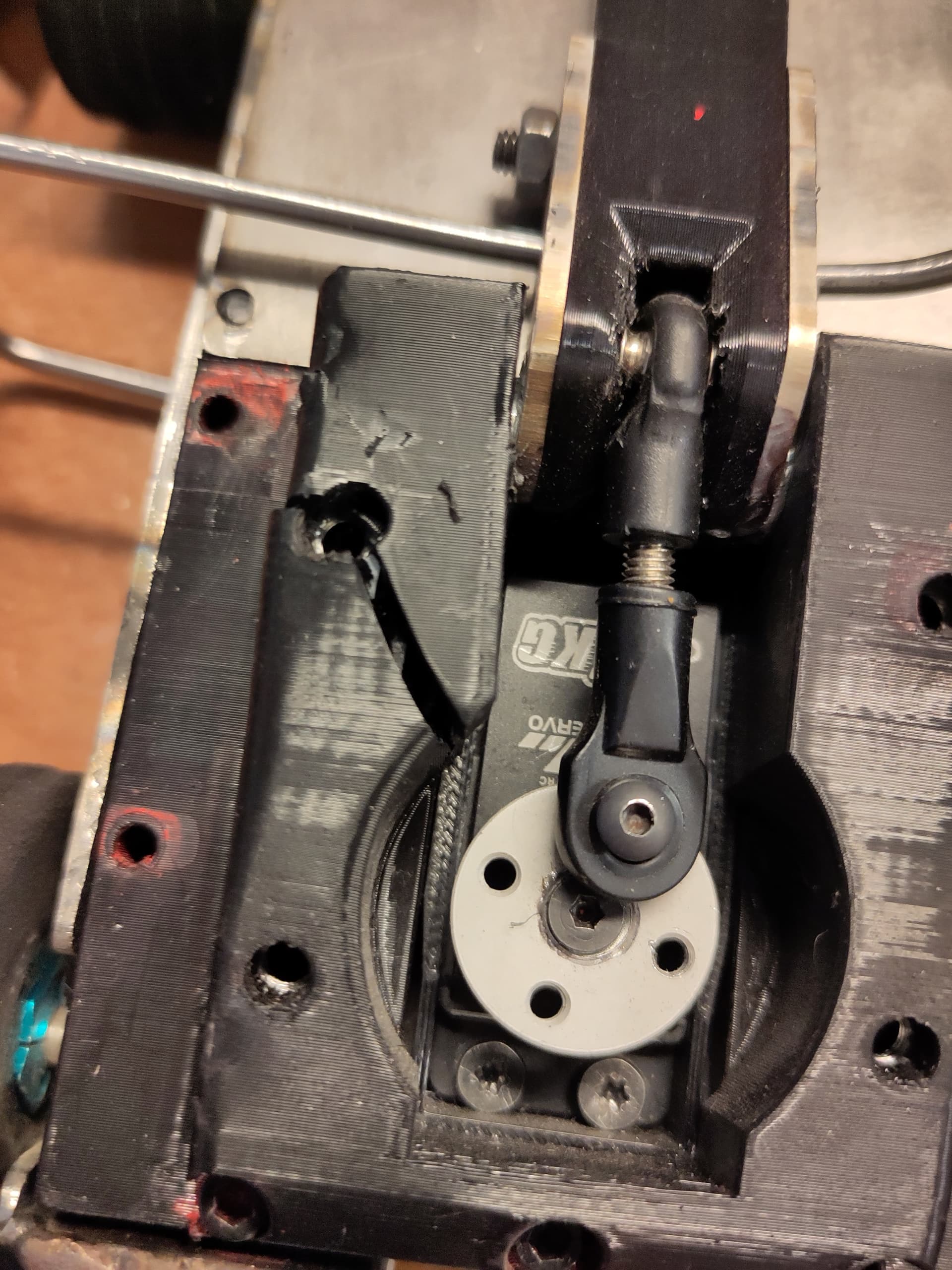

The BASF brand 64D TPU? A friend gave me a roll after buying it by mistake and I tried printing some bits from it, it printed great but unfortunately it still does the cracking thing on hard hits.
Yes that is the BASF TPU. I have only used it in ants so I think the cracking risk may well be a question of the scale it is being used at. I have seen others use other harder TPUs well in ants but come to think of it every time I hear of it in beetles it is about it cracking.
