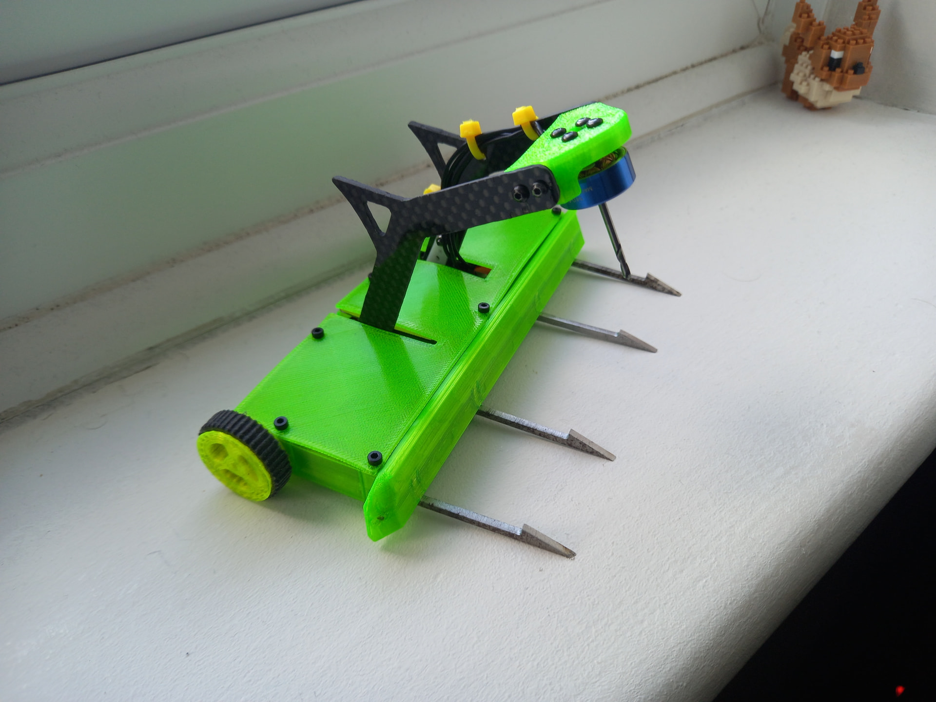

Grandmaster Smash
Grandmaster Smash is a 2 wheel drive vertical spinner, but with this I was keen to make it a little different from many of the other verts in the ant scene. Instead of following the more traditional ground game oriented shape of something like Aftershock or End Game, I went with a more reach-oriented approach, sticking the weapon out in front while keeping it off the ground with stilts. This helps negate other robot’s ground game and ensure that even if it’s not getting under opponents it can still hit them, and also I think it looks very cool.
In terms of specs, Smash uses a Malenki, 2x600rpm N10s, a 150mah 2S battery, BBB ant weapon ESC and 2300kv 1806 brushless motor. The chassis, like all my ants, is 95A TPU, and has a 0.5mm Grade 5 Ti lid with TPU dust cover for cosmetic reasons.The weapon support and struts are 3mm CNC’d polycarbonate, and I’ve added some of the same forks I use on Baby Boomer to give it a bit of ground game of its own. The disc is 3mm hardox and 44mm in diameter, weighing in at 17g. This might not seem a lot, but it’s more than enough to roof most antweights with a good enough hit. I also found during testing the robot can self right using the torque of the weapon motor if I spin all the way up, then immediately throttle down to zero which is a nice party trick! In combat Smash has a habit of bouncing around on its weapon, making for a very entertaining if not mega effective robot given the design of most ant arenas. Despite this, an older version of Smash did manage 4th place at AWS 67 somehow! I mainly run Smash at events with the 4 inch cube restriction these days, as I prefer running some of my more “out there” designs when a size limit isn’t in effect.

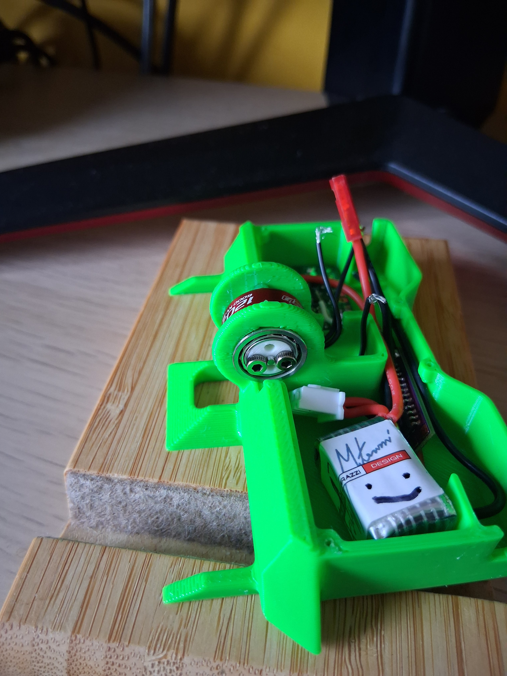

Also how are you supporting the brushless motor shaft on both sides on your vertical spinner? I have never been able to figure it out.
That Darn Drill, my tpu has holes in it now…
Thanks James :slight_smile: I’ve been thinking about switching to carbon fibre but I do like being able to see all the guts. A hammer saw would probably do more damage, but I really like the precise nature of a drill. It basically acts as a kinetic grabber as well once I get a bite, which makes driving opponents into the pit much easier.
For supporting the brushless motor on the other side I use the 5mm prop adapter that often comes with these 1806 motors. I then added some washers to act as spacers/shims to fill out some of the length of the propshaft, and press fit a 5x10x4mm flanged bearing into the polycarbonate support. I topped the stack off with a 5mm nylock nut to keep it all in place. Hopefully this pic shows it a little better:

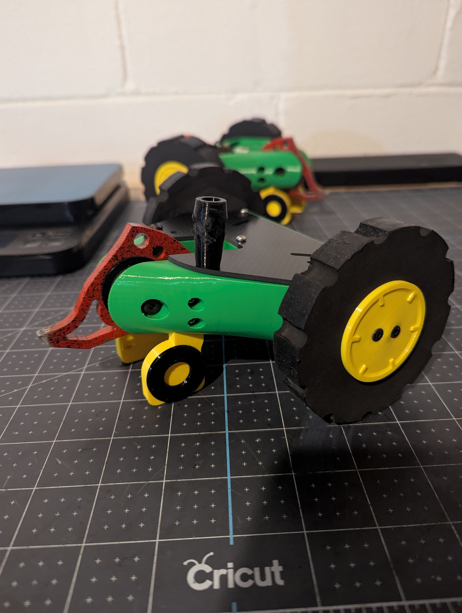

It has been a while since I posted here, and while I’ve not been as active in antweights as I have previously been, I’ve still found time to build a couple!
First up, I’ve reworked Auger The Top. This new version brings the center of gravity down by flattening the entire robot, which I did by moving the servo into the chassis and widening the bot to make room for it. This makes it less prone to wheelying and easier to self-right, which were big issues for the previous version. This saved enough weight to add the 0.5mm titanium sheet into the lid just like on my other ants, and let me ditch the PLA+ I was using for the previous lid in favour of TPU. The forks are secured by a 2mm silver steel rod that presses through the entire front of the robot to mount all 4 forks as this saved weight and was much simpler than 4 sets of nuts and bolts.

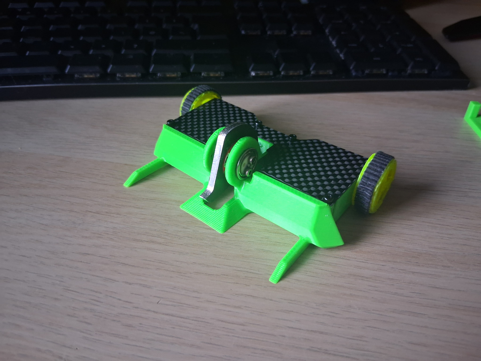

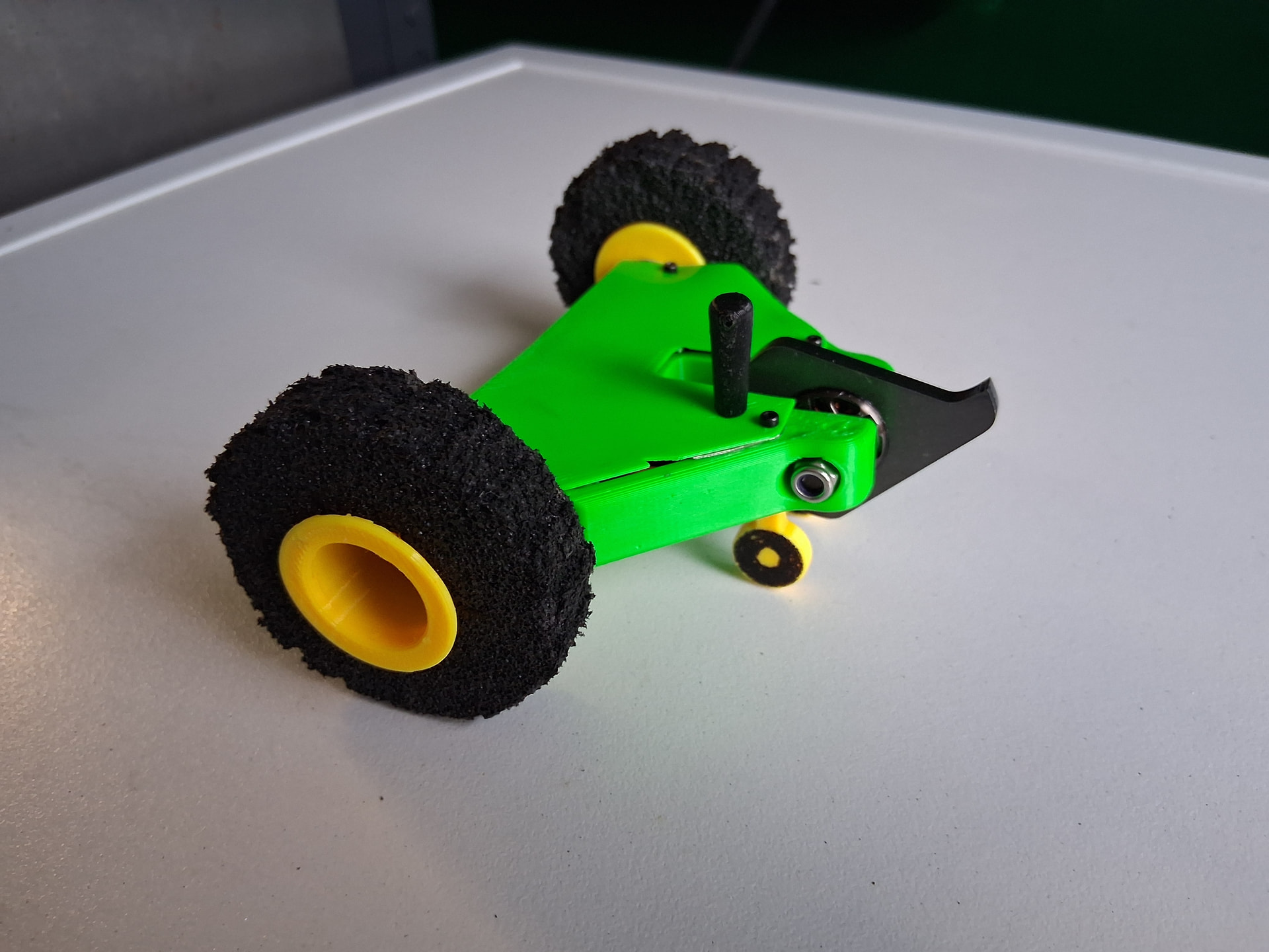

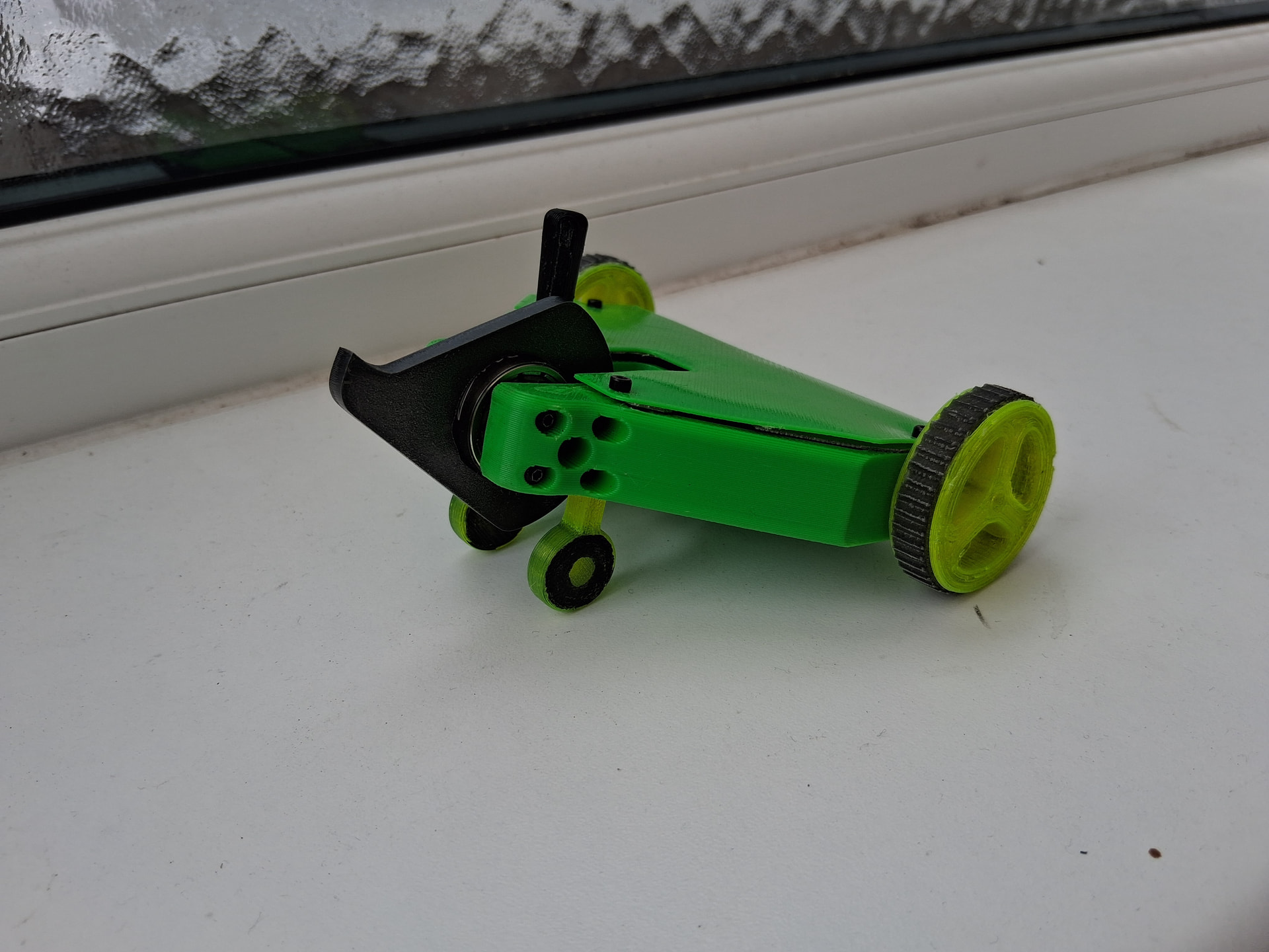

I also retired Grandmaster Smash, or rather cannibalised it for parts and reworked it into a new robot, introducing Traccy Chan! Based loosely on the US 1lber Intrusive Thoughts.

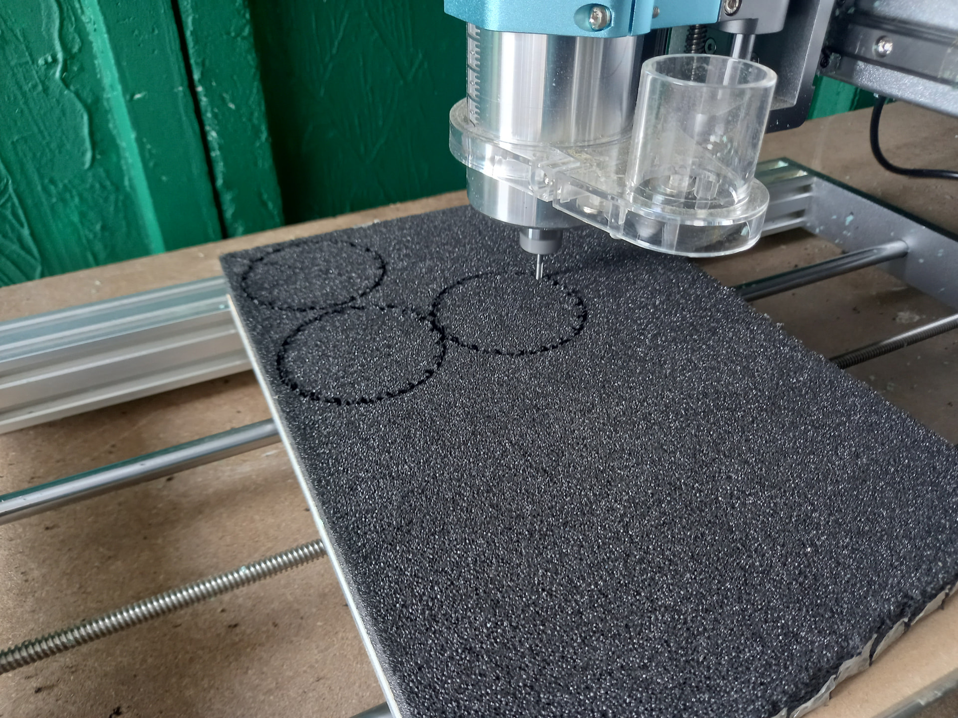

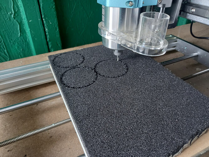

Traccy Chan is rocking a frankly stupid 30g 60mm diameter weapon press fit onto a Smoox 1507 motor. I had originally planned to use big CNC’d foam wheels to resemble tractor tires but found they didn’t have enough traction with the robot being as front-heavy as it was, so I swapped them out for the old Grandmaster Smash tires before long.
Like the rest of my ants, the body is TPU (as are the front “legs”) and there’s a thin sheet of titanium built into the lid. The chimney acts as an “ear” to keep the weapon from hitting the floor when inverted, and is printed from YXPolyer Nylon.
