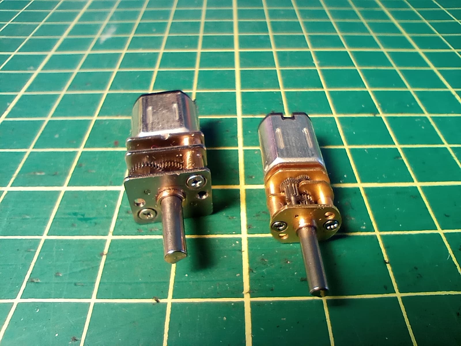

It’s currently in the prototyping phase with some rough chassis printed and the mechnisms somewhat figured out. For the drill bit I replaced the shaft of an 1806 motor. I also had to massively downsize the servos used for the forks compared to my previous cam lifter, Guido. For driving the arm I’m using a prototype M10 from Ranglebox which should be lighter but just as strong.
N10 (left) vs M10 (right):

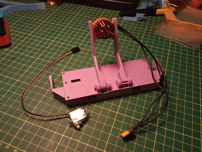

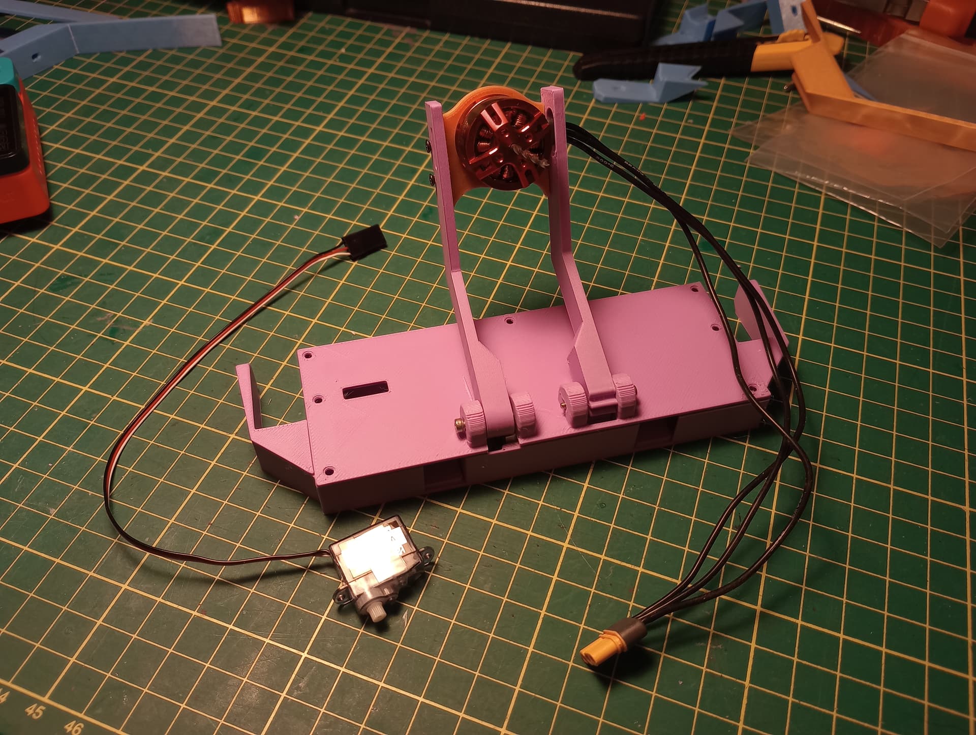

This is the most recent prototype:
Currently the prototype chassis is printed out of PLA but the final print will be TPU.
Any feedback or ideas would be greatly appreciated! :smiley:
Great looking design! A drill can be suprisingly effective at 150g.
I’m a little dubious of that small all plastic servo though, I think its likely to strip teeth in the harsh life of a combat robot. Perhaps you can strip some weight out of the frame and upgrade it?
I’m hopeful about the servo as a cam lifter requires very little torque and I shouldn’t reach their stall torque. I would only be worried about a direct hit from verts (I’ll have arour for horizontals but not much I can do for verts). I’ve ordered some BECs from BBB so I should be able to test today.

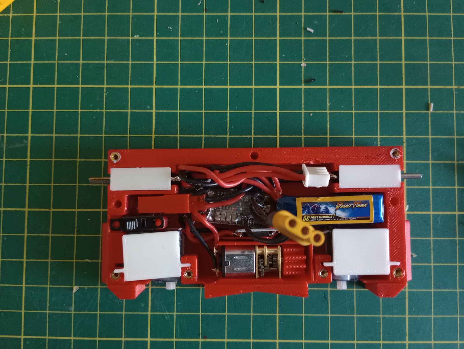

I have all the components now and I have a few changes to the internals, most notably:
I’m now using the M10s for drive and a 100rpm N10 for the arm
I’ve switched to a more modern and compact chassis
And a higher gear ratio for the arm.
As for testing, here’s how it went: https://www.youtube.com/watch?v=1SAQ239UMxE
It can drill through tpu but I haven’t tested it on anything else yet.
The wiring in here is definately the tightest wiring I’ve ever had to do!

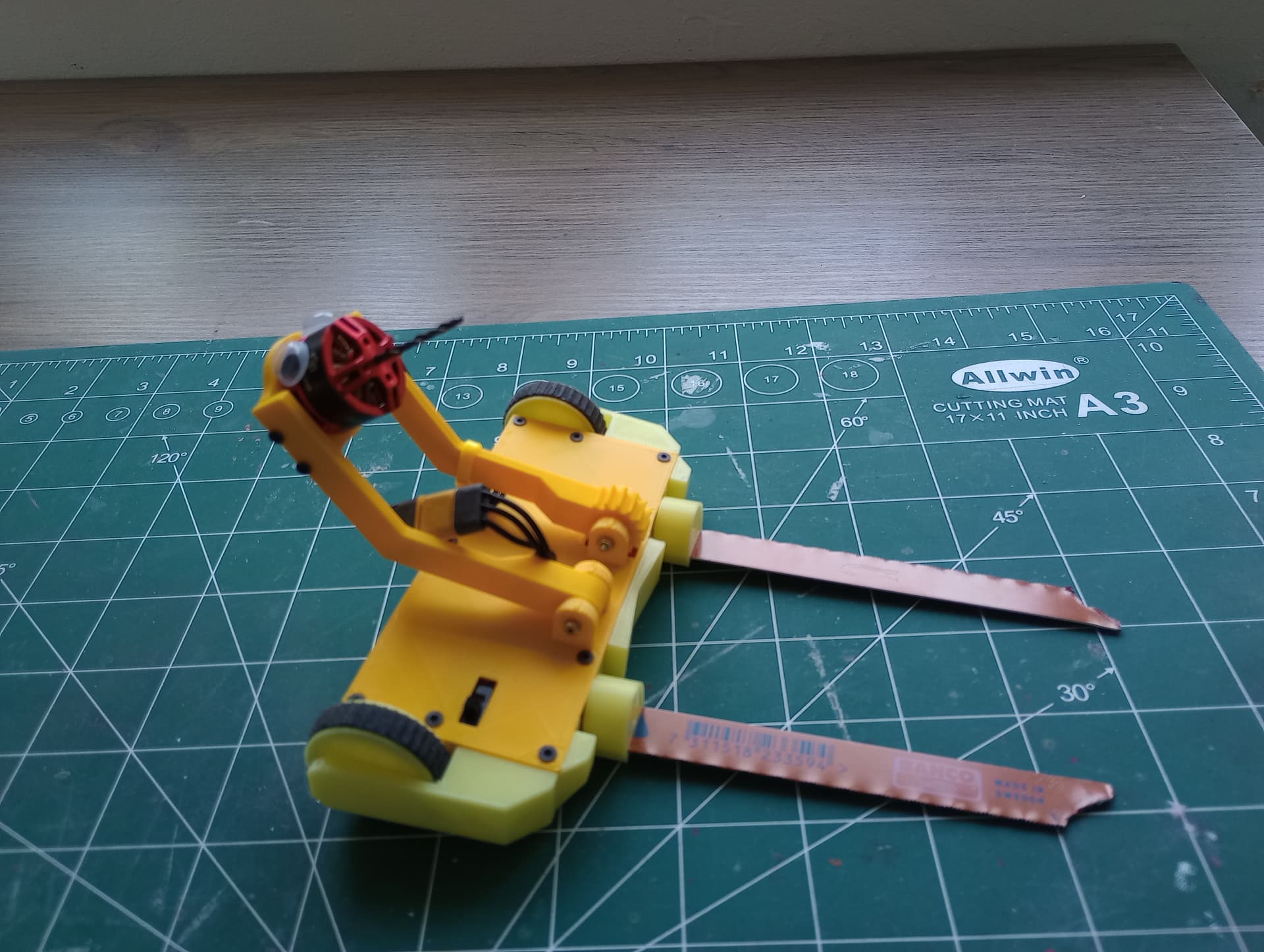

Since starting to write this update I’ve actually finished the bot!
The finished bot:

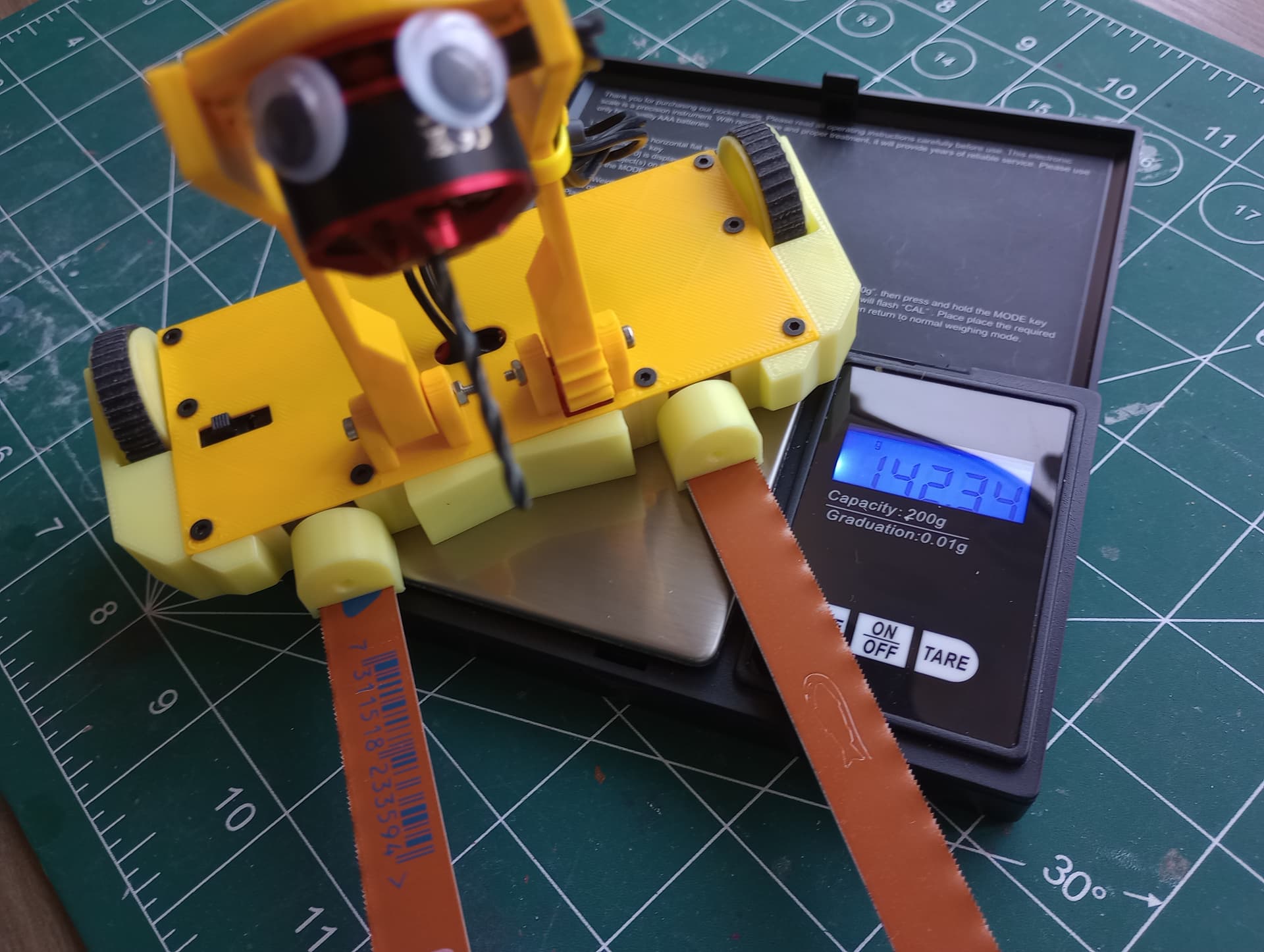

I’ve got some things to tweak and I have to sharpen the forks. I originally thought that it was going to be overweight and I had ordered a 1404 motor instead of the 1806 I’m using now to save weight but this isn’t going to be necessary as it’s currently 142g!
I really need to feed my bots more…

Anyway, I took What to ORCS 8 and went 2 wins to 3 losses, not too good. However, I learnt lessons and found issues.
The issues:
  • The gears were skipping when I tried to pull the drill out
  • The forks would slip on the servos
  • Too much weight left over.
The fixes:
  • I… Don’t know yet. I need to think about this but probably higher MOD
  • Fixing problems 2 and 3, I am going to replace the light, plastic geared servos with heavier, metal geared servos wich are more durable and won’t let the forks slip.
With these changes, I will be taking What to ORCS 9! Hopefully it does better.
Sorry bit of a weird question here but,
What scale are you using in that most recent photo
I’m looking for an upgrade from my inaccurate kitchen scale
Great work here vlad,
Sorry for getting back so late.
They’re just some jewelerry scales from ebay!
