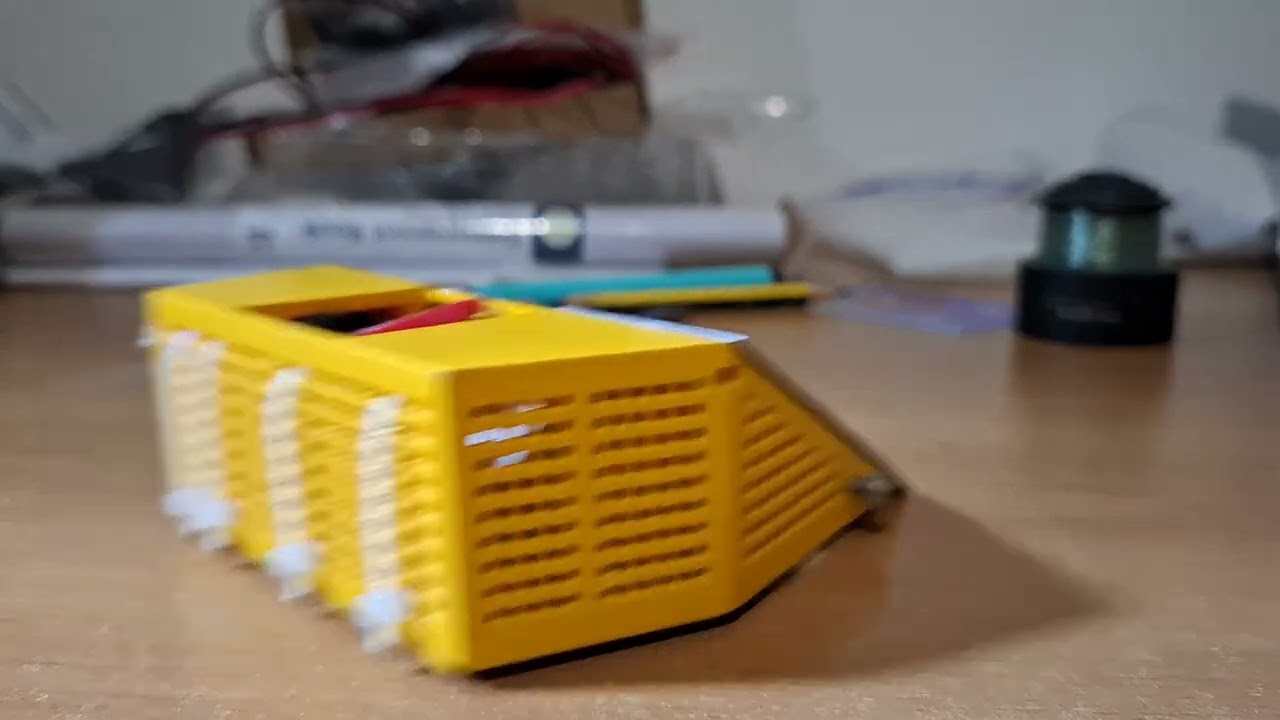

Just to say, rather than waiting for Hydrant to be ready, I thought I would resurrect Firestorm-in-a-teacup (AWS 62). This was good practice for changing JSTs and using a Malenki Nano.
I didn’t ruin FIAT’s Malenki Nano with my soldering, so I still have one left over for Hydrant v2.
I’m still concerned with how messy the electronics are inside.
I just found out that the AWS rules changed RE: battery plugs being used as power switches. I’m going to need to take it all apart, add a switch, and do some more soldering.
