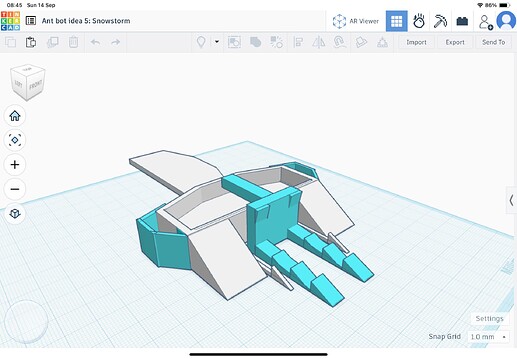

I need help for a possible 2nd robot concept I like to create ideas on Tinkercad before and then get into all the complicated cad with fusion 360.
I’m planning to make a sort of big dill style robot.
Big dill:
My idea (sry not very good :rofl: )
I need help with cad as this will be my first time using cad and using fusion 360
Some main things:
What materials would be best?
Should i make wheels or buy them
How could i make the flipper mechanism
And where could i find the high speed servo as its currently not in stock at the bbb shop :frowning:
Also any tips for a begginer on fusion 360?
Thanks!
Hey there, welcome! I like your concept, it’s got a nice big wide wedge on the front and bonus points for it already having a cute little face.
I’ve never really used Fusion so I can’t help with specific CAD advice, but:
Most people are printing their antweights from TPU and PLA. Regular PLA is a bit brittle, but there’s PLA+ and PLA-ST filaments which are much tougher. MarkR wrote a good post on it recently: PLA, good or bad?
You can also get 1mm polycarbonate sheet and cut it with hefty scissors and poke holes with a sharp screwdriver if you need to improvise some little armour panels or a top plate.
Buying is definitely easier, but buying tyres and designing your own wheel hubs isn’t hard. I like lego tyres (mostly because they’re cheap and look cool, traction is pretty mid) but there’s a lot of options out there - I’ve seen people use O-rings. I would avoid playing with casting polyurethane or silicone resins until you’re absolutely sure you need to, the goop gets everywhere and the chemicals are nasty.
It kind of depends how you want to package the rest of the robot, I recommend looking at some other robots to get some ideas. You have a lot of options, but attaching the arm directly to the servo is the easiest. A couple of holes in the flipper arm to line up with the horn that comes with the servo will give you a working weapon without much hassle.
Since it’s a standard mini servo you could buy something else to prototype with and wait for it to come back in stock. I use MG90 servos from ebay, they’re not too expensive and it’s good to have a few spares around.
Hope to see it in action soon!
Thanks so much this definitely helps!
Mechanism wise, if you want to keep it simple you can definitely just directly attach it to the servo horn for a simple lifter which would have plenty of power with one of those high speed servos.
For more of a flipping longer range thing, have a look at this thread for mechanism examples
Thanks Joe i appreciate it this diagram definitely helps :slight_smile:
