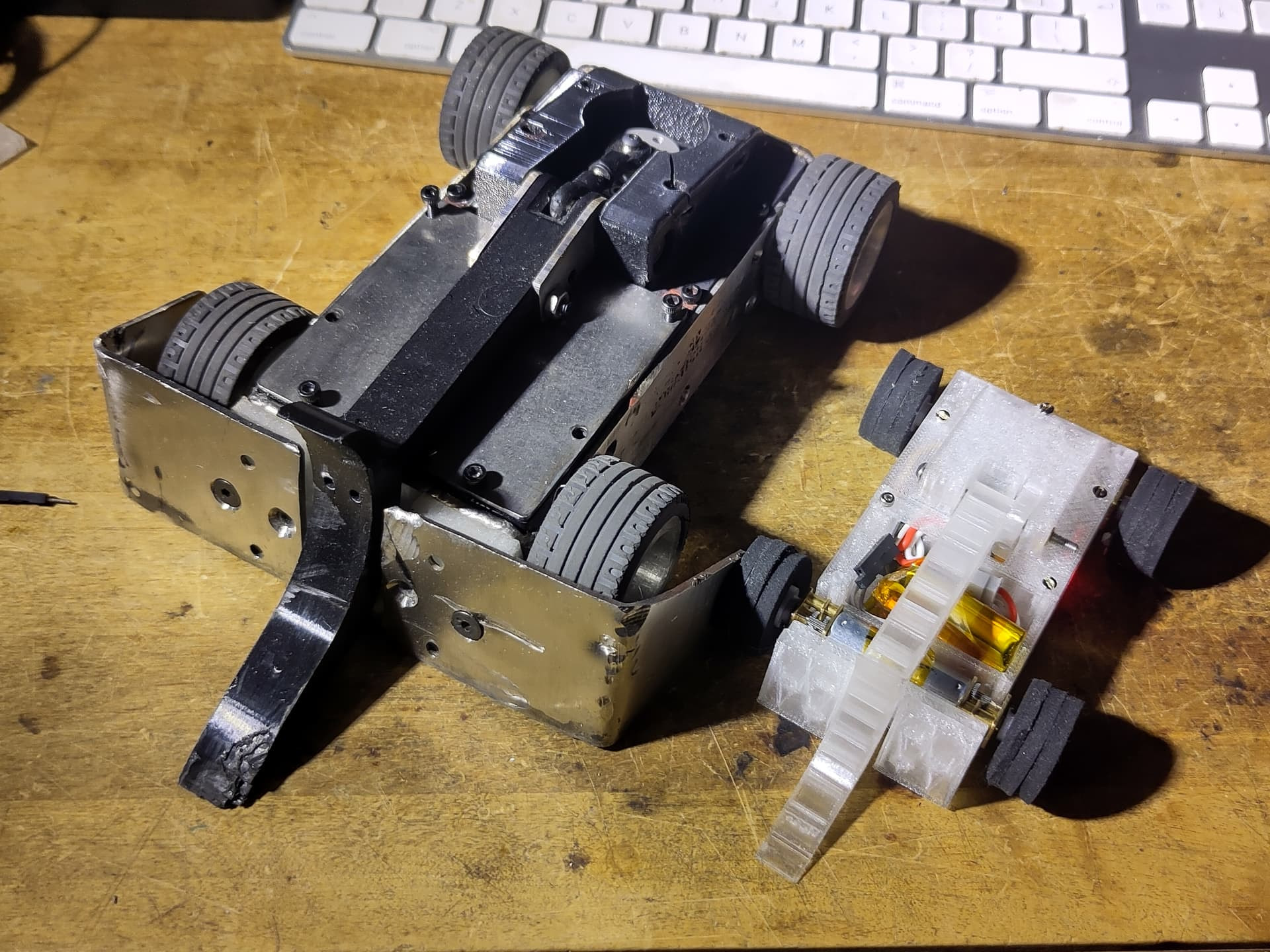

There is one I haven’t posted about much however, and that’s actually my first ant, Fatal Deviant. Initially just a 60% scale version of my first beetleweight, Fatal Deviation for drive tuning, driving practice, and just an excuse to fight more robots tbh.
For a lifter bot, a single 280mah lipo cell and a boost converter weighs less than a 3s lipo, with the caveat that you’re limited to about 3A peak and 2A continuous from the boost converter. More than enough for four cheap N20s and a small servo, but not much more.

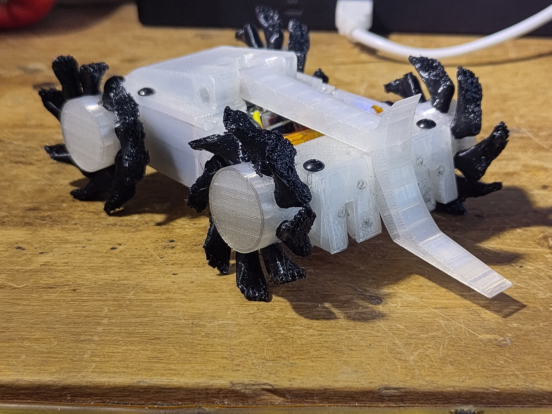

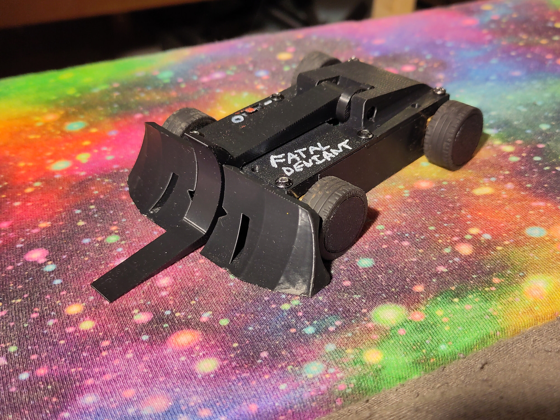

Feetal Deviant, the off-road version for the ORCS warfare arena
Re-release of the same tired robot but now in a new colourway.

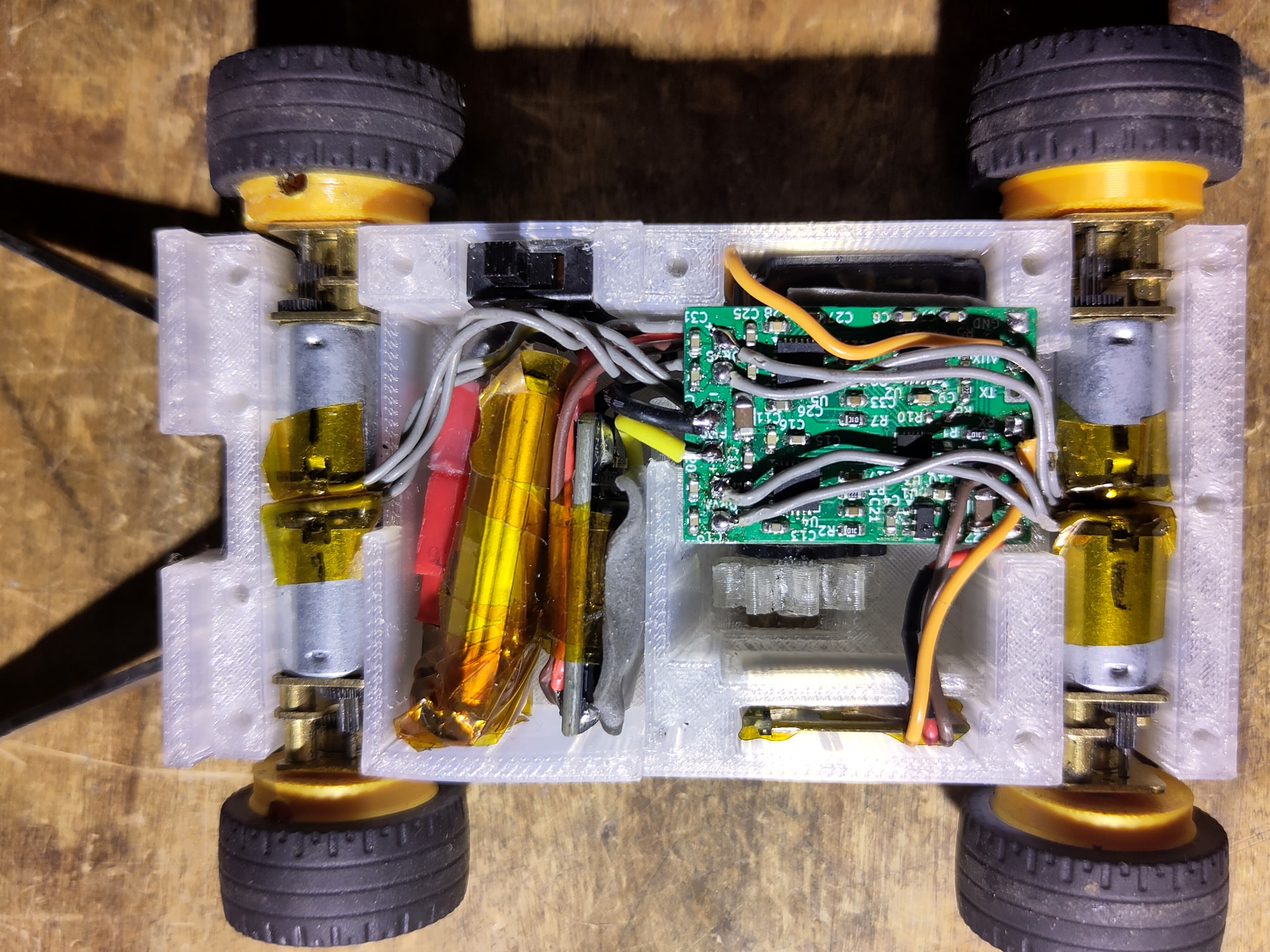

Inside were 4x Aliexpress 1000rpm N20s, a 9g servo, a drive board I slapped together to get a little more value out of a PCB order (otherwise you’re paying £20 shipping for £3 worth of PCBs), a flysky A8S receiver, and eventually a 1s lipo and a boost converter (dialled up to 12V) for ludicrous drive speeds. The weapon was pretty anaemic, but with the same stability control as the full size Fatal Deviation and four high speed N20s running at double their rated voltage it had a top tier box rush:
The drive was not just fast but also drifty - having a motor per wheel means that when a wheel breaks traction it’s allowed to spin free, no second wheel attached via belt or gears to slow it down. Unfortunately, good drive was all this iteration of the bot had going for it, and I was soon wishing I had a more powerful weapon. I kept finding myself in position to use the lifter, but then finding the lifter wasn’t actually powerful enough to really do much of anything.

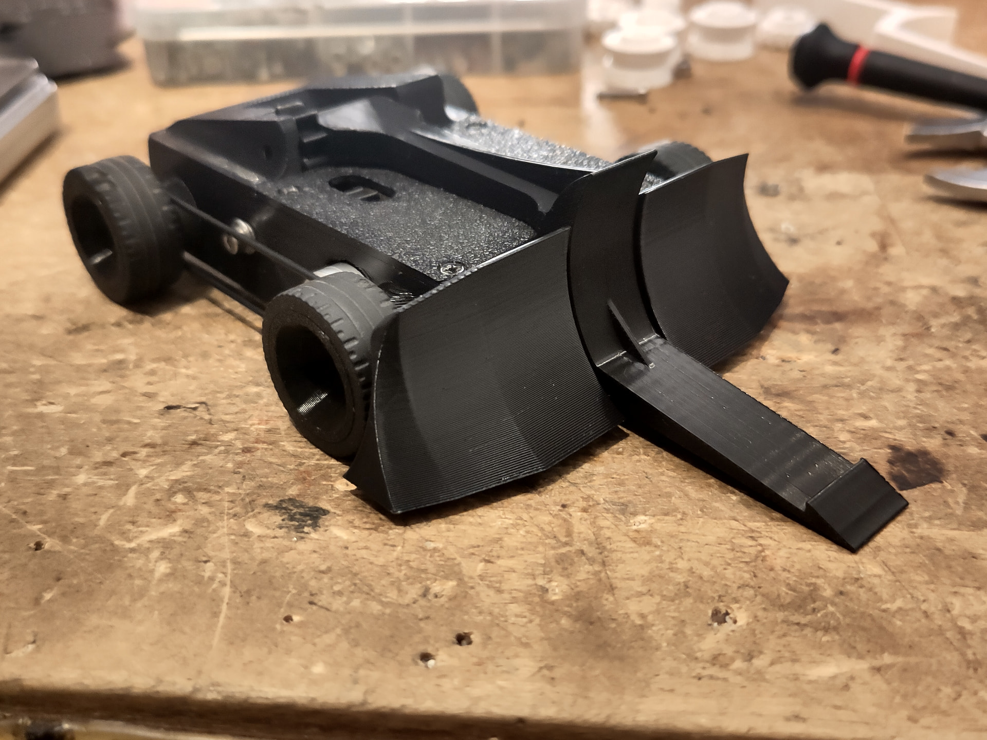

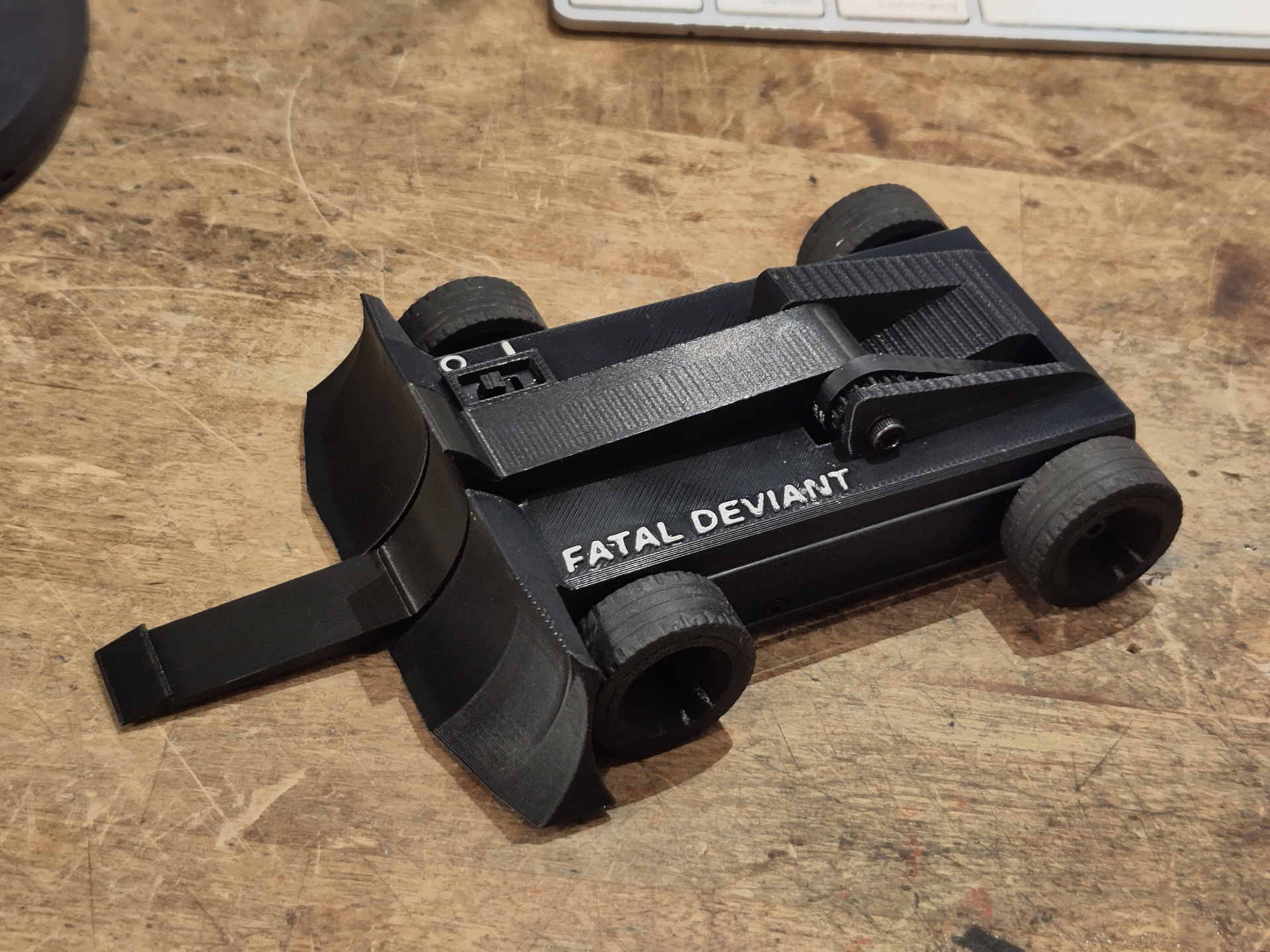

By this point I’d fought Birdemic a few times, and was deep into designing Ultimate Ninja, so fired up FreeCAD (for my sins) and applied some things I’d learned:

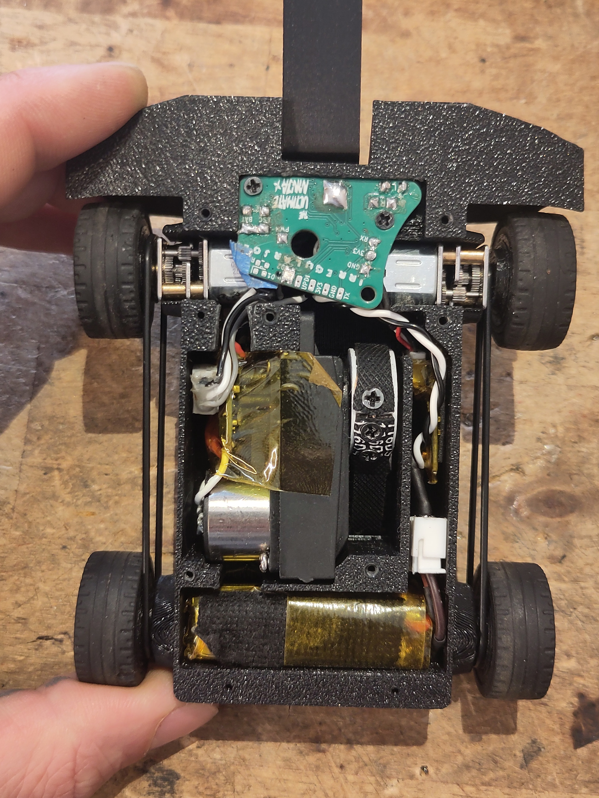

Birdemic showed me I could fit the important parts of a beetleweight servo inside an antweight, so I did the same thing again. This time it was a brushed version, using the standard servo drive board but with a coreless motor from another servo swapped in. The weapon arm was driven via a belt, giving approximately a 1.6:1 overdrive ratio to turn some of the excess torque the servo has into more speed. There was no way the old boost converter setup would work with this servo, so this version used a real 2S battery. To make weight and space for this I swapped from the 4x N20s to 2x BBB N10s, and the same bevel drive as Birdemic and Ultimate Ninja - now the same wheels and pinion gears shared between all three.

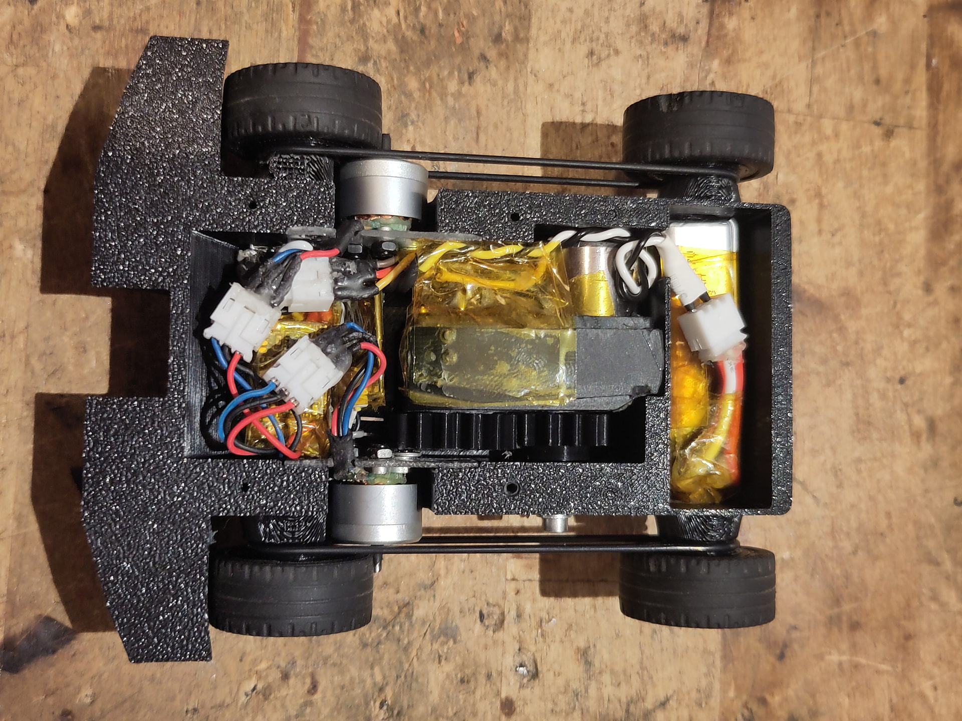

Back to 2s - perfect top speed with these 4300kv 1104s. Unfortunately the BLHeli_S firmware that comes on most small ESCs just isn’t up to low speed control, and there were multiple instances where I told the bot to drive straight, one motor started and one didn’t, and it turned 90 degrees and then drove straight into the pit. A shame, because it drove really well at higher speeds when the shafts still had their heatshrink on them. I also experimented with a gear-driven weapon instead of a belt, but it was heavier than a belt and still skipped.

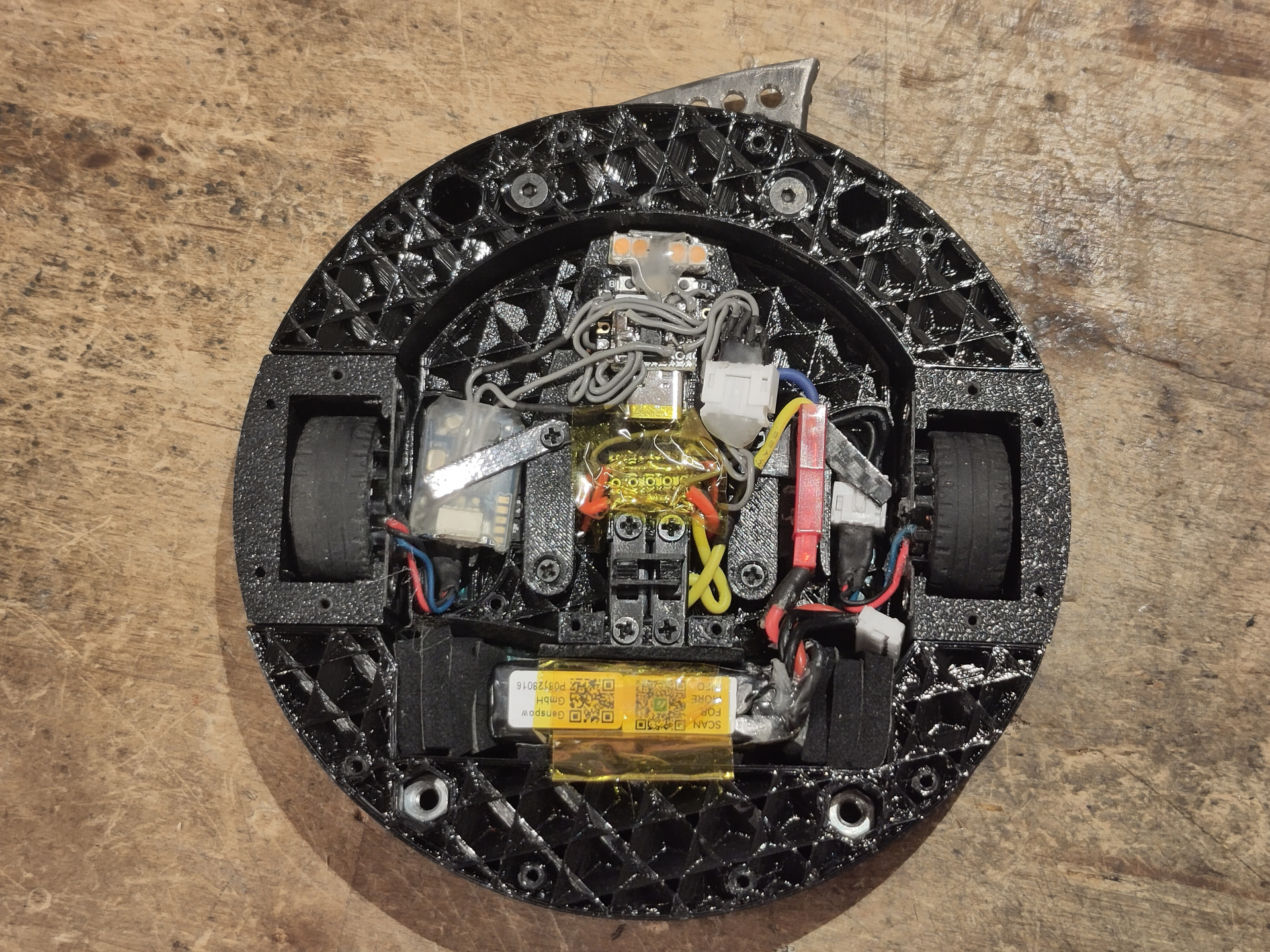

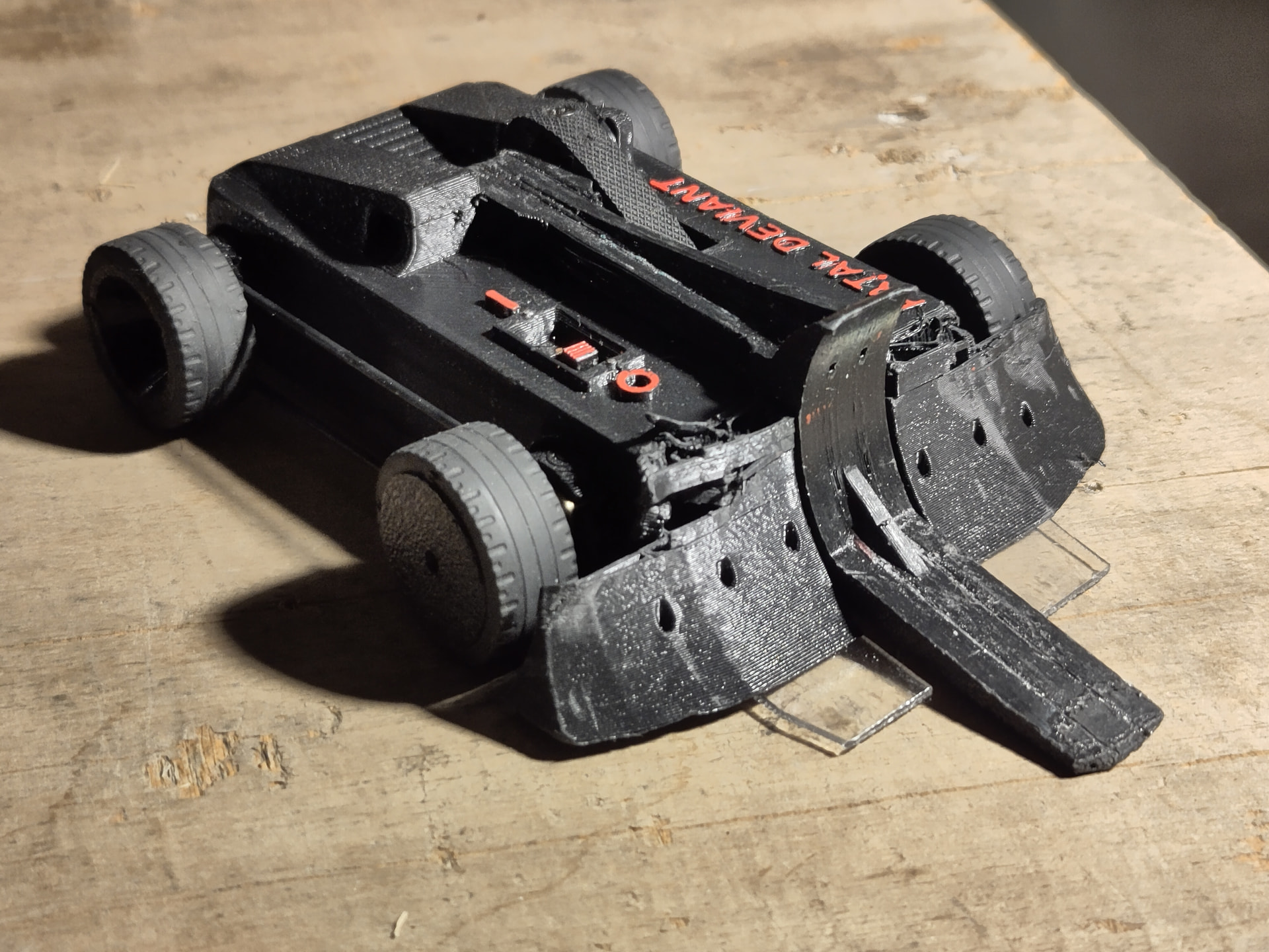

For the debut ARCS event I did yet another redesign, unfortunately it’s looking a little sorry for itself right now.

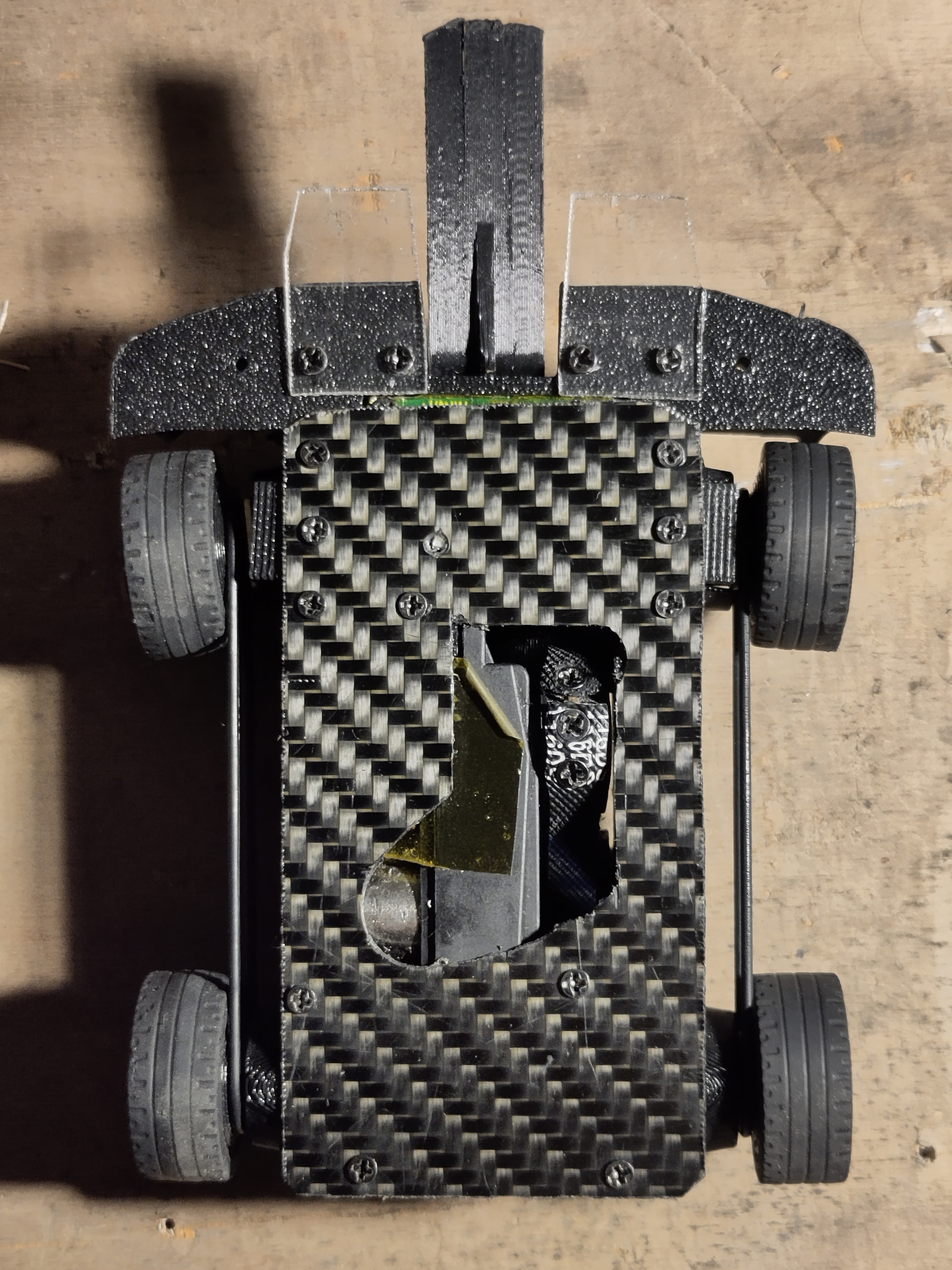

Like every iteration so far it’s a little shorter and a little wider. Back to direct drive, this time with 2x Turnabot N10s. Also back to 3s, and this time straight to the (different) servo PCB that’s perfectly happy at 3s. Bigger weapon belt, which is screwed into the pulley at both ends to finally solve the belt slipping issue. (Bonus, I no longer need to use specific length belts, I can just cut a length off a longer one and screw it into the robot). Now using a spare Ultimate Ninja PCB, since it’s much smaller and lighter than the old one I was using and also means I now have underglow!
The little polycarbonate dingii sticking out the front are stabilising forks, they aren’t actually for ground game. When the flipper fires the rear of the bot has a tendency to lift, to the point that some flips had the robot doing a frontflip. With the polycarbonate tongues there’s a contact point on the front of the bot that’s closer to the tip of the lifter, which reduces this tendency and both keeps my bot more stable and also sends more energy into the opponent.

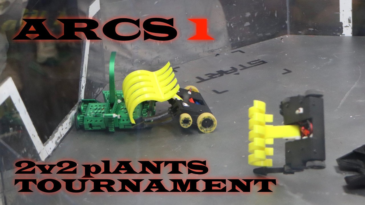

Best fight of the day for me at ARCS was this one where I manage to pull off the 2V1 win:

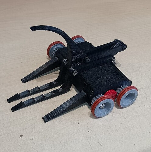

I recon with a forked flipper (like the herc lifter plate) you’d have an easier job of launching a bot streight..

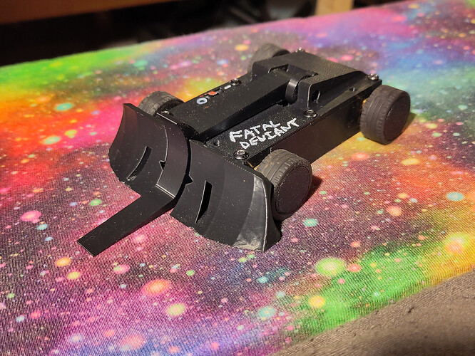

I do have a single barb on the tip of the fork (it’s no longer attached in that final photo but the lifter profile hasn’t changed much across the iterations), but I’m actually considering removing it. Watching my fights back I get a lot of flip opportunities when the flipper tongue slides sideways under an opponent (rather than going head on and dealing with forks), so I’m wondering if a flat flipper tongue that sits parallel to the floor would work better. Instead of relying on barbs I’m wondering if instead increasing the coefficient of friction on the top of the flipper tongue would help provide better energy transfer - maybe some foam, rubber, polyurethane, sandpaper etc on top.

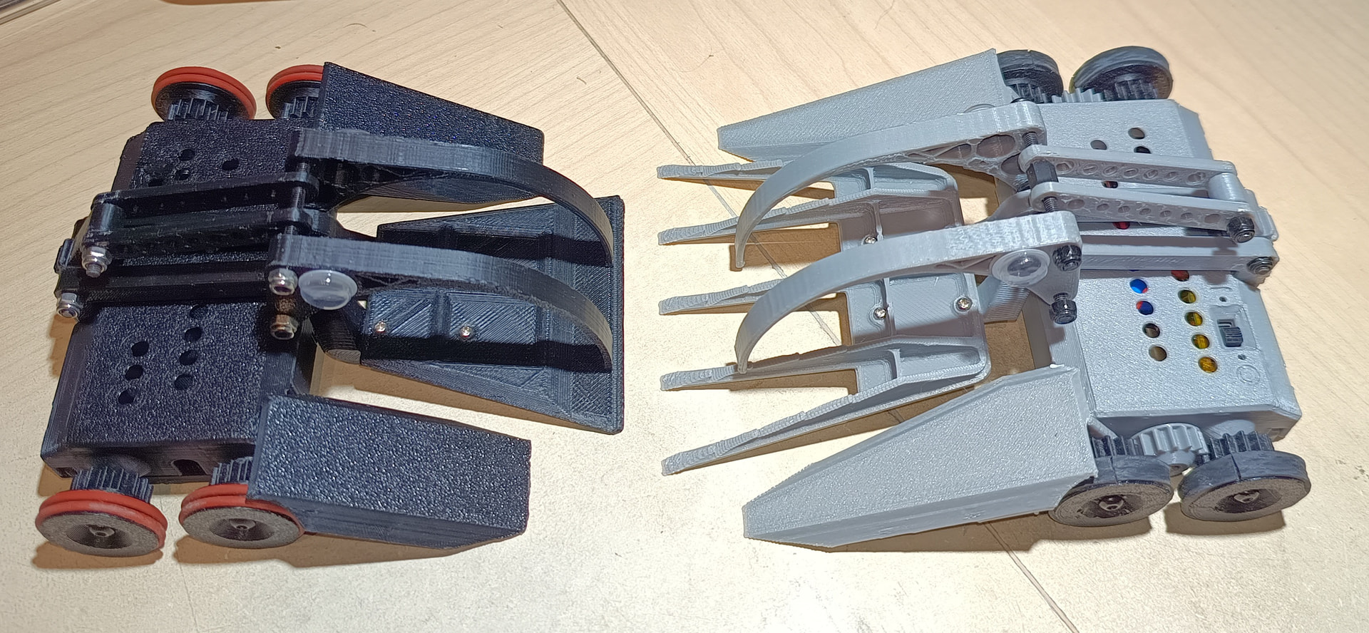

The lifter plate like on the current v1 or even the competing v3 was what I meant, so a flat plate with multiple forks, really good ground game and wide enough to hold most of a robot.
