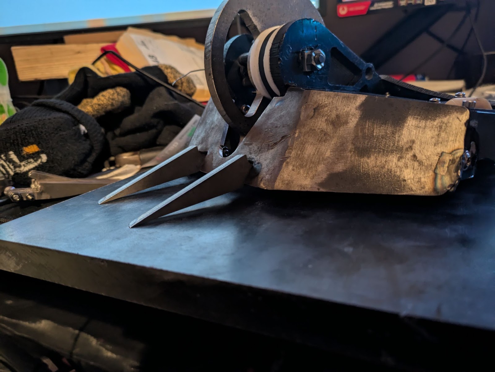

So with all that learned I started on the improvements which required a full rebuild woo,
So step one make it larger easier enough I made it about 6mm wider, and now this isn’t much doing so allowed better routes for both wires and more space for them, meaning I didn’t need to squash it as badly as before, it still wasn’t roomy but a lot better,
Step 2 weapon motor placement, this was easy, I just flipped to the other side, that’s it, meaning it stay tight even during spin down. It also changes the weapon motor yes the Emax was fine mine had lost a phase, likely from the abuse it got with Pesdo break but still needed a new one plus they weren’t rated as well as they once were, so I got myself two xing2 2405 only a tad bigger but lower kv so I needed a new pulley, which was counter bored and tapped by Sam threaded on and nicely held on but a grub screw to. I also designed a solid HDPE mount for the motor so no more melting issues, so that was everything covered.
Step 3 wheels, this was very simple, I asked Euan if he could print me some wheel cores from TPU, and he did, I recast them this time in 60a Vyta flex (I forgot to mention the others were 45a) which I had, they are much harder but again people had told me it was all ok. So wheels sorted

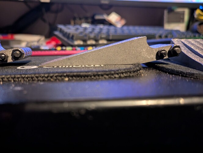

Step 4 Forks now this was the most important part better ground game, I moved away from the single screw idea as it was dumb. I designed two much more standard forks a short set and a longer set, doing this meant I needed to make new bulkheads to allow the extra bolt hole and as I needed to make it larger as well I redesigned the whole thing. A few things I changed is I made the baseplate thicker in place, as the bottom of the machine to the top of the drive holders was 30mm it made sense to change both to be 15mm apiece, this allowed the base front and wheel well guards to be the taller, which made it less likely for things to fall out or get caught, I also made the wheel clamp use 4 bolts rather than 3 as it loaded it more evenly.
As I needed new Forks I also got a proper bar cut at the same time as part of a group order, so I did and it themed correctly, however, it did have a slight issue being fairly soft.

While I was waiting for items to be made, I worked on new forks and wedglets. Talking to Rob of Boom Zoom, i designed a little longer much thicker and better designed forks, i also specialized them, with 3 types
Type 1
This is more general propose fork, one i would use against verts, wedges anything really, nothing fancy but should just work only thing is that due to it nature it forces the front armour higher than others
Type 2
Anti drum fork, this dork as dual chamfer fork, the first angle is steeper allow more material at the very tip which should make more resistance to curling and should chip more,
This fork is also flatter to the ground meaning the front armour wouldn’t be as high of the ground as type 1
Type 3
These forks are more out there, they are my attempt and being lowest, easiest forks to drive under people, they ave two stage design, first being the very low angle first stage which should slide under fronts, wedges, other forks if i’m lucky followed by a second stage which radia up to the tip would will lead it directly under the spinner at a lovely feed angle, i have no idea how well it will work but it is worth a go
All the forks are 6mm and have a lot more material around the bolt holes as issues with bending at BitB 3 cost me dear so these will not bend without catastrophic failure.
