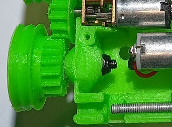

No big dill my 2nd ant bot a, what I like to call ‘sometimes suplexer’
I print 5.6-5.7mm hex sockets in the chassis to hold the nuts in place on the end. (this is what I use for Hercules’ axles with Nyloc Nuts)
Its similar to having threaded inserts but stronger, reusable (if the chassis is smashed) and the nyloc nuts mean they don’t unscrew.
If any of that helps you’re welcome to it!
noted!

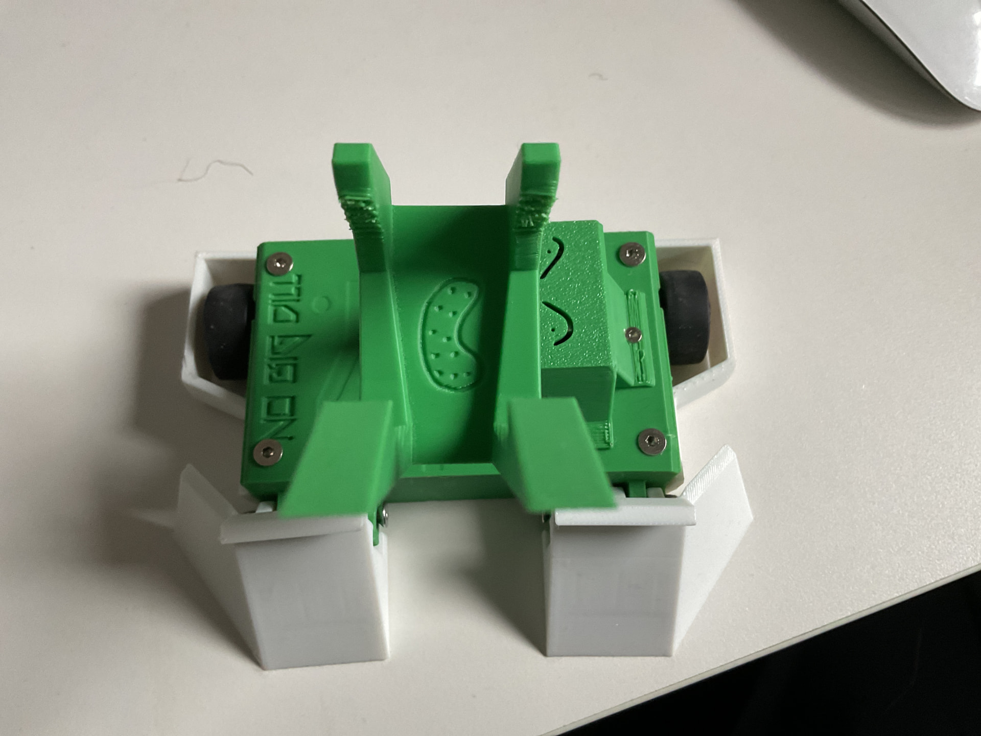

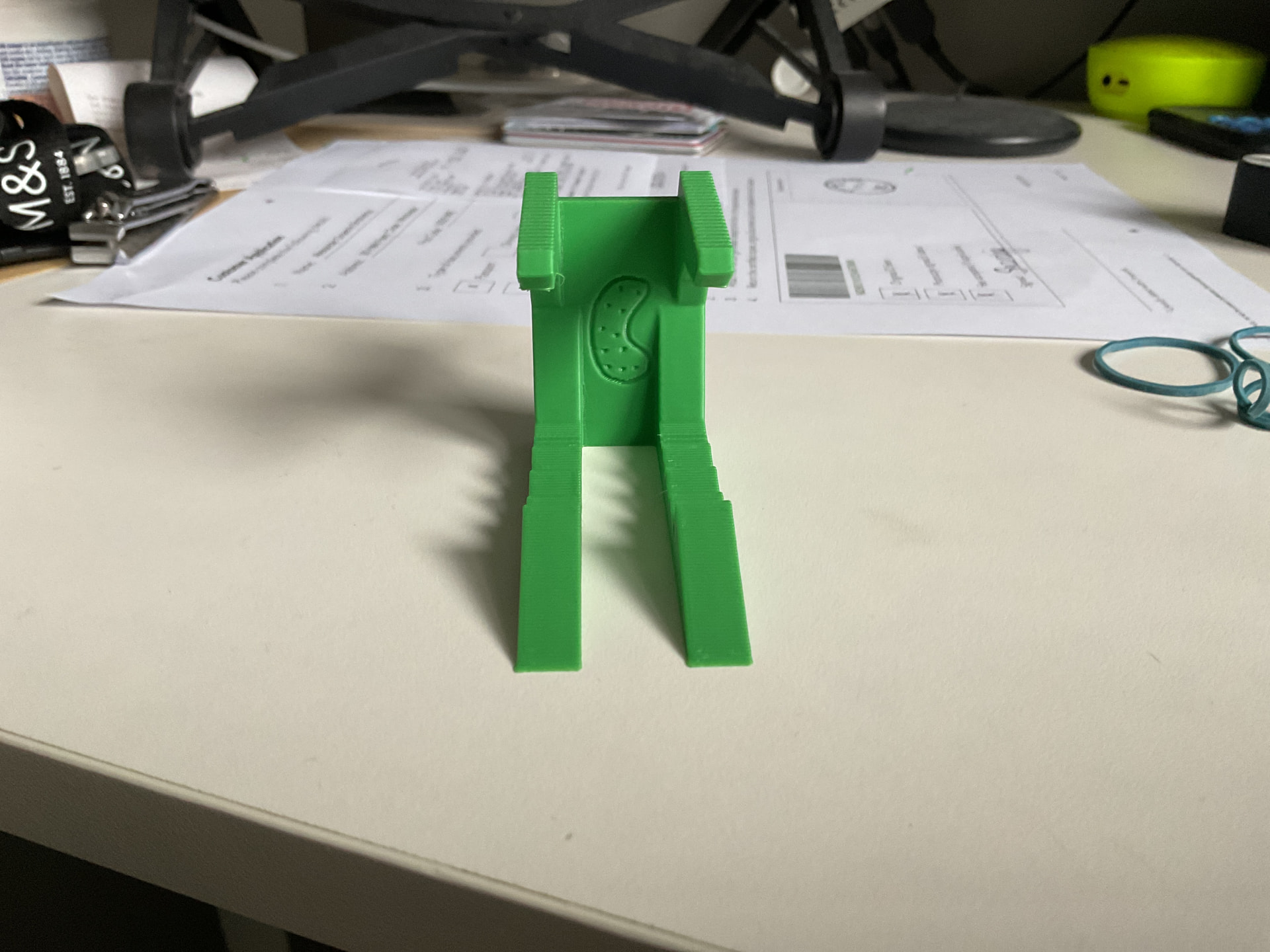

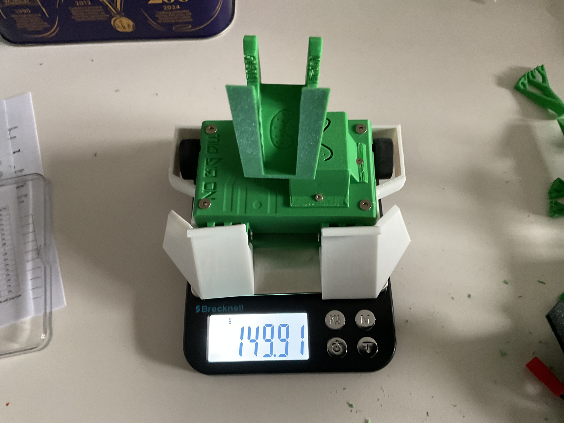

And now I present to you…

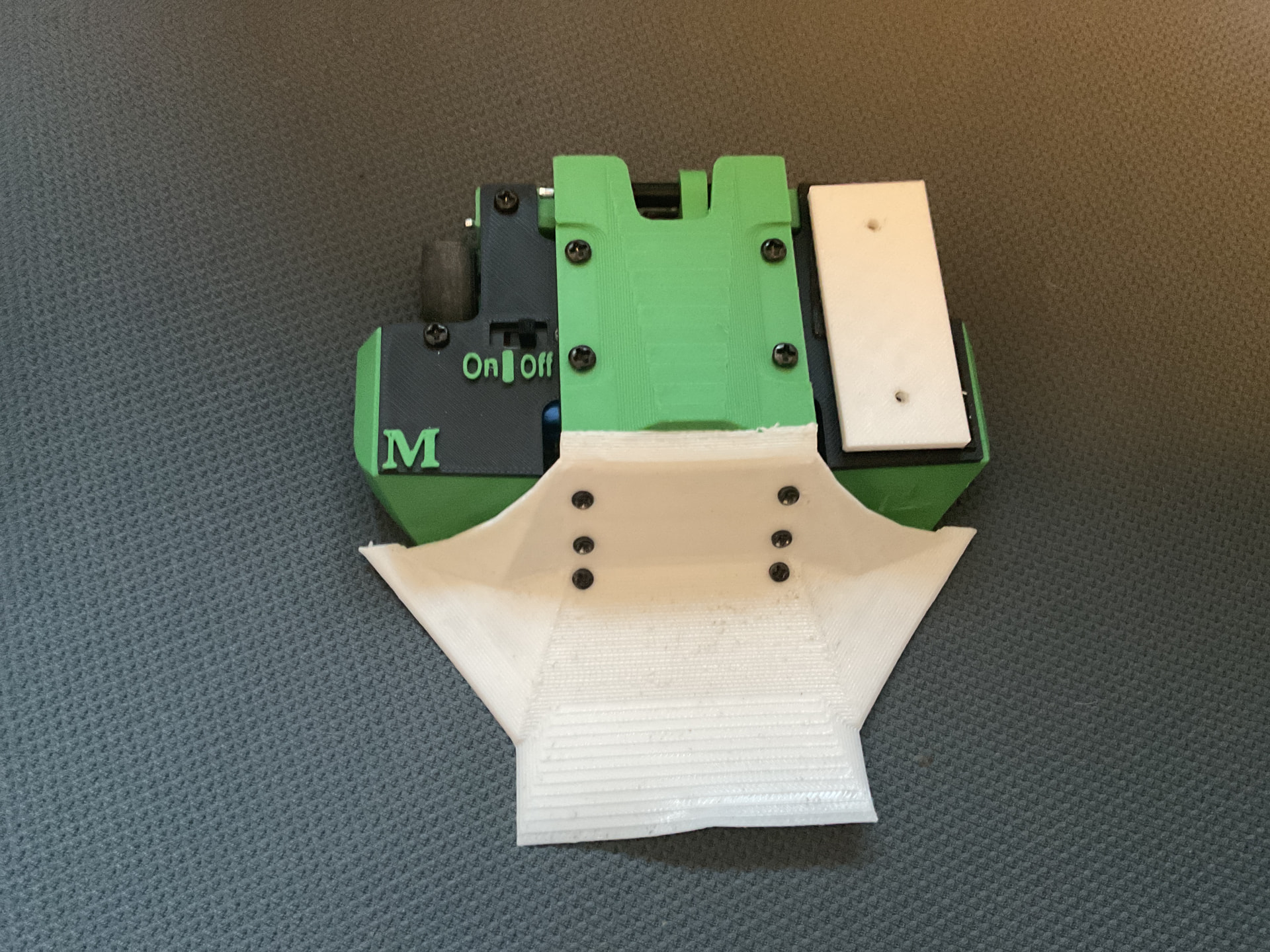

NO BIG DILL V4:
It took a bit longer to assemble as expected due to being 2g overweight but I’ve made some minor adjustments and it now sits at 149g on the dot with the heaviest setup attached (wedge setup pictured above). There is a few screws that are a bit long so I could attach them but I can’t really be bothered to go through the hassle of taking off the motor mounts then attaching them again with new screws. For now I will just hope Ben G’s scale is reading the same as mine…
Anyway I just wanted to ask, the lid is a bit thin on NBD I think 2mm. Obviously if you managed to read the paragraph above without falling asleep, you will know that I don’t really have the weight to thiken it/ add metal plates. So I was thinking, if I faced a hammer saw at the upcoming GRoCS that I could just run one tpu fork on each side and screw on a extra 2mm of a plastic on the lid with some plastite screws. So my question, what plastic do I use? Really my only options I have available are tpu, overture super pla+ and I also have some sheets of polycarbonate from bbb.
Thanks for reading,
Hollis
Hi,
If the alternate configuration still fits in the box and is in weight then you’re fine to swap parts.
Obv. if you swapped a hammer saw for a plants fight that wouldn’t be sporting… :slight_smile:
Hi, Guido runs a 1mm lid. Shouldn’t be a problem as hammers that can do damage are pretty rare.

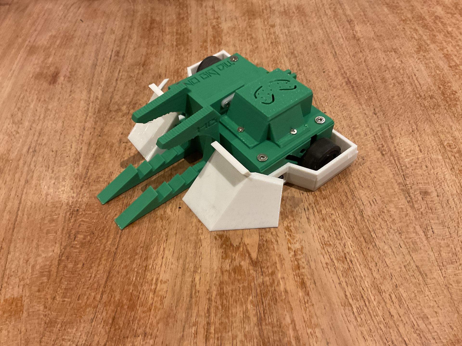

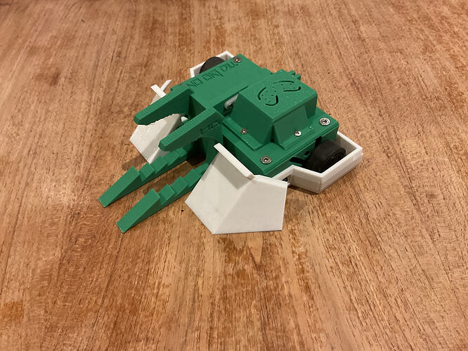

Quick update,

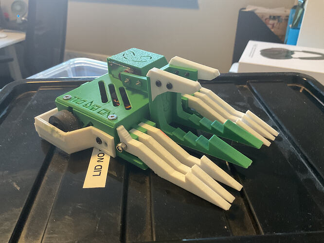

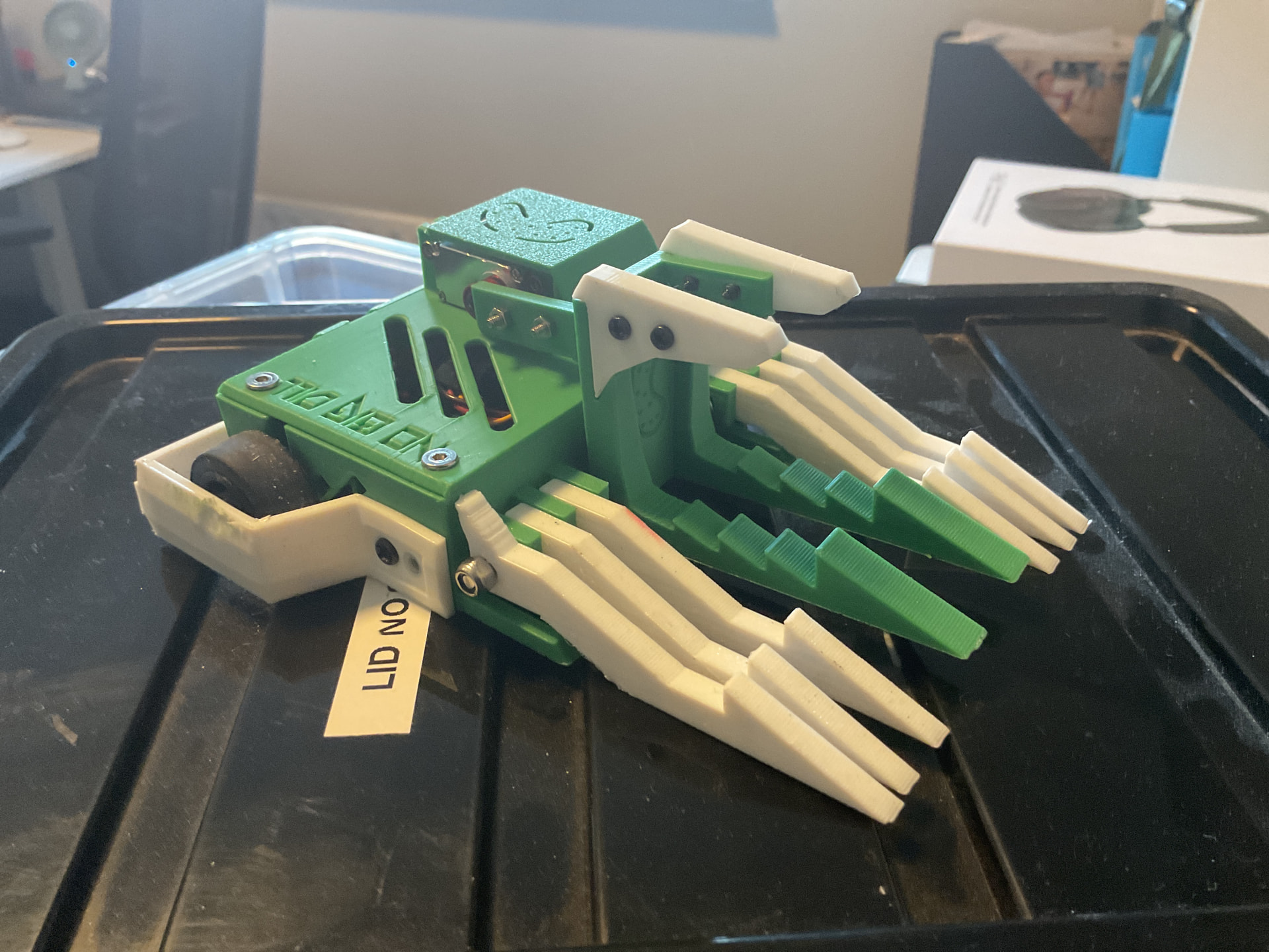

I did change it:
before
and after.
I mostly just made the sides thicker (where it was breaking)
BUT…
My big worry now is, well, have a look for yourself….
I could make the main body smaller, but I might just hope that Bens scales will be nice to me at GRoCS. It may weigh slightly less as I don’t think I’ll run the wedges at GRoCS due to the fact that this NBD will be entering plants in march. It’ll be making way for a new robot that I will reveal
Hollis
I’m sure you could easily remove a gram from somewhere. Even by hand with a scalpel maybe.

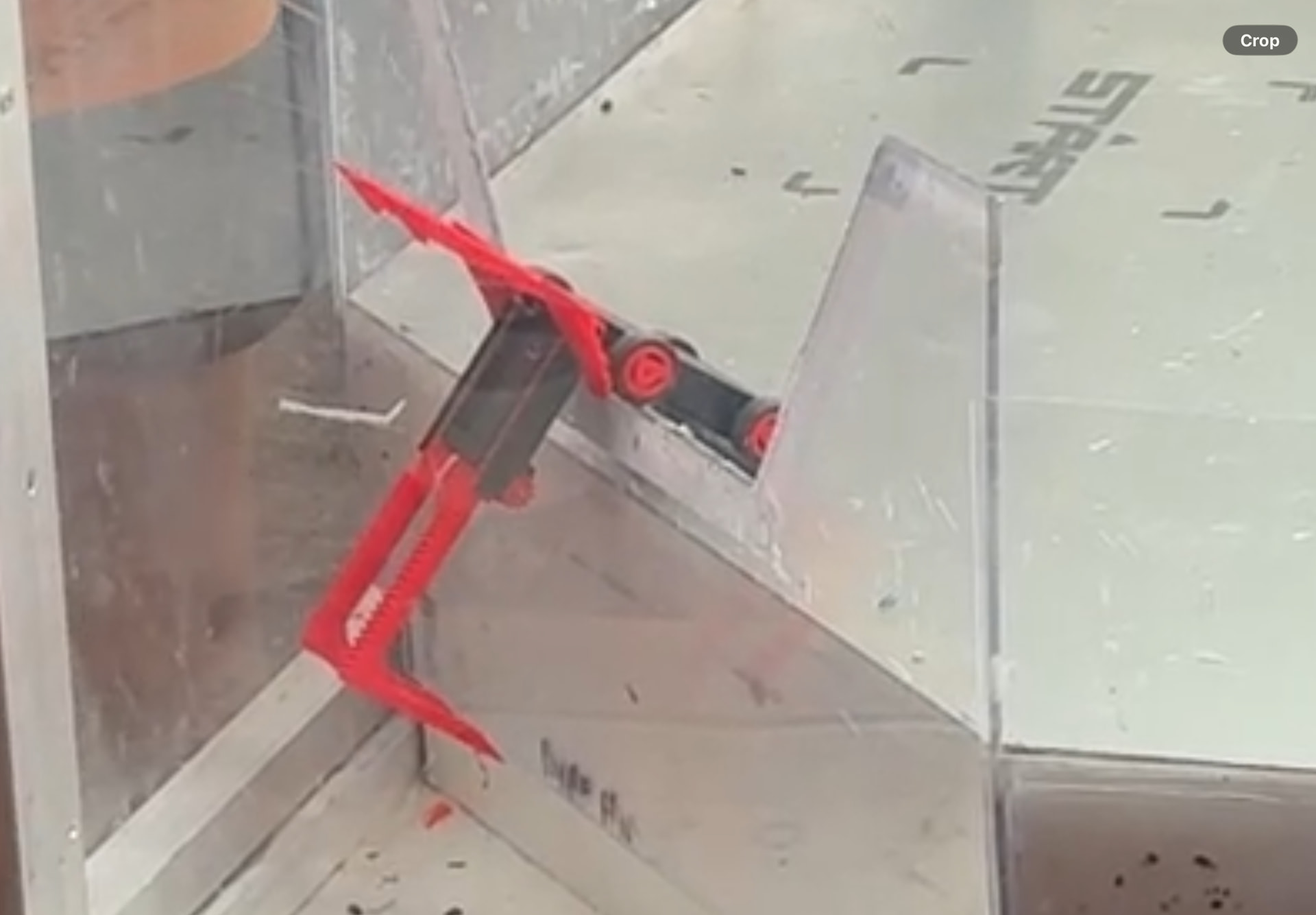

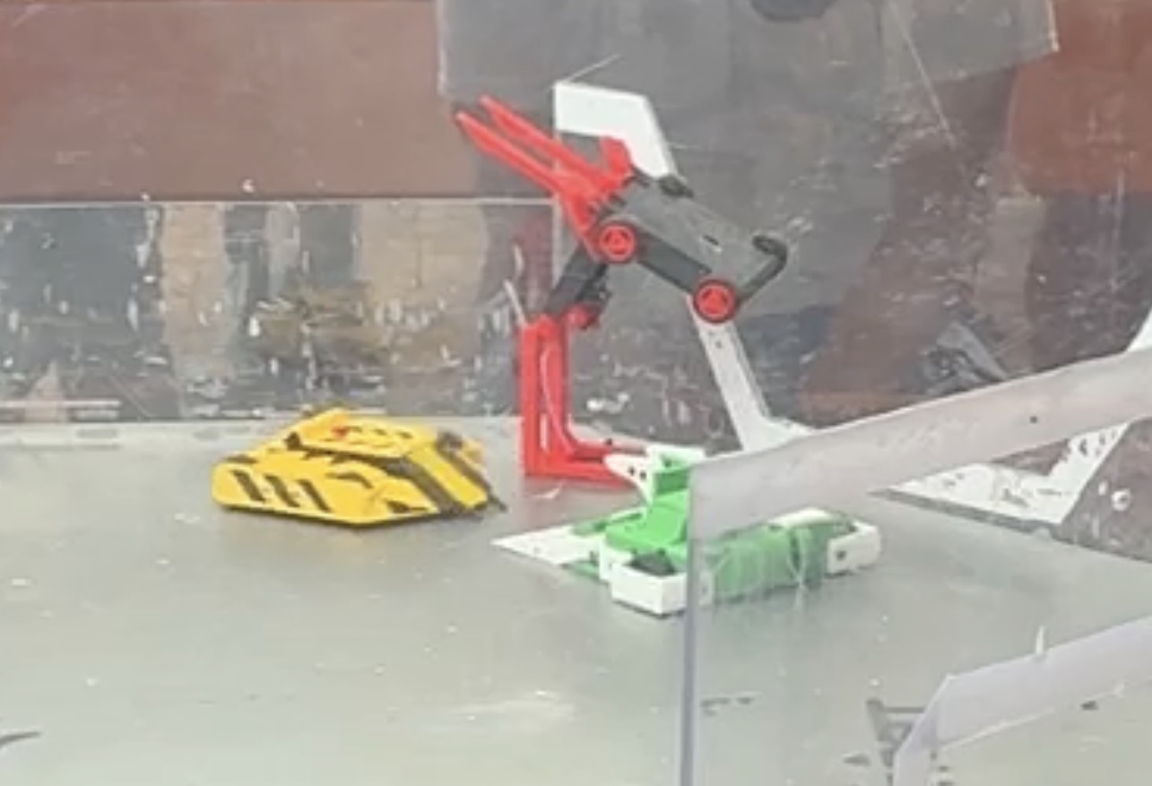

We went 3-1 in groups. Not to show off or anything but I did most of the work, my sister still needs some practice driving. The first match, gecko fell out in the first minute but I managed to put on a great performance, granting us the GD. In the second match we faced of against Phoenix and his terrifying plastic hammer saw, and (I forgot their name, sorry!)'s crazy sit and spin. The match started okay with me getting a few flips, Phoenix with some near miss slices and the sit and spin, well, spinning. Eventually I got a good push on Phoenix and after some messing around near the pit I got him out. At the same time, the sit and spin had been switched off! The third fight was against Craig’s really cool looking anxious and joes amazing forklift robot. The match was mostly me having the ground game on Craig and going to work, while after around a minute, Joe got stuck like this:
Then in pushing Craig out, I got stuck on the edge of the pit drop off. This lead to some confusion because I believe Joe hadn’t been counted out for reasons I’m unsure about. But he just tapped out, which was nice :+1:.

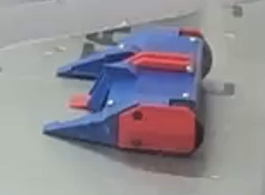

Also, at one point in that fight, I got one of my favourite ever flips with NBD, landing Joe like this:
:joy:

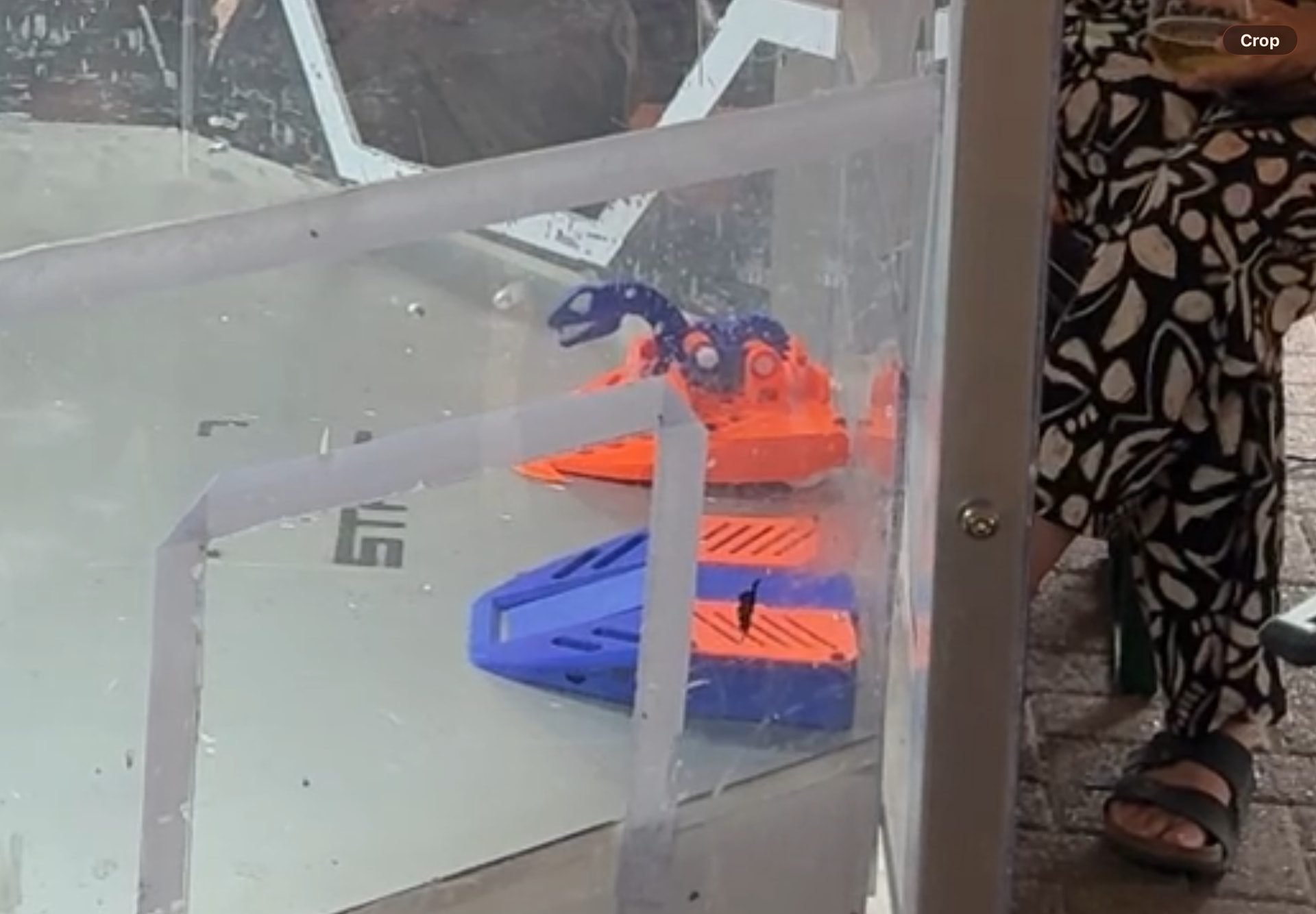

3rd place match was against fatal deviant and this lifter I didn’t catch the name of:
The fight started with that lifter :up_arrow: immediately pitting gecko, then I flipped out fatal deviant and after some close moments i managed to set the lifter up upside down in front of the pit for an easy push out.
