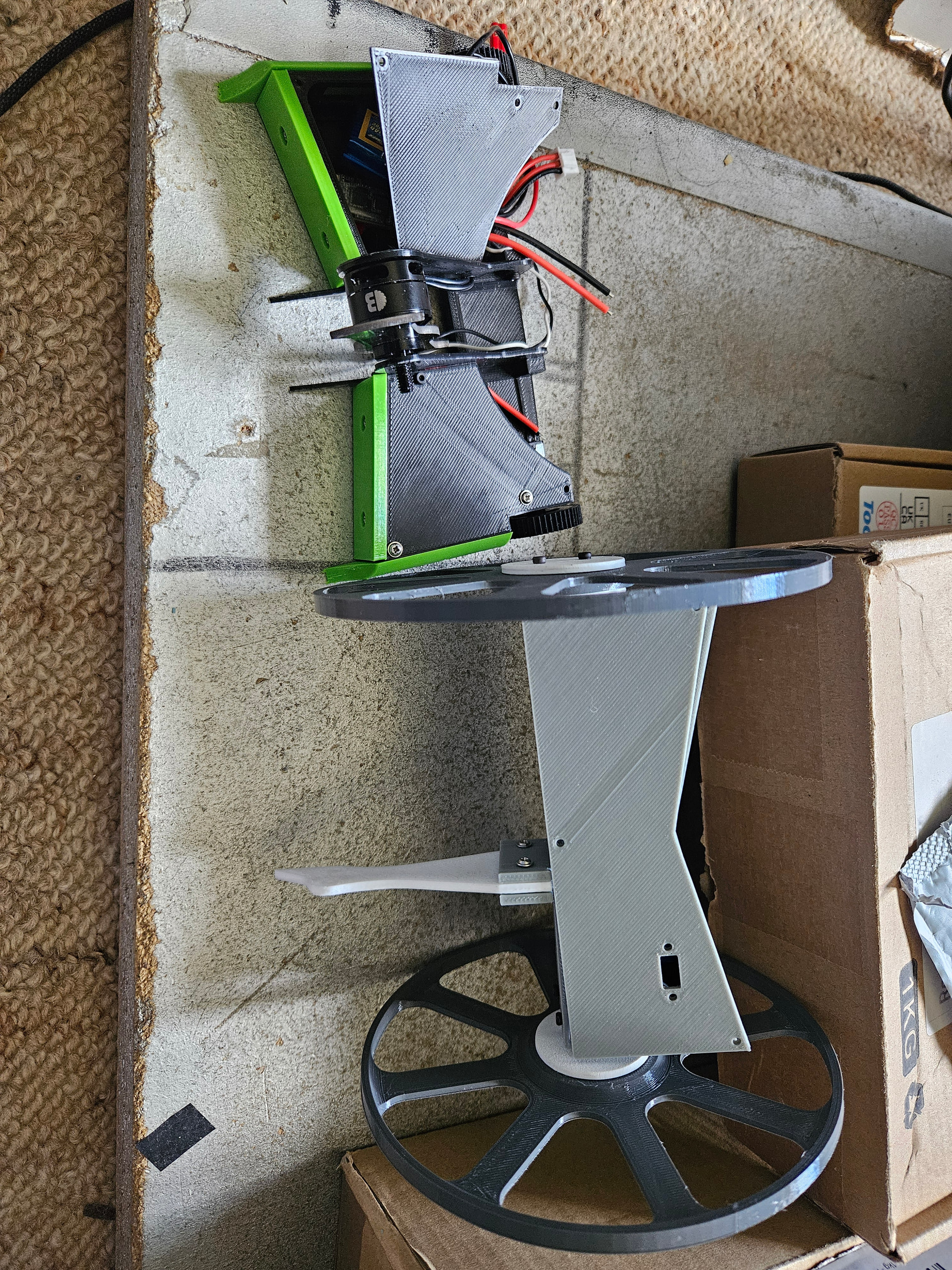

no real post today, just wanted to show off the two before i properly get them ready. Somatic Damage on the left and my new bot Elephant Wheels on the right! its probably going to be overweight when its weapon arrives but, oh well… its not entered into anything at the moment (but will be in the future) Its going to be an overhead spinner similar to Starchild. Does this idea even work at 150g? god i hope so…
i’ll do more of a showcase of the bot when its all soldered up and ready, but its been a lot of fun designing it so far!

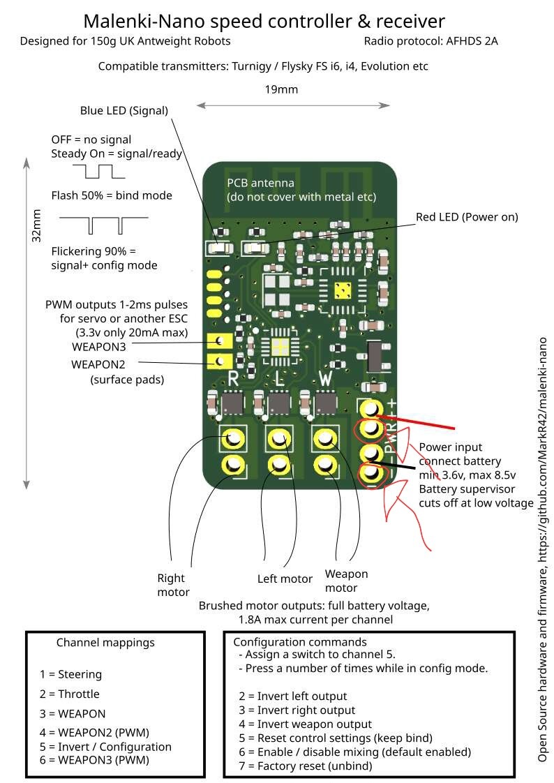

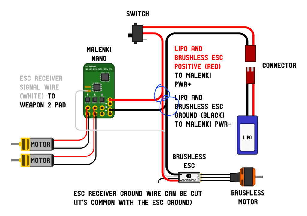

I just wanted to ask, since its my first time soldering up a Malenki Nano, what is this second pair of tabs on the MN’s power tab for? Just curious, thanks!
Those just duplicate the power inputs. You can use them for distributing power e.g. to a servo or brushless ESC (or flashy light, or anything else you want).
ah okay, sorry if this is quite literally what you just said, but does that mean you can connect these two connection points into the malenki rather than having to solder the black and red wires together seperately? just trying to be sure since i’d prefer not killing one of these a week before an event haha, plus the latter is what i’ve been used to doing before when using the BBB dual esc’s. I hope all that makes sense!
Yes you can absolutely do that, but I wouldn’t want you to break the board, if you’re happier with joining the wires, do that instead.
ill give it a go with soldering the wires into the malenki if thats the case then, i was watching a few vids from Turnabot about soldering the malenkis up and saw them do something like that with a servo, as long as its something i can do that does work, then i’ll happily give it a go! Would definitely be a lot easier than trying to join the wires up since that can be quite the nightmare sometimes… Thank you for letting me know :slight_smile:
