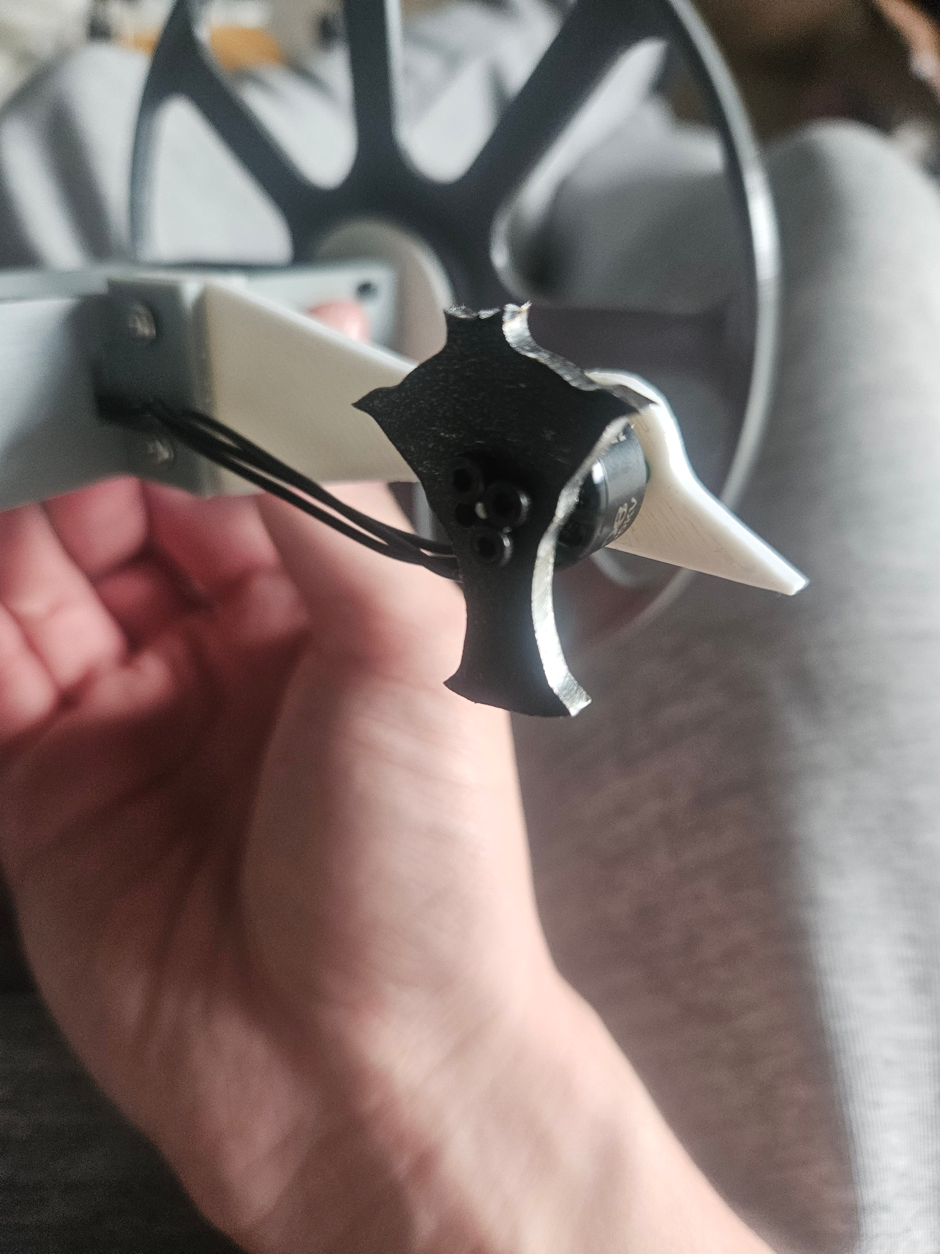

Elephant Wheels’ weapon arrived today! Not only does it look quite snazzy (Thanks Team ULL!!!) but it also DOESN’T hit the floor either!
I’ll be getting them soldered up right after Somatic Damage, knowing now how to solder up a Malenki Nano is going to make it a lot easier for this one, so thank you everyone who made the suggestion to swap AND to Mark for the help with queries :slight_smile:
I have a new set of body and wheels for this one coming hopefully tomorrow since the bot is currently overweight, but after that all is good!

probably a silly post here but, have you ever considered that there is a chance that elephant wheels could get stuck sideways? maybe you could put something on the end of those wheels to prevent from the thing.
If it did ever get stuck, I think all Elephant’d need to do would be to spin around. Eventually it would topple back onto its wheels, similar to a virtual bigwheel I run.
yeahhh i considered it quite early into the design, at first i had a sort of curved Pyramid in the middle of the wheel hub but i realised it basically did nothing to stop the thing from happening, problem i have is trying to think of something like that whilst also keeping it in weight AND the size limit. Currently my best option is praying but that doesn’t really hold out too well in the arena…
I’ll have to see how physics allows this thing to work when i wire it up… but yeah i considered it, but i’m unsure how to tackle the problem
thats kind of the most i can hope for yeah… is that the weight & spinning speed of the arm is enough to throw me around and help me self right, will have to give it a test

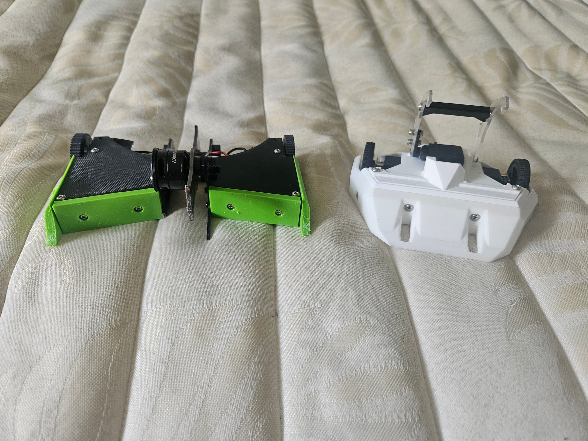

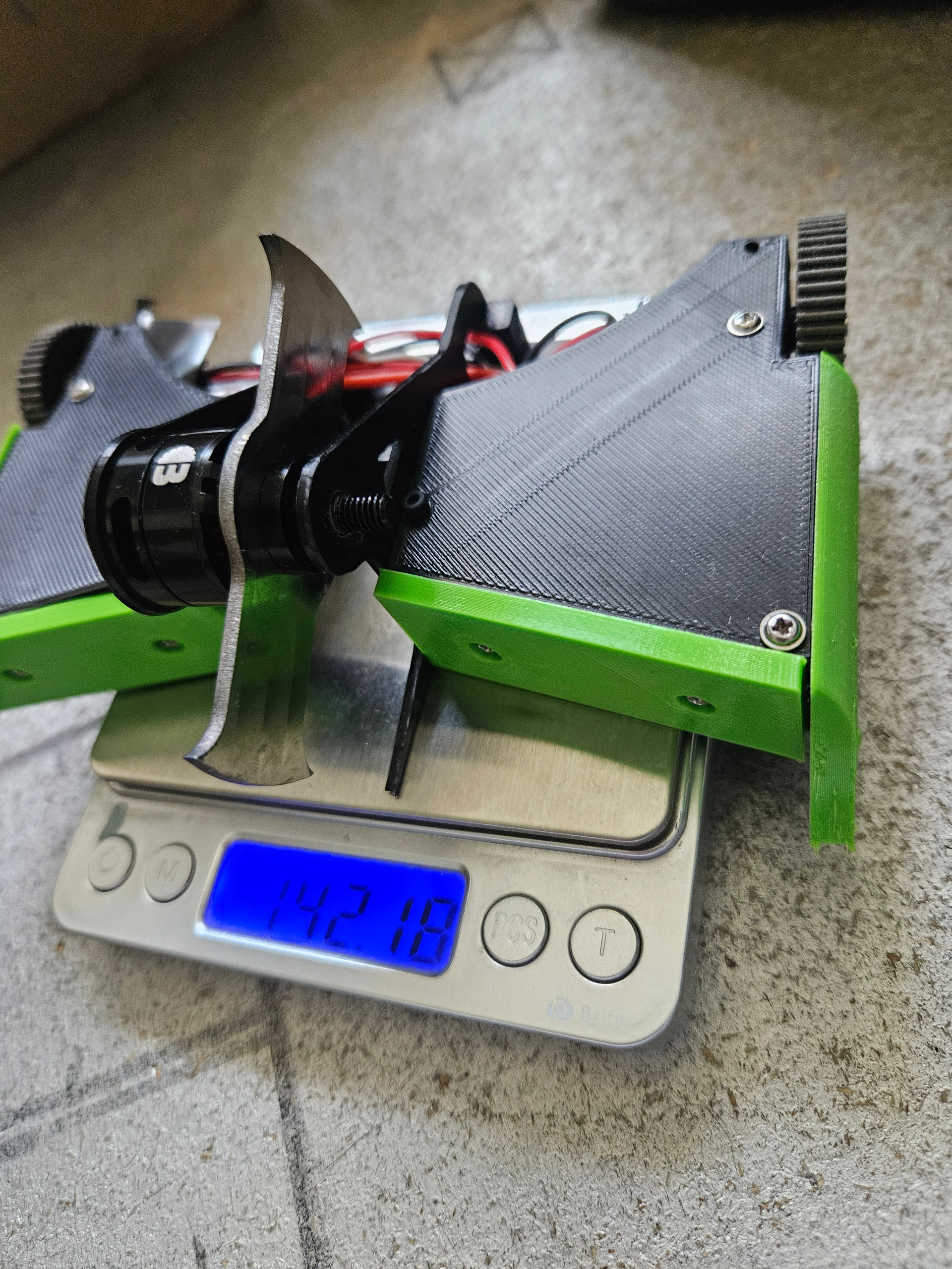

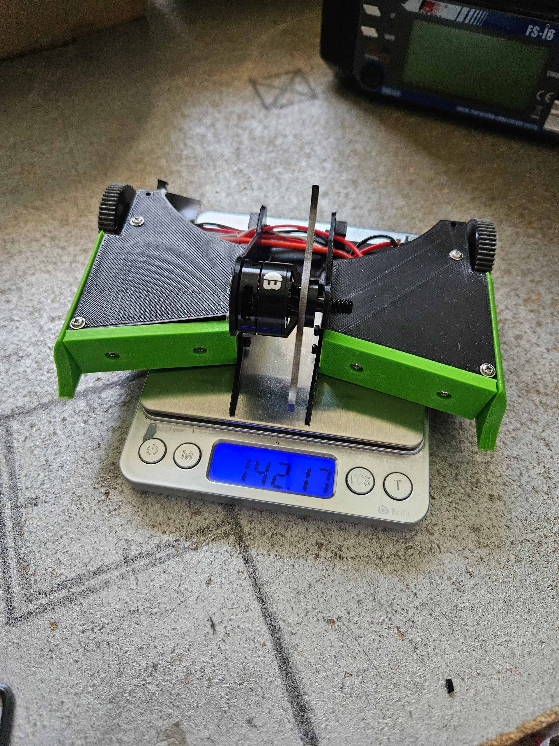

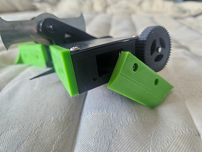

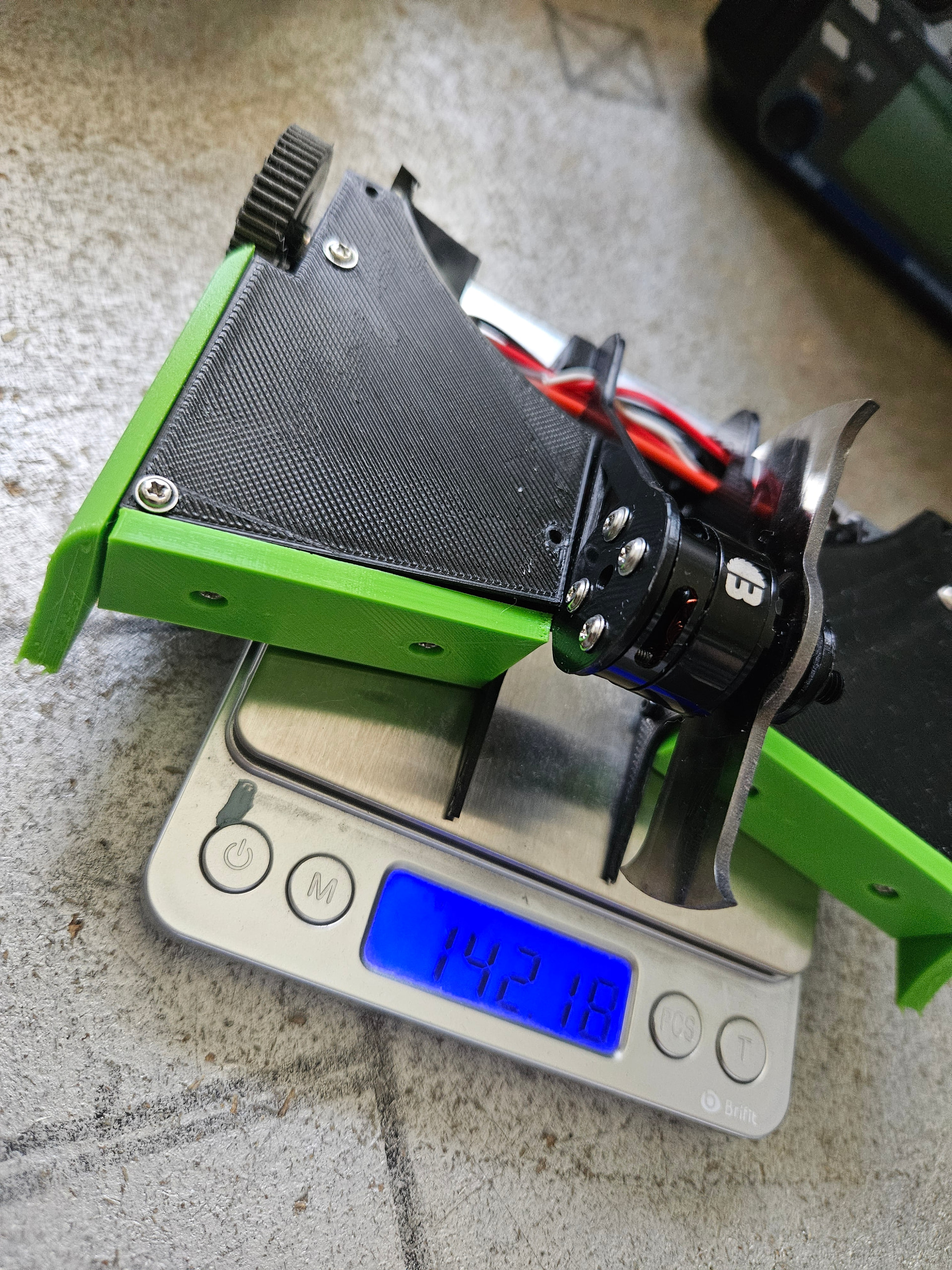

First of all, Somatic Damage is done AND ready, heres how it looks!
the robot is 8g underweight! which is honestly insane, super happy about that! I have upgrades in mind, i’m worried about how thin the weapon mounts are, so i’m likely going to revert back to the old thickness that they were at before, and then add some polycarbonate forks to the front, other than that, no other upgrades currently planned, i really like the direction this bot is (hopefully) heading!
It does seem to swerve to the side a little sometimes, i’m unsure if thats a trimming thing or something else, but its a little late for redesigns atm so lets diagnose that one AFTER GrocS.
Will Somatic Damage actually do well? will the weapon mounts snap? Will i actually be able to face a robot thats not a horizontal spinner? i guess we find out this weekend…

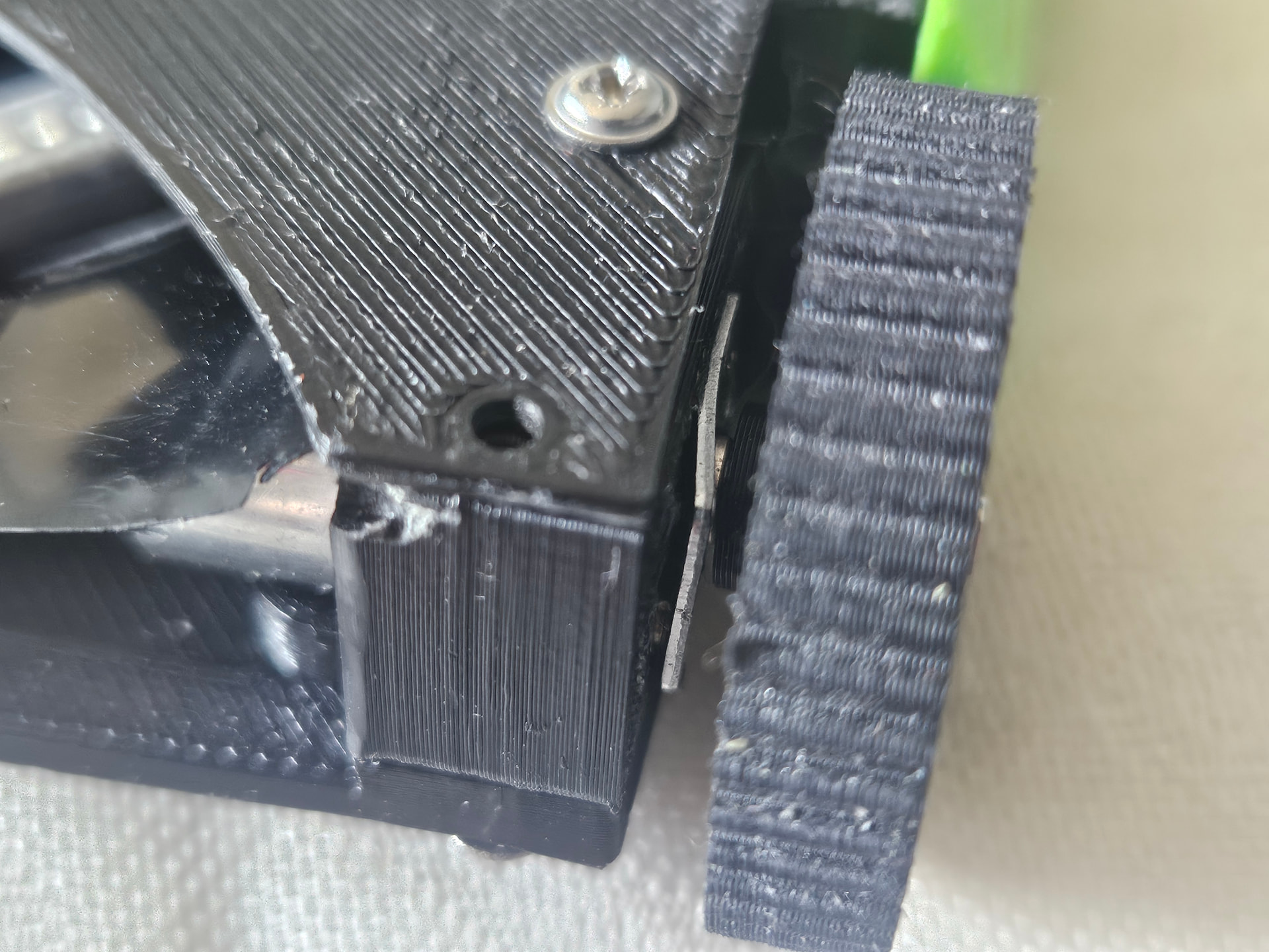

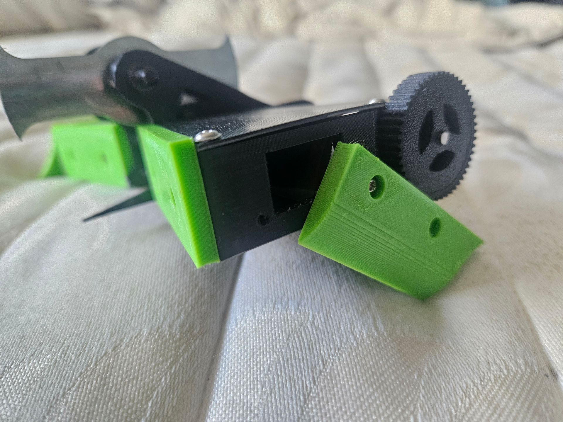

Maybe you should think about screwing that other panel down.
yeah, i tried screwing it in since there is a screw hole, but something seems to have gone wrong with the print and i just can’t get a screw to go in there, which sucks :confused:

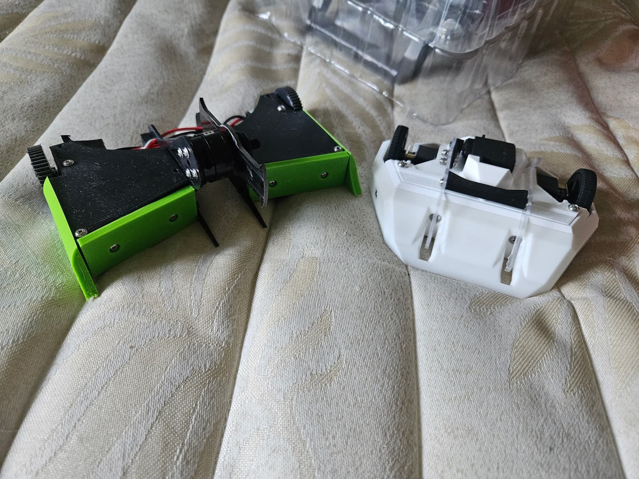

Somatic Damage and Nom 2: Nom Again are ready for GrocS today!
Unfortuantely Nom isn’t sporting its signiture(?] head, since i’ve beek working on a design for one that should make it more competitive, but keep it looking silly!
Elephant Wheels will unfortunately not be there; i thought itd be best sinfe the weapon arm seems to be under a lot of strain at the end, so i feel like theres no point rushing ot to be ready for whiteboards if the weapon snaps off in one hit… The other two will be up for whiteboards though! (so long as they are intact by that point)

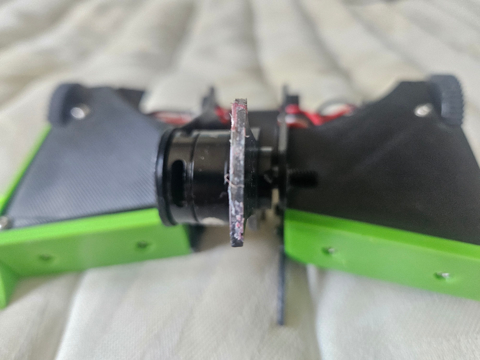

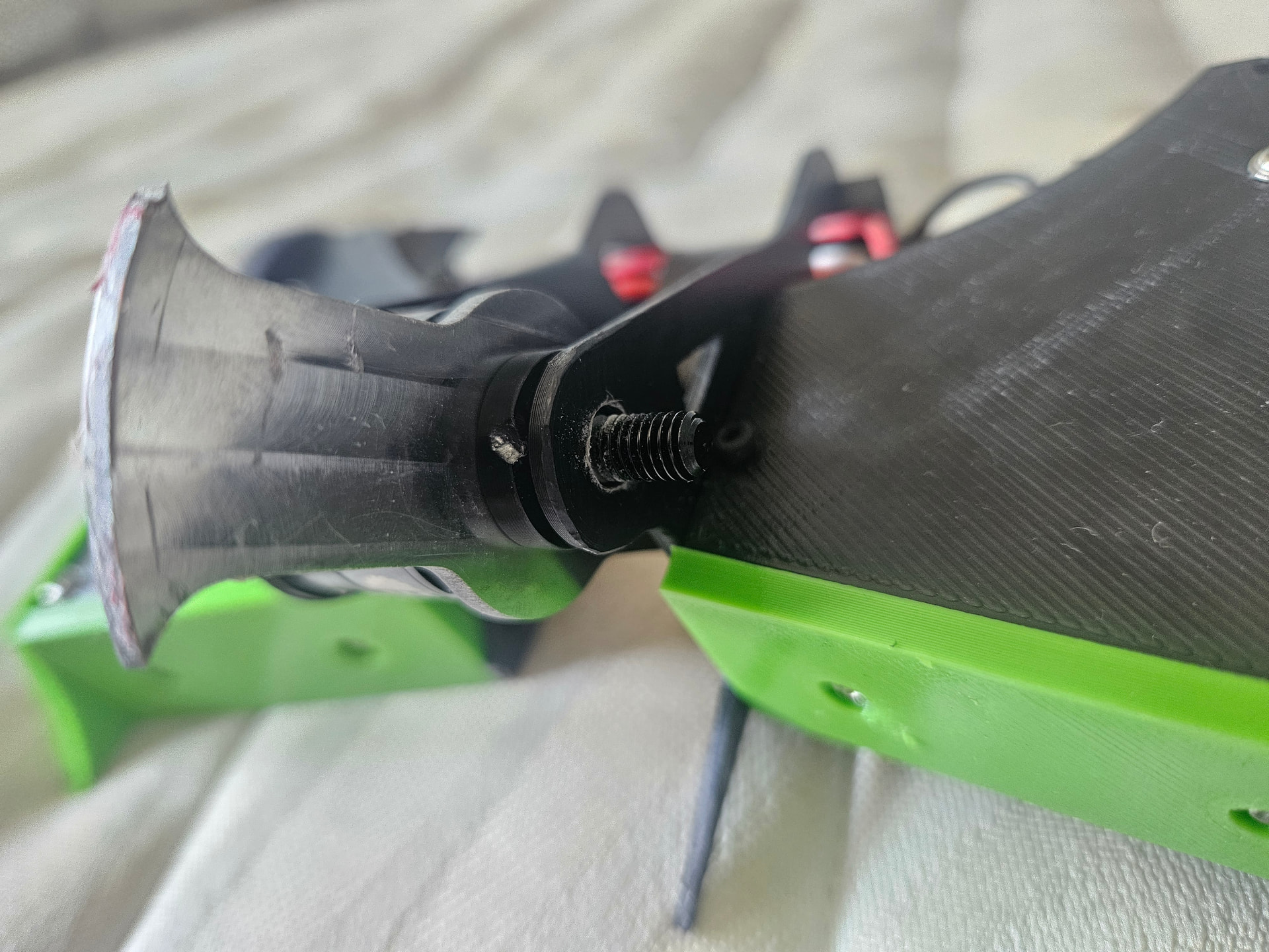

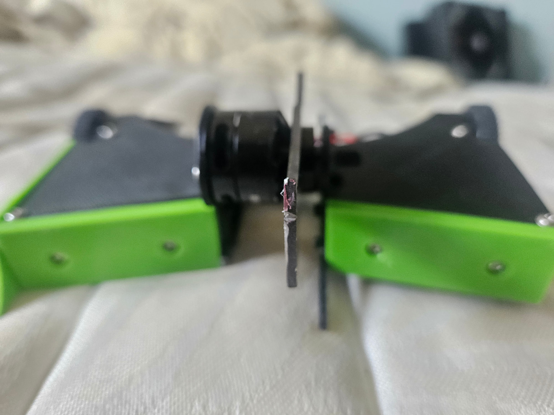

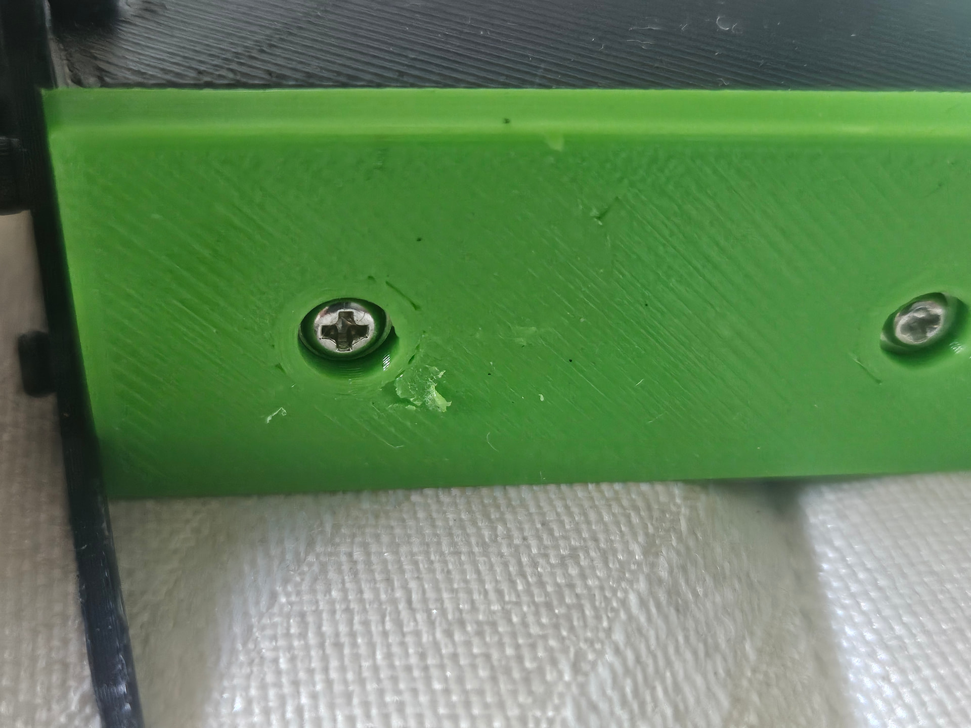

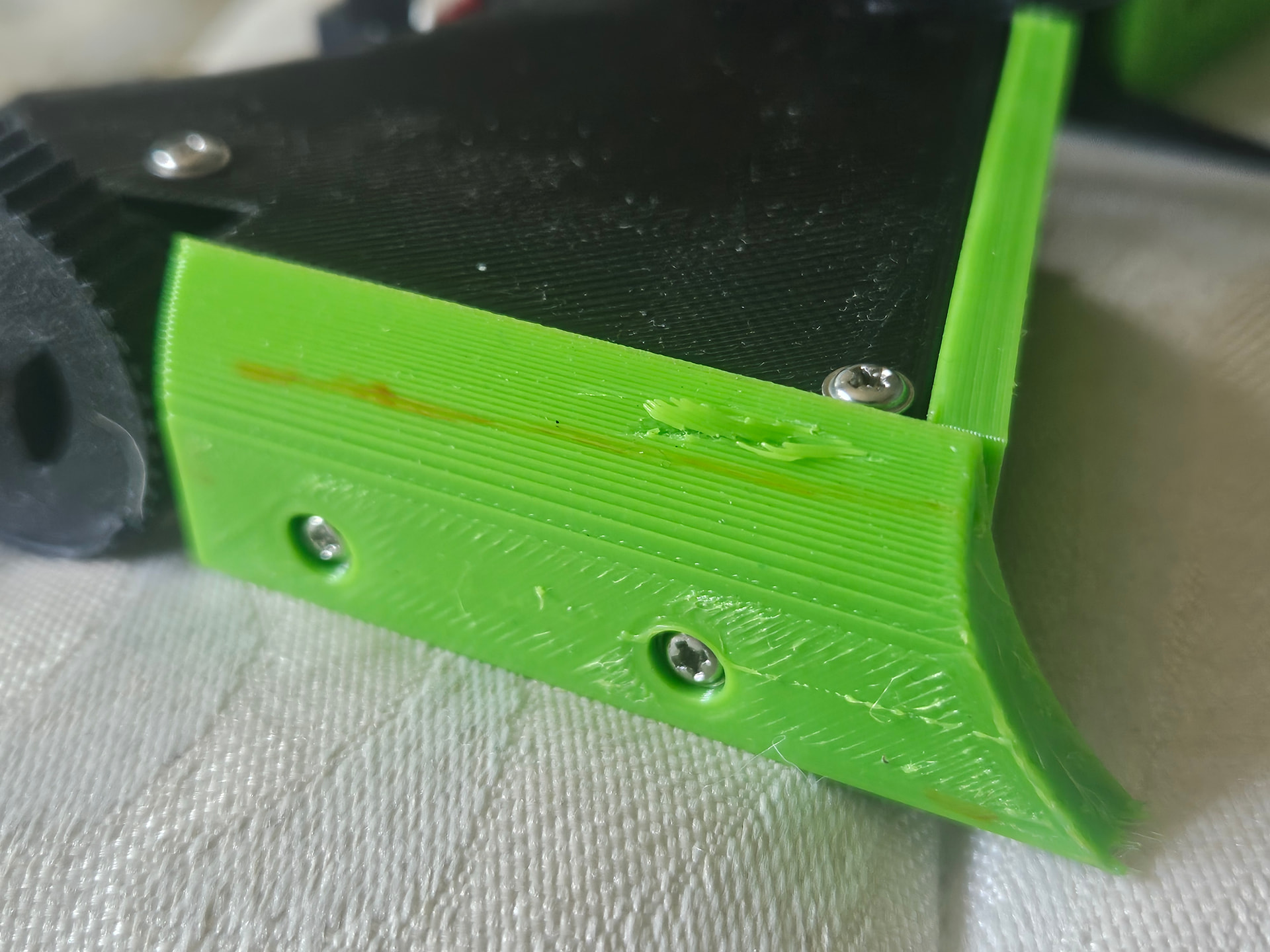

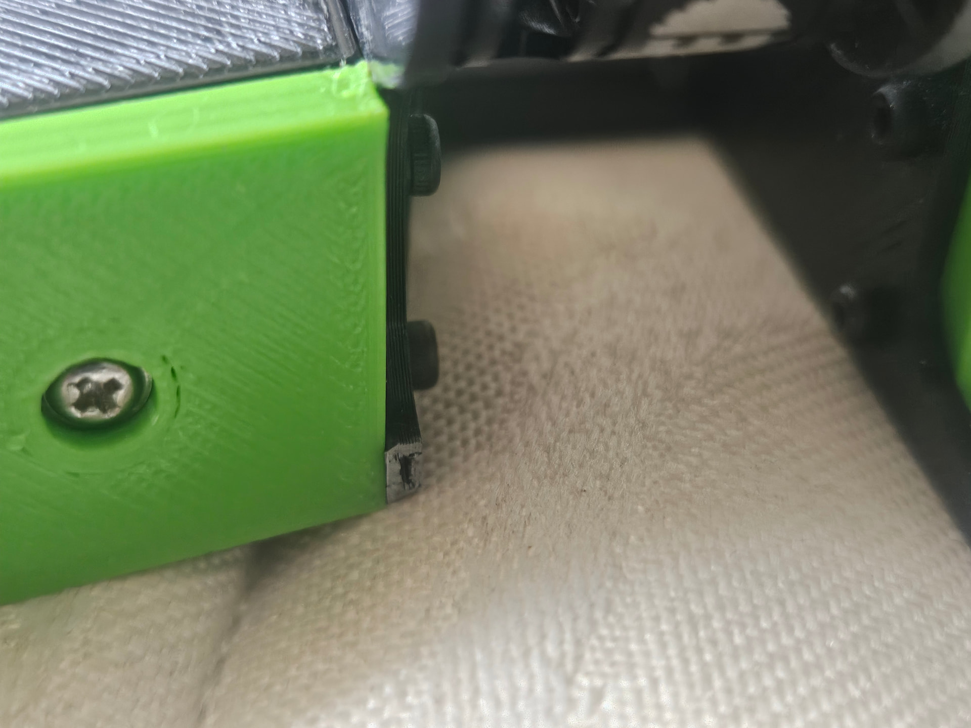

Below you can see some of the damage to Somatic Damage, as well as some pen markings on the body and Spinner courtesy of Sharpie McUnicornface :stuck_out_tongue:

The weapon supports for this event were 2mm thick ABS printed on 20% infill, which I worried would be wau to thin and was bound to snap at some point, especially the forks which had snapped immediately at the event before.
And the body of the bot had quite a lot of flex in it aswell, which I’m pretty sure ended up impeding the drive to an extent, as Somatic Damage seemed to veer to one side quite frequently in testing ajd in combat… Nonetheless, I still managed to drive this robot quite well!!!

And immediately I got that hit on his belt, taking it right off, however that came at a price as said belt was jammed quite deeply into my blade, stopping it from spinning… For a while we were locked together and I was shoving him around from the side, just trying to keep aggressive in the moment, but eventually we were finally freed and I was able to keep circling and pushing. However, in an attempt to push him out of the arena I spun around, one wheel out and one wheel in, and fell out the arena myself… This will become a common theme for Somatic Damage throughout this stage of the tournament.

I got some nice hits in on the back, and made some nice gashes too (pictured below, two of those gouges are mine but unsure which), unfortunately I wouldn’t really get to put Cat Flap through the vigorous materials testing that I had planned, maybe next time…
